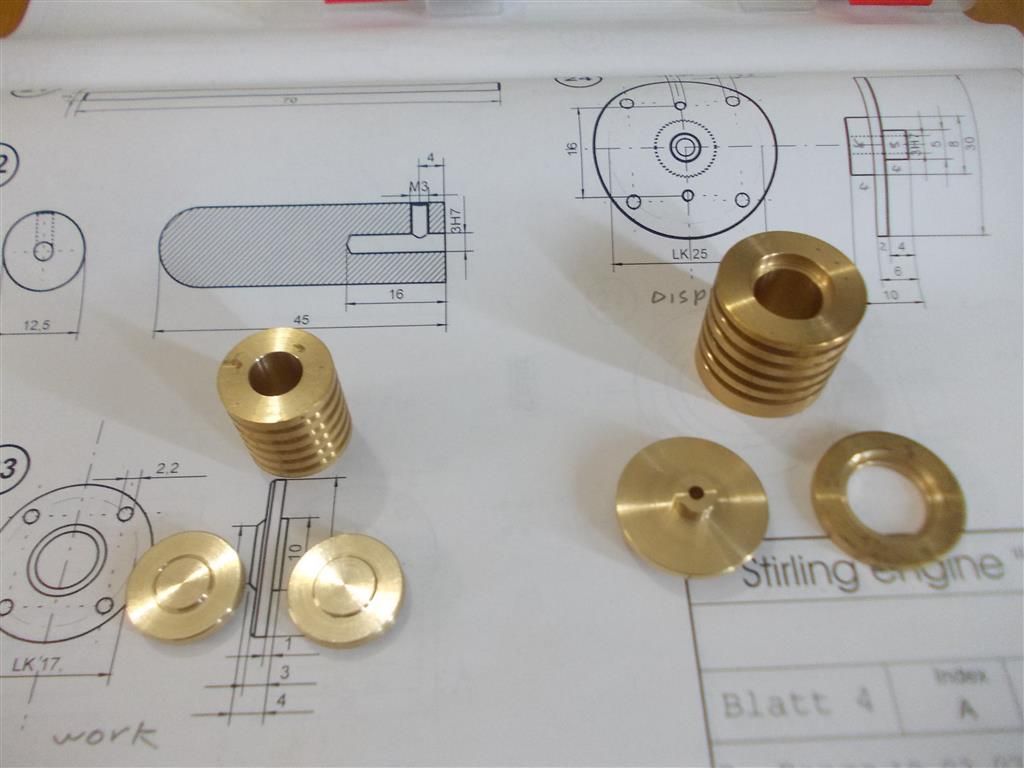

                                                I made the cylinder covers for the work and displacement cylinders today. I made two for the work cylinder because things were going so well !

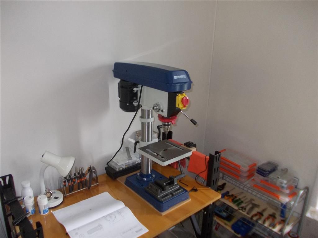

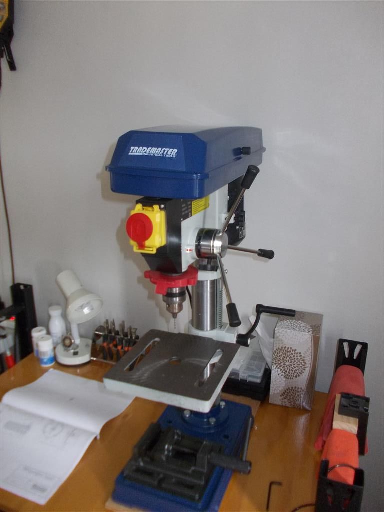

                                                I also treated myself to a new Trademaster bench drill. It was the display model and the last one they had so I thought I had better grab it now. The improved quality over my last bench drill is obvious. When I turn it on the drill bit does not wobble all over the place : a 1.5mm drill bit will actually drill a 1.5mm hole unlike the last machine.
                                                At some stage I am going to have to cut the glass test tube to size. What is your favourite way of cutting glass tubing ? I was think of doing it in the lathe with a triangular file.
