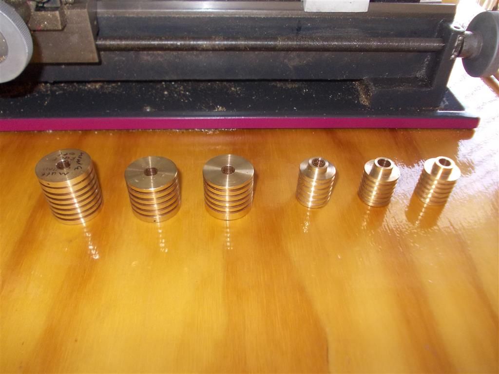

            I have cut three small and three large cylinders ; I needed practise making recess cuts. It is much easier once the carriage is locked down. All cylinders are drilled out to 8mm waiting for the boring bar to arrive.
            Which will give the most accurate results for the smaller cylinder : drilling out to 9.8mm and finishing with a 10H7 reamer or drilling out to 8mm and finishing with the boring bar ? Or should I always finish with the reamer even when using a boring bar ?

            #213879
            Hopper
              @hopper
              The best way, for accuracy and finish, is to drill first to "rough" it out, then bore the hole to ensure concentric location, then ream for fine finish and accurate size. Also, you should take a finish facing cut over the end of the cylinder that is going to mount to the crankcase/frame while the job is still set up from the boring and reaming. This ensures the finished hole is dead square to the mounting surface.
              You can however get away with drilling and reaming if accuracy is not super important. I would drill, bore and ream in this instance. Stirling engines are critical on friction, and low friction needs good alignment and smooth finishes all over.
              Edited By Hopper on 24/11/2015 07:06:03
              #213888
              Brian John
                @brianjohn93961
                Okay, I think I will need a 14H7 reamer for the larger cylinder then.
                Friction : it would seem that the fit of the piston in the cylinder is more critical in the Stirling engine then a steam engine. The Stirling engine must turn VERY freely but still have a good seal.

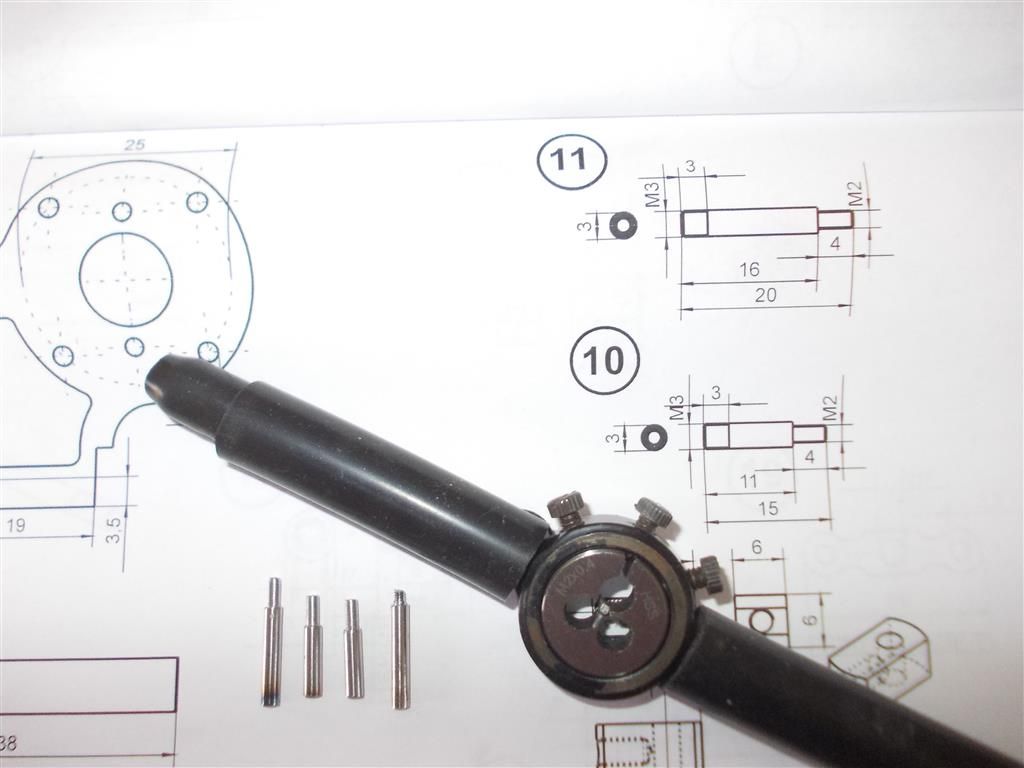

                                I had some problems today when attempting to make parts 10 and 11 which involved cutting a 2mm thread on the end. The threaded piece broke off inside the die. Is there any way to remove it from the die without damaging the die ?
                                #214022
                                  If you are lucky you can get a junior hacksaw blade into the slot and cut most of teh rod away then bend it into itself and remove. Don't overcut and run the saw against the teeth of the die.
                                  Whats the metal, just wonder if the heat from your dremel cutting discs has had an effect.
                                  Use your tapping fluid, open the die right out and wind the die back regularly to break off the burr eg every half turn.
                                  #214023
                                  Brian John
                                    @brianjohn93961
                                    The material is silver steel. It is the smallest thread I have ever tried to cut so I will have to be more careful.
                                    #214046
                                    pgk pgk
                                      @pgkpgk17461
                                      I've not had ocassion to do this (yet) but if that's a split die then can't you just take it out of the holder, tap a screwdriver blade gently into the split to open it up and lever/drift the dross out?
                                      #214054

                                            Hopper
                                              @hopper
                                              A couple of things to make using a die easier:
                                              Turn the diameter of the bar down to 3 or 5 hundredths of a mm smaller than the nominal 2mm.
                                              Turn a good chamfer on the end of the bar to help the die get centred and get started.
                                              Make sure you use the end of the die that has the gently tapered teeth as the leading end so the first teeth cut only a shallow thread, the next teeth a bit more, and so on.
                                              Turn the die about half a turn forward then about quarter of a turn backwards. You will feel the chips break off and the die move more freely. This helps break up the swarf and lets it drop out instead of jamming up the die.
                                              Use some kind of lube, tapping fluid, oil, WD40 etc.
                                              Keep checking the side view to make sure you keep the die and die stock level in all directions as you progress. Or hold the job in the lathe and use the tailstock to hold the diestock square. But still use the half a turn forward, quarter of a turn back routine.
                                              #214170
                                              Hopper
                                                @hopper
                                                PS, maybe grind a junior hacksaw down narrow enough to fit in the die and cut that piece out.
                                                Or put the die in the lathe chuck and very carefully centre drill and drill out the broken piece with a drill smaller than the inside diameter of the die. .
                                                #214172
                                                Trevorh
                                                  @trevorh
                                                  Brian,
                                                  all you need to do is back off the 2 outside screws on the holder and screw in the middle one to its fullest then using a pin punch knock the remains of the screw out
                                                  it wont damage anything and no need to buy a new die
                                                  Make sure its supported underneath when you drift it out
                                                  done it plenty of times myself
                                                  Trevor
                                                  #214175
                                                  Ajohnw
                                                    @ajohnw51620
                                                    Trevor's idea may work Brian if the holder is slightly over size but usually they are bang on size so the die wont expand at all. Often it's possible to remove the handles from the die stock and machine them out a little. I'd suggest to 0.010" over the size of the die. Too much and there is risk of the die cracking when it's forced open with the centre screw. That's 0.25mm or a touch more.
                                                    I was once told that prior to WWII die stocks always came slightly over sized but after that they suddenly all came on size. That's been true of all of the ones I have bought.
                                                    A digital calliper is good enough for measuring the the sort of tolerance that is needed. The figure i mentioned should be ok with 1" / 25mm dies. Larger sizes could take bit more and so on.
                                                    #214176
                                                    Trevorh
                                                      @trevorh
                                                      Hi John
                                                      The reason I mentioned the above method was due to the photo he has showing that its a split die which means the holder will have sufficient room to be expanded otherwise the 3 screws would be redundant
                                                      cheers
