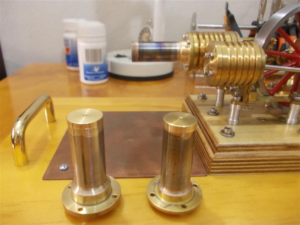

      Brian, I think you would be pushing your luck a bit there, drilling 15 mm OD tube to 13 mm. Ian S C
      #243664
      Brian John
        @brianjohn93961
        Today I called the manufacturer of the thin walled tubing and they assured me that it is genuine stainless steel. I cannot get the thick walled stainless steel to run for more than 7 minutes. It is much better quality (marine grade) but it just will not work. The thin walled tubing will run for the full 20 minutes of the meths burner. So I have rebuilt the second engine with a thin walled hot cap today and it runs well. The brass cap on the end of the tube fits over the end rather then inside the tube as on the other engine. This gives a neater appearance and is easier to make.
        Time to call it quits on this one now. But I am puzzled why it does not run well with the thick walled tubing…any opinions ?

          Posted by Brian John on 21/06/2016 10:11:59:
          …But I am puzzled why it does not run well with the thick walled tubing…any opinions ?
          Simple, the thicker wall conducts more heat down the length of the displacer cylinder to the cool end, so the temperature differential between hot and cool ends is less. It is this differential that make a Stirling engine work. The hotter the hot end, the more the air expands when displaced into the hot end. The cooler the cool end, the more the air contracts when displaced to the cool end. Hence, higher temperature and therefore higher system pressure at one end of the cycle, and lower temperature and lower pressure at the other = more work done on the work piston.

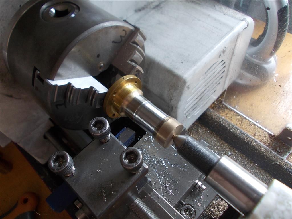

              With the thick tube you can cure the problem with a bit of lathe work. Hold the hot cap in the lathe chuck by the hot end(closed end), and tur a bit from abut 1/3rd from the closed end for about a 1/3rd to about half the thickness, this thin bit works as a thermal dam, slowing the heat transfer, and is what I should have done on my larger BETA motor, I instead thinned the area at the end that is in direct contact with the flame, that area has now distorted, and at some speeds rubs on the displacer. Ian S Ctest 005 (640x480).jpg
              #243822
              Brian John
                @brianjohn93961
                Thanks Ian, I have been thinking of thinning the whole length but, as you have pointed out, that may not be necessary. So you think only 1/3 of the length needs to be turned down….1/2 might be better ?
                I have drilled a small shallow centre hole in the end cap before soldering everything together (I always do this now). So I can mount the collar in the chuck and use a dead centre to support the closed end while turning with a LH tool.

                  I have reduced the diameter over about 1/2 of the length : from 15.7mm down to 15.2mm. It was no problem to do this as I put a small centre hole in the end of each hot cap I make before I solder it onto the tube. I was surprised at what a good finish I got on the stainless steel (0.1mm cuts). This was not even on auto feed. I wish I could get such a good finish on brass !
                  NOTE : I have not tried it out yet.
                  #243909
                  Brian John
                    @brianjohn93961
                    Ian : This has been very successful. The engine ran for the full 20 minutes of the meths burner ; I am surprised at the difference. Tomorrow I will reduce the diameter along the whole length of the cylinder. I am not sure why I didn't think of this myself…it is much easier then using a boring bar to reduce the wall thickness from the inside !
