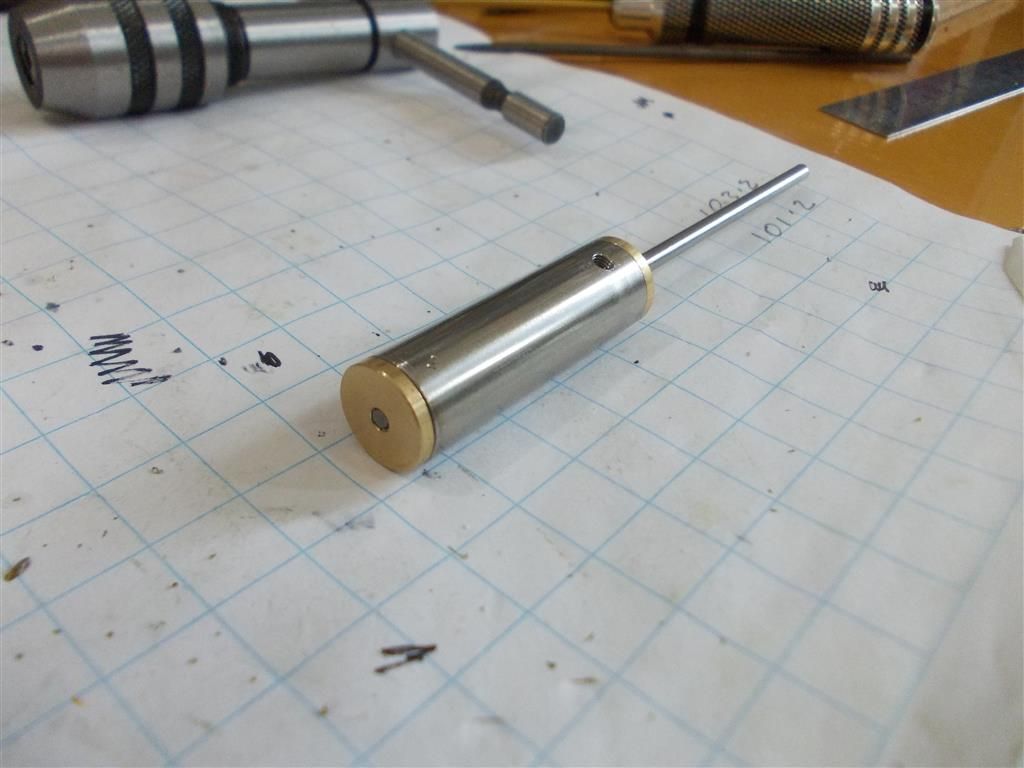

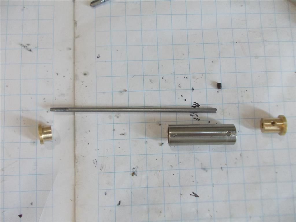

          I bought some exhaust manifold gasket material today but that idea went nowhere. How do you cut this stuff ! I hammered away it it with hole punch for 10 minutes and got nowhere. Even a sharp scalpel blade is useless. Anyway I gave up that idea and moved on to making a stainless steel D piston from the 12.8mm OD stainless steel tube.
          Initially I was going to make the two ends to the piston from brass and then silver solder them in place but then I had this idea (how many times do we hear that !). I have put an M3 thread in the'' hot'' end , the piston rod is threaded so that it screws into this after passing all the way through the brass fitting at the ''cold'' end. That brass bush is held in place with an M3 grub screw. Looks good but will it work…I will give it a go later tonight.
          The stainless steel is tough stuff and I comepletely destroyed my M2 spotting drill. Ideally the tube  would have a thinner wall : 1mm would be good but for now I have stuck with the original 2mm wall. I am not sure how this stuff would go with a boring bar. I might give that a go tomorrow if I make another piston. I was able to clean up the ends in the lathe with no problem so perhaps machining it is easier than drilling into it. Even tapping it was no problem with plenty of tap magic being used.

            There are all sorts of stainless steels Brian. When Ian uses a tube out of a nicad battery he will be using a ductile grade which will be more or less the same as a free machining grade. These are much easier to machine than the "true" stainless steels. It's pretty easy to tell the difference with a magnet. The easier to handle grades are slightly magnetic. Treated with a bit of respect you shouldn't have much trouble turning them.

              The case from the NiCad is just used "as is". I needed some tube for a job the other day, a bit of towel rail tube was the right size, I needed about an inch off it, so I decided to use the parting tool as it was all set up, went in about .010" and the shiney outer surface stopped while the rest kept turning, there was a chrome plated brass tube fitted over a steel tube. All is not always what it seems.

                      No luck with the stainless steel piston : very disappointing as I was sure that would work. It seems to get even hotter than the aluminium piston. I certainly burnt myself on it after taking it out ! So then I tried a new aluminium piston with the front edges slightly rounded and this did run for a full minute…but only once !

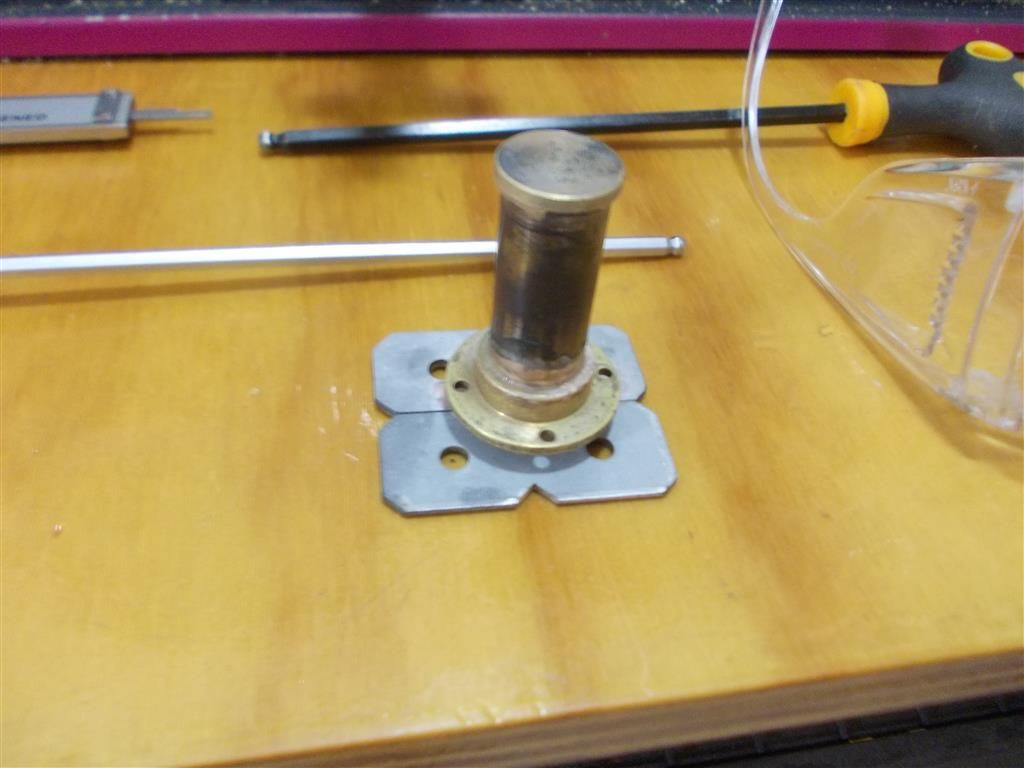

                        What was I thinking ? I spent the whole afternoon making up a stainless steel D cylinder but when I silver soldered it to the brass collar I had it resting on a couple of galvanised steel plates to keep it all level. I did not think the solder would take to the plates but it did ; I guess some of the flux dribbled through. If I had wanted  it to stick together then I bet it would not have ! Unless anybody has a good suggestion then this one will end up in the bin.

                          Just heat the galvo plates up and pull them off when the solder gives way. Wrap a wet rag, or a potato, around the body of the displacer cyl so the solder on the flange there does not get as hot as the solder on the galvo plates.

                            Yes, I was thinking about that while having dinner. I have not had much luck with remelting silver solder in the past but in this case I doubt that there is very much solder holding the plates to the work piece. It is worth a shot.
                            A potato ?

                              jamming whatever you want to keep cool into a potato is a classic trick for it to act as a heat sink. Of course a mangelwurzel, turnip, khol rabi or perhaps a parsnip would all show individuality in use

                                Whatever the reasoning, it did not work. I heated the plates up until they were red hot but they will not budge. Typical…just when you DO want the solder to fail !

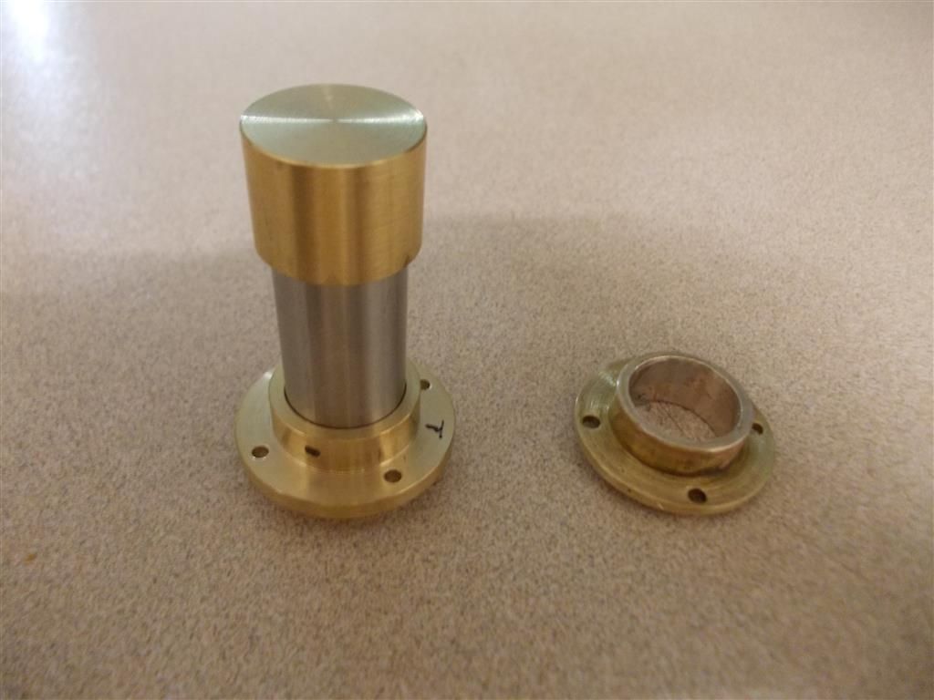

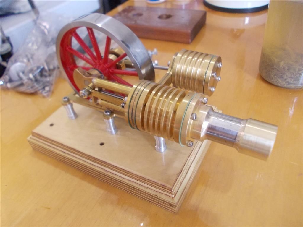

                                      I gave up trying to salavage that hot cap ; it was not made of real stainless steel anyway. Today I have made a new one from proper stainless steel purchased from the boat supply store as per Hopper's suggestion. The brass end cap is different design on this one. Nothing is soldered yet. I might even use JB WELD to see how it goes and if it does work then I can silver solder it later. I did manage to save the brass collar from the old hot cap ; that may be useful in the future. I bored it out using the boring bar.
                                      #239295
                                      Brian John
                                        @brianjohn93961
                                        The new hot cap has been soldered up today. I was careful to give the bottom a light coating of machine oil so that nothing would stick if the solder did flow all the way through ; I also coated the jaws of the vice with oil. But I judged the amount of solder correctly this time so there was no problem. It certainly looks the part but does it work ? I have to go out now and I will give it a try later.
                                        I did have some problems fitting the collar to the D cylinder after soldering and I had to polish the collar with some 400 grit in the lathe to get it to fit. What happened there ? It was an easy (not tight ) fit before soldering.

                                            It will not run ! I really thought it would this time but I was closer last week with the ''fake'' stainless steel tube. The real stainless steel tube is not working for me. I have no friction… I have a sealed system (I can feel the suction) …but I do not have a functioning Stirling engine. I am now out of ideas.
                                            I might put this aside for a few weeks and get on with the flame eater engine. The face plate and clamps are ready to machine the flywheels.
                                            Edited By Brian John on 19/05/2016 15:25:43

                                              You may have to heat it a wee bit longer to get the heat into the motor, the hot end looks quite thick, it might take a minute or two. Don’t worry. it will go,you just have to sware at these things the right way.

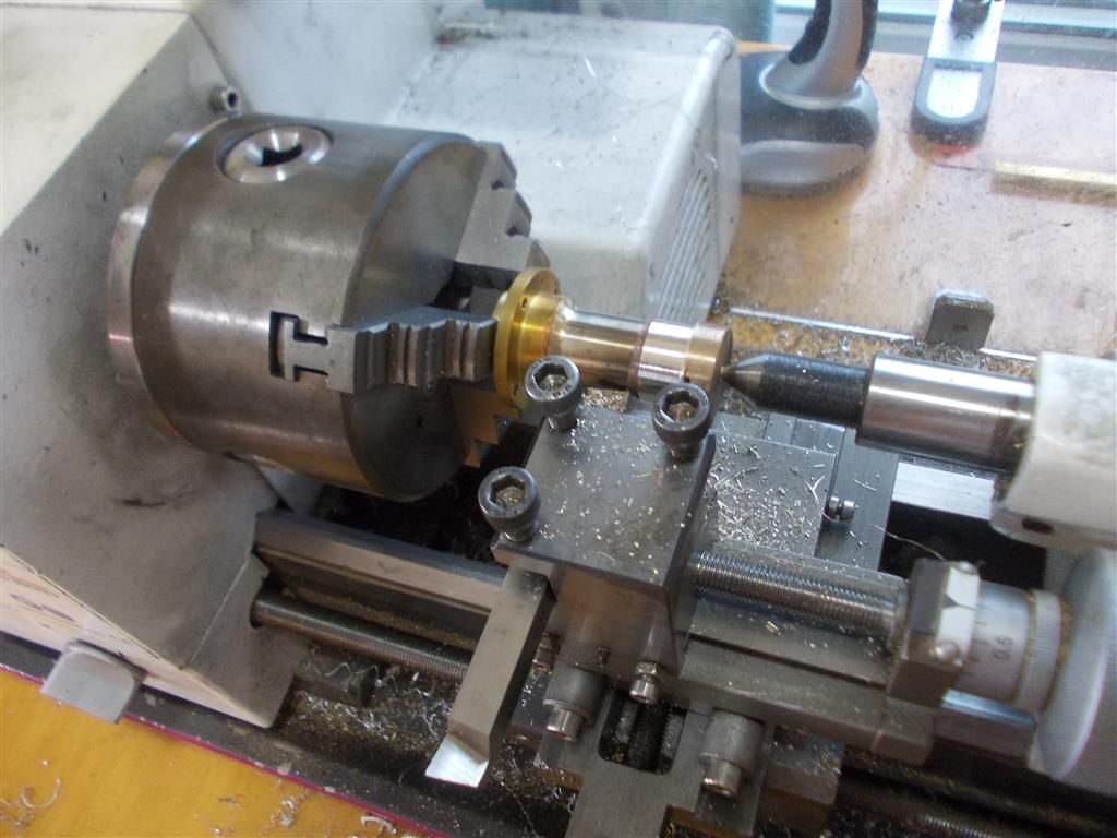

                                                I would try taking that brass sleeve off the hot end of the displacer cylinder. Brass is an excellent conductor of heat, so it is doing a good job of transferring heat from the flame on the end of the cylinder halfway up the length of the cylinider, which defeats the object of using a stainless cylinder to minimize heat conduction. You might try instead a short brass cap that basically covers the end of the cylinder and extends only , say, 6mm down the cylinder. This will hold the heat at the very end of the cylinder rahter than spreading it along toward the cool end.
                                                Also the brass flange on the displacer cylinder is going to absorb a lot of heat and then allow it to flow back into the air right there next to the cool end. But a stainless flange might be a bit tough to machine on your little lathe. However, even a mild steel flange will have more suitable thermal properties for this application than brass..

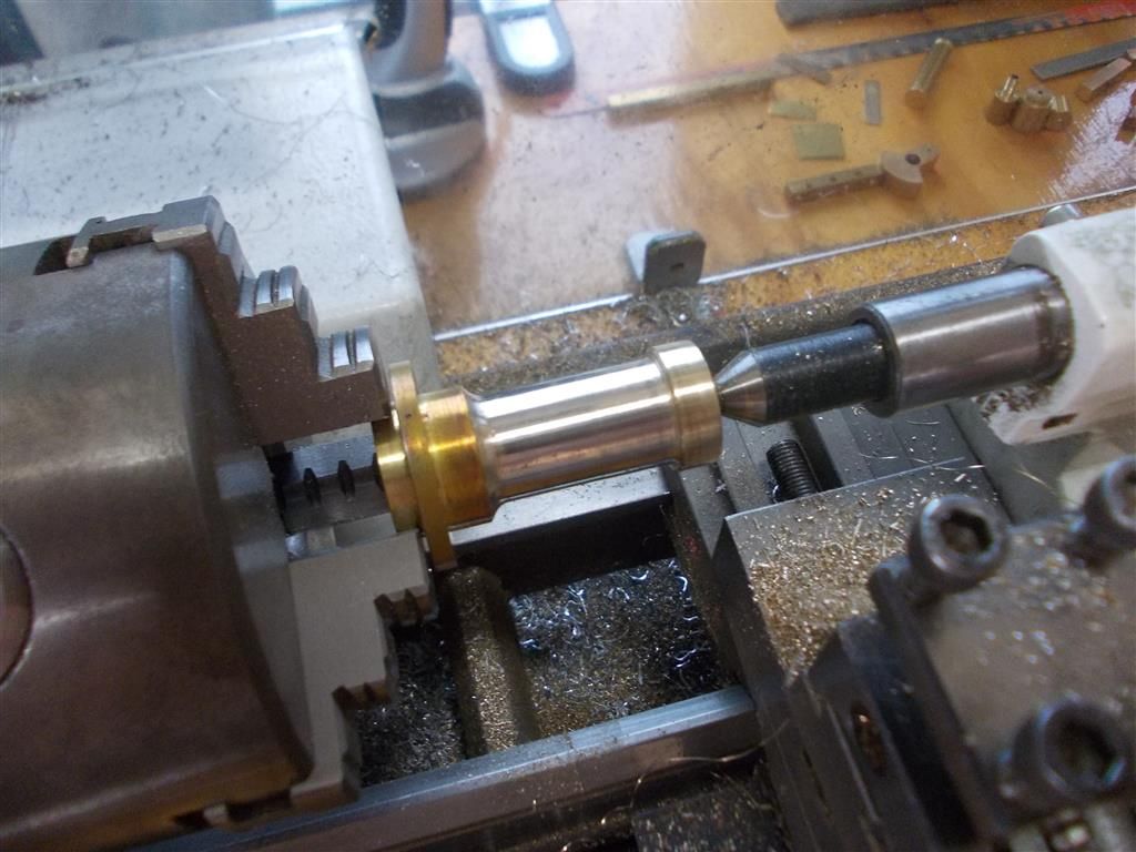

                                                  I might be able to mount the collar in the lathe chuck, drill a shallow centre hole in the cap so that I can turn between centres and then using a LH cutting tool reduce the brass cap that way. I will have a look at that tomorrow. I knew I should have used JB WELD on the collar : it was only a last minute decision to solder it !
                                                  I do not think I could make a mild steel collar on this lathe. Turning it would not be a problem but drilling and parting off would be out of the question. I struggle doing this with 30mm diameter brass.

                                                      I reduced the cap down to 6mm as per Hopper's suggestion. I will try it out later. Photo 1 shows it being cut with the LH cutting tool and photo 2 is after polishing
                                                      I did not get time to try drilling the exhaust gasket today. I want to use the exhaust gasket to prevent heat transfer to the D cylinder…or at least slow it down a bit.
