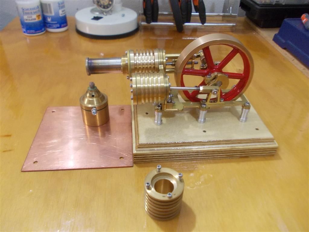

                              I have been without the internet all day until now so forgive the late reply (thank you Telstra!).
                              Much mucking about today with still no success. I have read all the above just now and there is a good chance that this engine will never work as it conducts too much heat from one side to the other too quickly. However, if the glass tube version will run for well over 20 minutes then this version should at least run for 5 minutes…would you agree ? Also, I have put gaskets between the hot cap and the D. cylinder and the cylinder holders to slow down the heat transfer.
                              I have tried to keep all dimensions the same as the original glass version but I had to go with the stainless steel tube from Bunnings as the hot cap so things had to be modified slightly to accommodate this. See above for D. piston dimensions. Other than that everything is the same.
                              I have just realised that I did not enlarge the D. cylinder by an extra 1.6mm to allow for the larger piston diameter. I will do that tomorrow. That is plan A.
                              Ian : no the piston is not rubbing against the hot cap ; I am sure I would feel that. It is also a good close fit to the end of the hot cap. I may knock another 0.1mm of the diameter of the piston if nothing else works. That is plan B.
                              Plan C is to make the D. piston out of something other than aluminium.
                              NOTE ; the inside of the stainless steel tube is brown after all the heat today…almost like rust ! I am starting to suspect that it may not be stainless steel after all even though it was labelled as such. Perhaps stainless on the outside and something else inside ? It was stainless steel tubing from the laundry section of the hardware store.

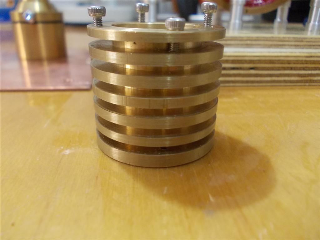

                                Well, no wonder it would not run ! I set up the D. cylinder in the lathe chuck in preparation for boring as per above plan A and that is when I saw a fine hairline crack at the base of one of the cooling fins …where it meets the recess to take the hot cap. The original plans call for 5mm deep cooling fins but I did not modify that and I should have. The recess to take the hot cap went almost all the way through…but not quite, hence the very fine hairline crack which I had not seen until now. The crack is too small to show up using my camera. I did think of repairing it using silver solder but I am not sure that would work very well.
                                I am in the process of making another D. cylinder but this time the cooling fins are only 3mm deep so there is plenty of brass left to make the recess for the hot cap. It is almost done ; I just have to drill and tap for the M2 screws now.
                                I might buy some high temp gasket material for the hot cap. I don't think what I am using now is high temp material. I think that would make a big difference.
                                What grade of stainless steel could I machine a D. piston out of ? The chances of finding some stainless steel tube of the correct diameter and making it from that are pretty slim.

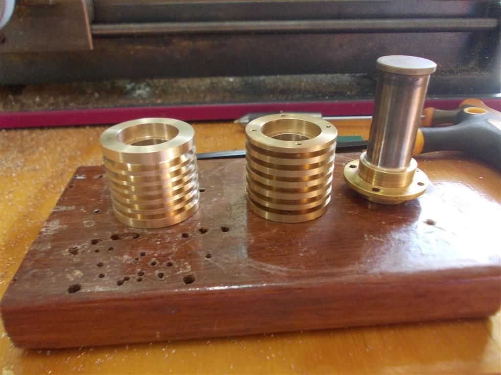

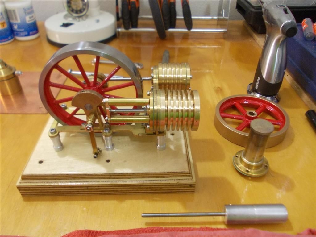

                                    I made another D. cylinder but still no luck. I feel I am close : it wants to run. Spinning it in the wrong direction when heat is applied and it will only turn about 4 revolutions but spinning it in the correct direction and it will spin for about 20 revolutions. It must be close to running !
                                    I also replaced my slightly wobbly cast iron flywheel with a similar size brass flywheel from PM Research. Tomorrow I will reduce the D. piston by 0.1mm.
                                    The second photo shows the old D. cylinder. I am going to try to save it…..no reason ! I have drilled and tapped through to the second cooling fin ; the M2 screw will hold it in the correct position. I will run a fillet of silver solder around the inside edge of the cooling fin where it has opened up. I will apply a drop of oil to the M2 screws to keep the solder out of the tapped holes.
