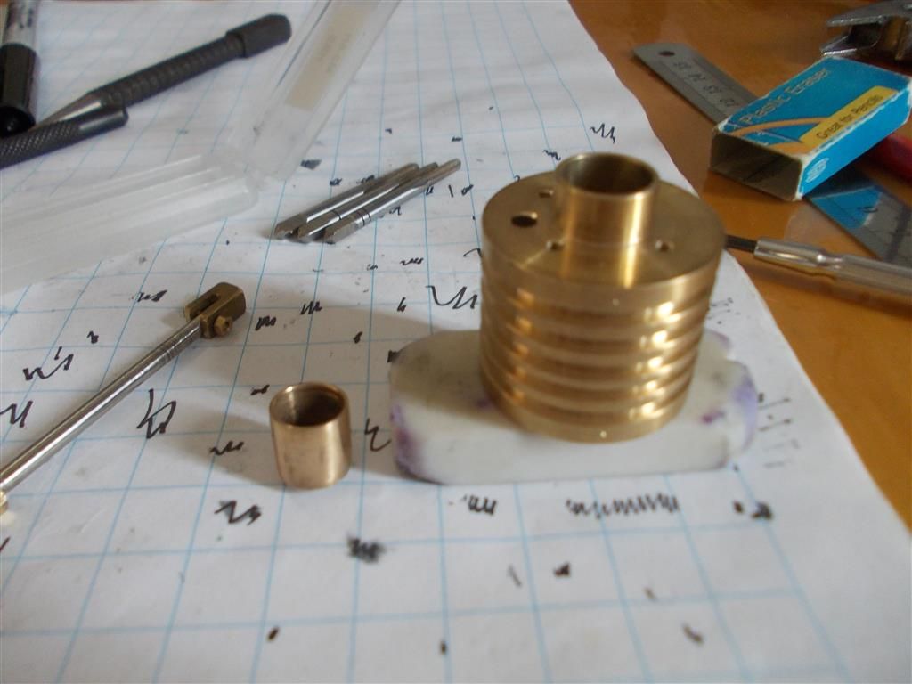

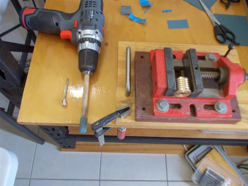

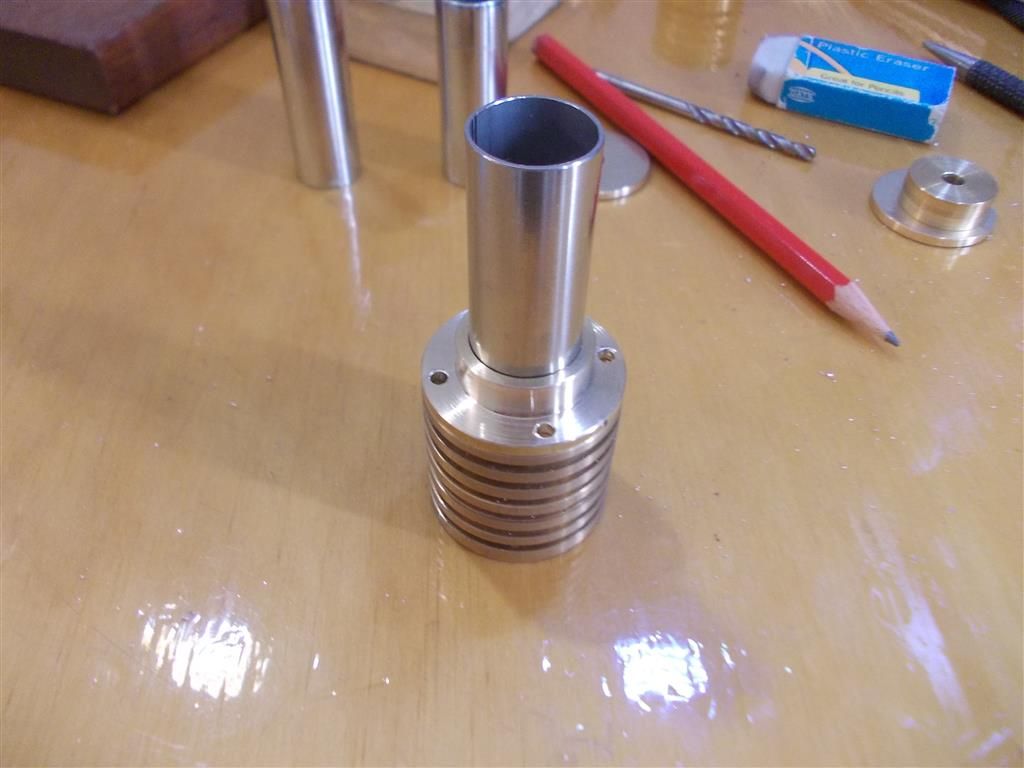

                I made the collar for the hot cap today. As usual I made life difficult for my self by drilling and tapping the D. cylinder first. I should have drilled the holes in the collar first but I always forget to do that ! Anyway, it all worked out in the end so now all I need to do is make the brass end cap. I am still thinking about the best shape for that.
                Silver soldering stainless steel :
                1. I now have the correct flux. How is the flux removed once the job is done ? It says to use a hot caustic soda dip. The bleach I have in the bathroom is 4g/L Sodium Hydroxide (NAOH) ; would this do the job ?
                There is also the option of a wire brush and hot water to clean the flux….. perhaps that might be safer.
                2. Should the stainless steel be roughened up with sandpaper or a wire brush prior to applying the flux ?

                #233752
                  You can use the same acid you have used on your silver soldered joints before but it takes longer, I find patio cleaner shifts HT5 very well so have not tried caustic soda. Either way a small wire brush will help.
                  Yes wirebrush the surface to clean it does not need to be rough.

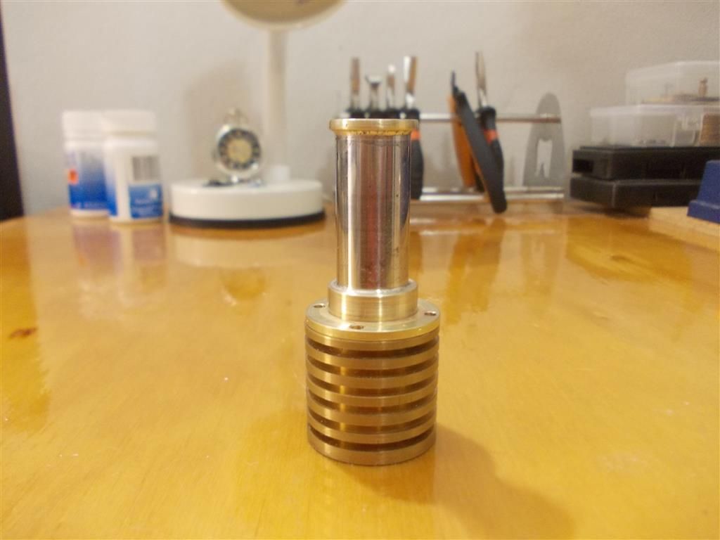

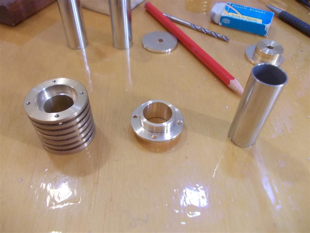

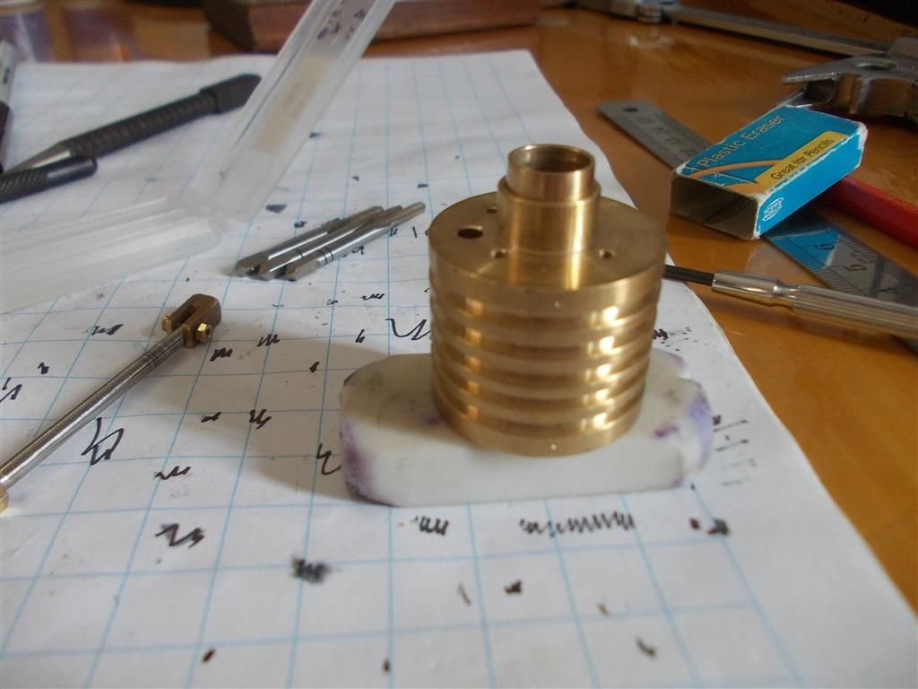

                      I think the end cap will go inside the tube about 2mm. I will make the end cap about 3mm larger in diameter than the tube so that I have a bit of a ''lip'' to solder it to. I am still thinking about it all.
                      I drilled and tapped for four holes because I am using the pre-drilled cylinder holders as a template for the position of the holes. So much easier to drill the holes in the collar first but I always forget to do this !

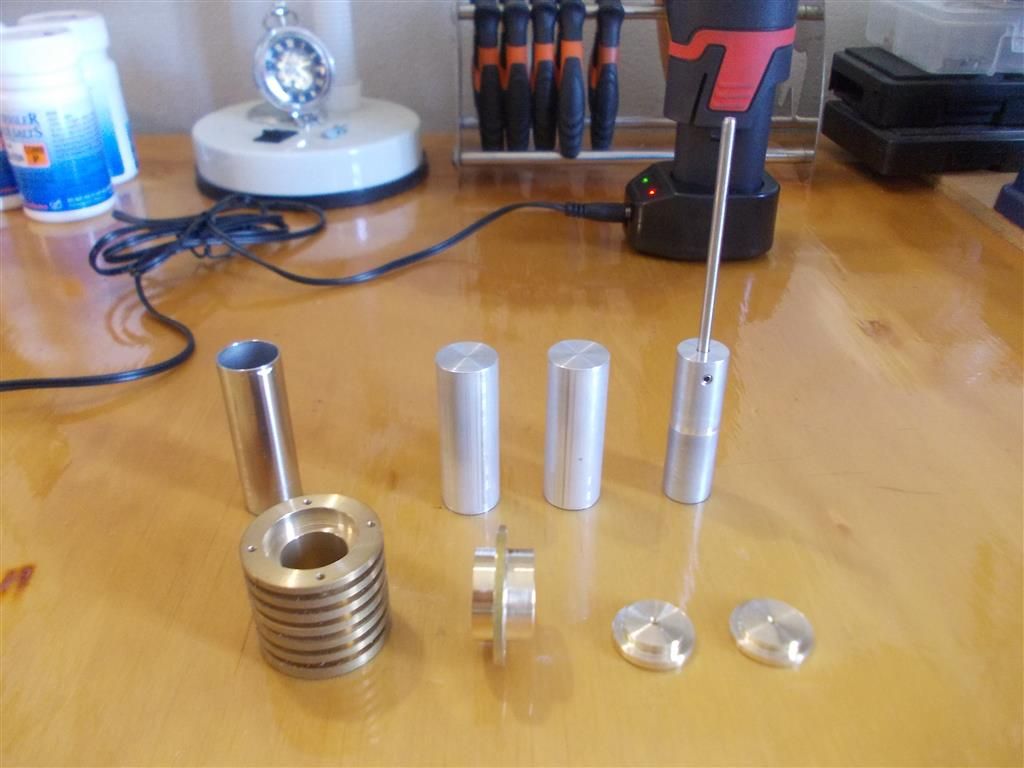

                        I machined two end caps today in case the soldering does not go as planned. I have also made one D. piston ; I will probably make a few more of various diameters to see which one works the best. I think my gas cylinder is less than half full so I need to buy some more gas before silver soldering everything together….hopefully tomorrow, weather permitting.
                        What about piston shape ? I am not using a glass tube so the D. piston does not have to be bullet shaped with a rounded nose but is a simple cylindrical shape the best for a Stirling engine ?

                        #233872
                        Ian S C
                          @iansc
                          I'v never used anything but a flat ended cylinder for a displacer. It looks as though you are making the displacer the same way as the original one, just minus the domed end. What is the bore of the hot cap?

                            The ID of the stainless steel tube is 14.5mm.
                            The original displacer had a round end glass tube held in position with  an O ring. It was a truncated test tube which does have a habit of blowing off sometimes.

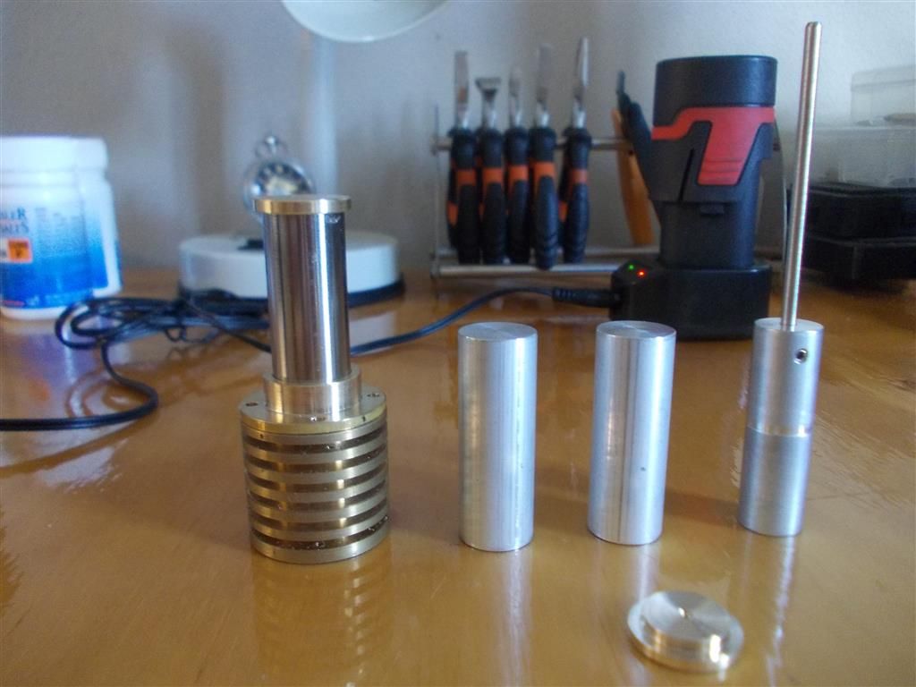

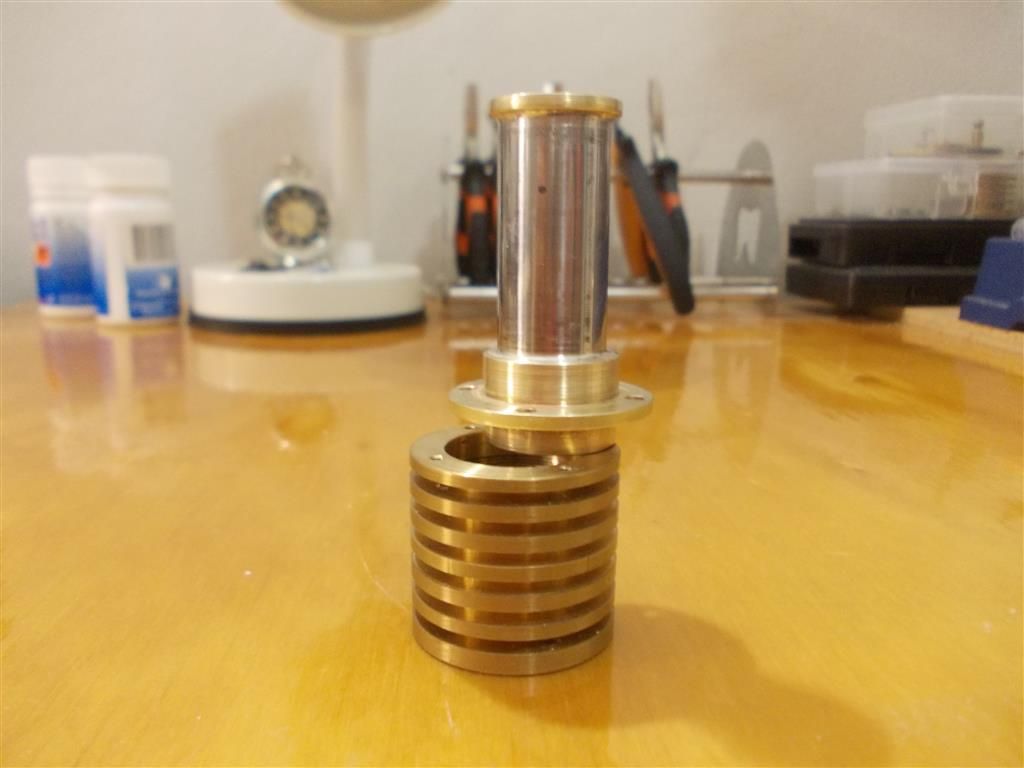

                              The stainless steel silver soldering was successful. The flux is not a thick paste like the 602 flux used for copper and brass ; it is more liquid but it does the job. I made a bit of a mess by using too much solder and I had to use the boring bar to clean up the excess inside the tube. I washed the flux off with hot water and a wire brush then I put it in a NAOH 4g/l solution for an hour as per the instructions. Then it went into the citric acid for another two hours to try to clean it all up and get it shiny. The brass came up nice and clean but the stainless steel was still black after the soldering so I had to polish it up in the lathe using 1500 grit.
                              Is there a quicker way to clean stainless steel after soldering ?

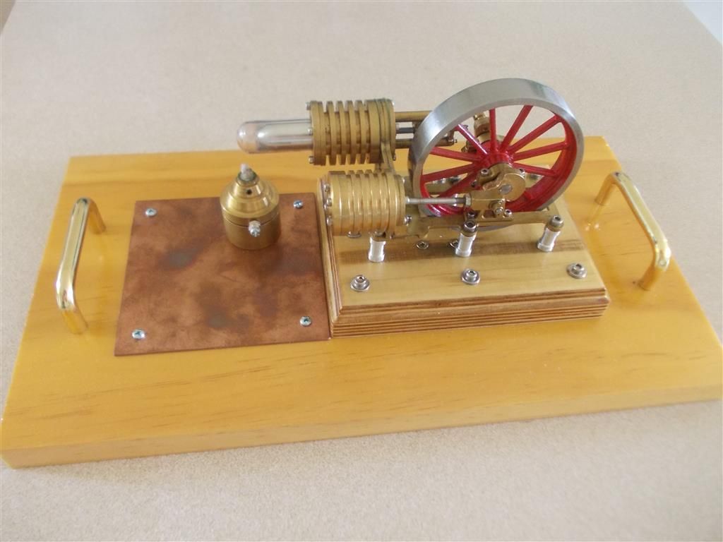

                                              Photo 1 is the finished product for Stirling engine #1, now finally mounted on its base.
                                              Photo 2 is my home made brake hone for the power cylinder of engine #2. I used 1500 grit : it gave a nice smooth finish to the bore but I cannot say the cylinder to piston fit is any better. The bore is 10mm and the wooden dowel for the brake hone is 9.5mm. This gave a nice tight fit when the 1500 grit was inserted in the slot of the dowel and wrapped around it once. I may have been better off to put the hone in the tailstock chuck and the cylinder in the lathe chuck ; I may try that next time.
