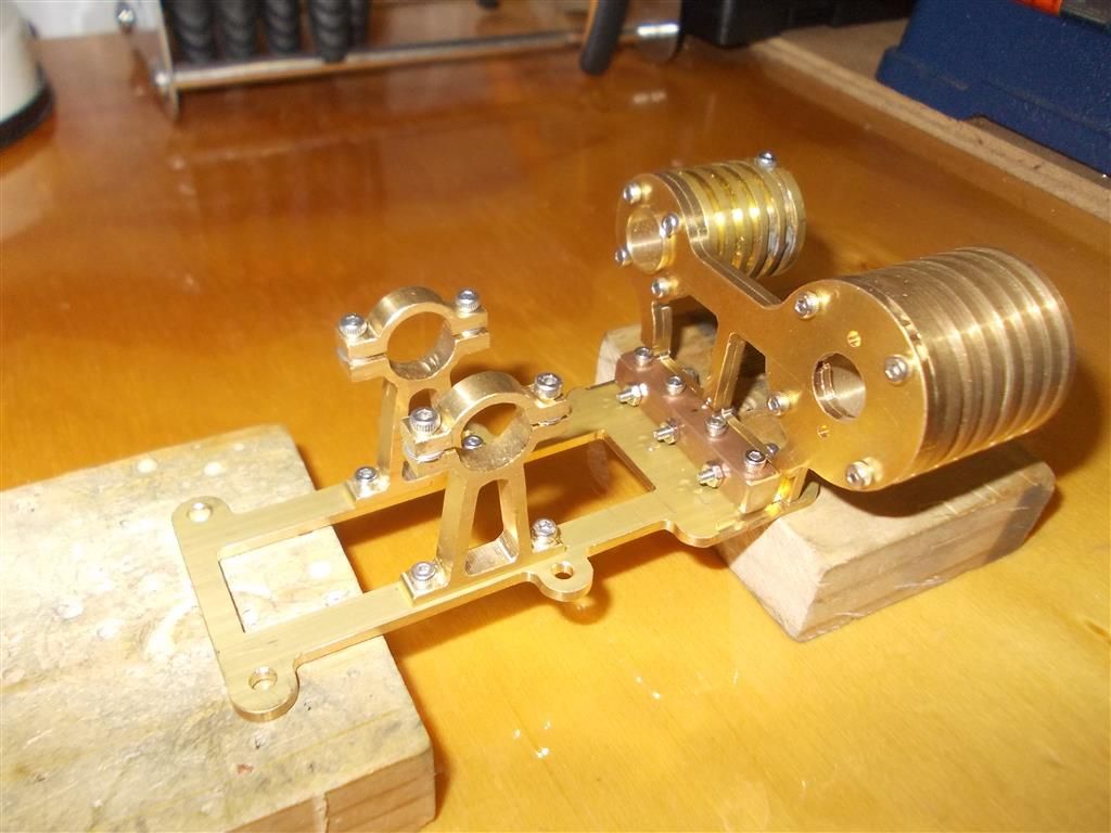

                    I remember now what happened the last time I heated a sheet of brass and it was not a good result ; it warped in many different places. So today I put the bent plate in a vice and gave it a few good taps with the hammer ; pushing it by hand was not helping. That seems to have done the job. Because I am not soldering the cylinder holders to the base plate as per the instructions but bolting the parts together using a 1/4'' square brass bar then this also helps to keep everything flat and even.
                    In engineering terms, what do you call that 1/4'' brass bar with all the M2 bolts passing through it which connects the cylinder holders to the base plate ?

                    #233256
                      "Cleat" would probably be the best term to use. On larger steel structures it would be in the form of a piece of angle iron rather than the square that you have used

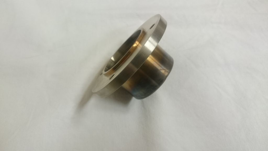

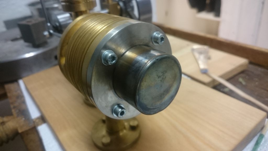

                        Hi Brian
                        I have followed your thread form time to time and I enjoy it very much.
                        Here is some pic of the hot cap of my Stirling engine.
                        It is made of stainless steal and was fabricated out of three separated pieces that were Tig-welded together (my father did the welding).
                        The wall thickness of the tube is 1.5 mm (you can probably decrease it to 1 mm)
                        The hot cap is then bolted directly to the Displacer cylinder without any gasket but the Stirling engine still works well, it runs for about 18 minutes.
                        hot cap
                        hot cap
                        Here is link to a video of the engine runing **LINK**
                        Anders

                          Thank you for the photos and link Anders. What you have built for your hot cap is what I have in mind to build for my engine although mine will be longer (same length as the glass tube). It was suggested to me that I use the stainless steel tubing that comes with the solar powered garden lights but I think this is far too thin. I have a piece of stainless steel tubing from Tonkin Steel but it has a 1.6mm thick wall ; I am thinking of reducing the thickness at the end down to about 1mm by putting it in the lathe. I only have to do this for the last 3cm where it makes contact with the flame. I should be able to do this in my lathe if I take it slow and just shave off a bit at a time.
                          Once that is done, the stainless steel tube will be fitted to a brass collar, similar to yours, using JB WELD. Then a brass cap will be fitted into the flame end, also using JB WELD. Because I am only using a metho burner, the JB WELD should be able to withstand the heat generated.
                          Anyway, that's the plan but we all know what happens to plans !

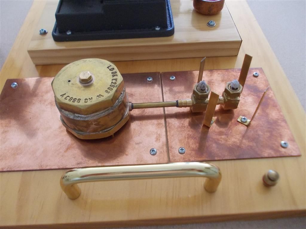

                              The metho burners I build for my steam engines out of plumbers brass end caps have the pipe work and the burner end joined with JB WELD. You can see the dark grey fillet at the joins. I would think if they can take the temperature of the fire box then it should be okay for the Stirling engine…maybe !
                              Is there some other way to do it ? I have heard that stainless steel can be silver soldered to brass using an aggressive flux. Any comments on that ?

                              #233421
                              Jeff Dayman
                                @jeffdayman43397
                                JB Weld is rated by its' manufacturers at 500 degrees F max working temperature. Check their website if you don't believe me.
                                Since firebox/burner temps may exceed that by a large margin I'd say building burners with it is risky. If a burner comes apart while lit the fuel could spill over a wide area possibly setting fire to anything in its' path.
                                I'd use silver solder rather than JB Weld. Just my $0.02 worth. JD

                                      JB WELD is rated for 287 degrees C. The link above is not the  product I used. When I first constructed my boilers I put some soft solder whose melting temperature is 180 degrees C on a piece of copper inside the firebox. It did not melt at all so I assumed that the temperature inside the firebox was less than the melting point of the solder hence less than the fail point of the JB WELD. Was my reasoning unsound ?
                                      http://www.jbweld.com/collections/epoxy-adhesives/products/j-b-weld-twin-tube
                                      I will admit that it may not hold up against a direct flame so, like Jason said, it might be worth testing first before using it to construct a hot cap for the Stirling engine.

                                                I did not use silver solder on the tubing for the metho burners because the high temperature required for silver soldering annealed the brass tubing and it was then too easily bent. At the time I did not have the correct flux for soft soldering and I was having problems getting the soft solder to adhere. The JB WELD I have used has been in use for many months now and shows no sign of failing. It is designed to withstand temperatures that would melt many soft solders !
                                                However, the concerns of all have been noted and the next time I build a metho burner I will have another look at using soft solder now that I have the correct flux for doing the job.
