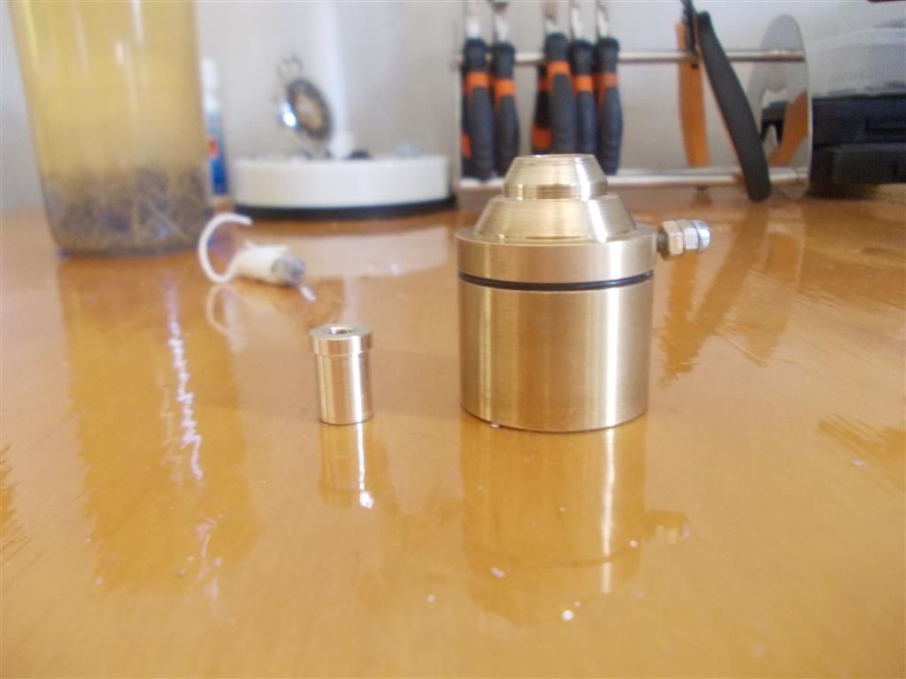

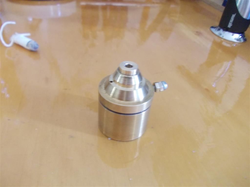

                                          #230667
                                          Brian John
                                            @brianjohn93961
                                            Improvement : I have made a brass sleeve to fit inside the 8mm burner hole. The hole is now 4mm as per the plans. It runs for much longer on one fill (15 minutes…previous was 10 minutes) and it runs a bit slower. I cannot tell that the D. cylinder is any cooler than before but I have no way to check this other than to touch it !
                                            I will drill and tap the cone to take a 3mm grub screw to hold the sleeve in place. I could use solder or JB Weld but the grub screw is easier if I need to make further changes.

                                            #230727
                                            Ian S C
                                              @iansc
                                              Over the time of running the temperature will stay about the same, by reducing the size of the flame, you have reduced the heat in put to the motor. The motor will take longer to heat up, but it's one of the experiments that I try, to see how little heat will still run the motor.

                                                Pardon me being cynical, but isn't it amazing that on returning to drawing specifications things improve ?
                                                #230829
                                                Ian S C
                                                  @iansc
                                                  I think Brian's actually got a good burner there, he can change wick sizes at will, it would be worth trying 3 mm now, he might get near half an hour running on that.
                                                  Ian S C
                                                  #230845
                                                  Brian John
                                                    @brianjohn93961
                                                    I have noticed that as soon as it starts to run out of meths and the flame gets a bit smaller than the engine slows down. I think the current 4mm burner is the minimum for this size engine.
                                                    I do like the changeable wick holders as I can use different size wicks for other things without having to make a whole new burner.
