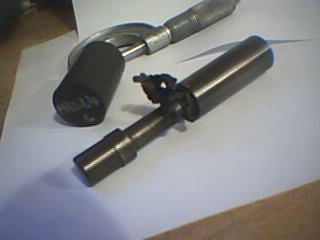

                  Brian, once you get the motor going, leave the bore alone, and you will find that after an hour or two running the speed will increase, well that's what I find. My second engine showed that, I decided to run it until it wore out, it was run with a generator on it with an incandescent light rated at 3v and that got slowly brighter, after a day or so that one popped, so up to 6v and by the end of the week that one went too, so a 12v light is a good load. After 1000hrs the big end on the power piston was really worn (.020", so stop for a rebuild, it managed to cut the metal it's self with my mini power hacksaw. These things just get better as they go. This is the motor, it's not pretty, but it goes, and that is why I build them, and modify them.
                  Generally, after boring the cylinder in the lathe , I have a look, if there are machine marks I use a cylinder hone, then I get to work and lap the bore until the marks from honing disappear. For Stirling Engines I like the bore as smooth and shiny as possible.  The honing marks are left on with an IC motor, it helps the rings to bed in.

                                  For Teflon bushes, I make my own, at first I used to carve them out of a bit of carbon impregnated Teflon rod, that was ok, but lots of swarfe, I kept all of that. There was a bit in ME, late 1980s/early 90s about Teflon bushes. A mould is needed, this gets packed with the swarfe, and compressed, the mould is made from steel. Next heat the mould until its blue, allow to cool, push the contents out.
                                  The one in the photo is 1/2" bore, 5/8" OD for the displacer rod on a Ringbom motor (free displacer)3/8
