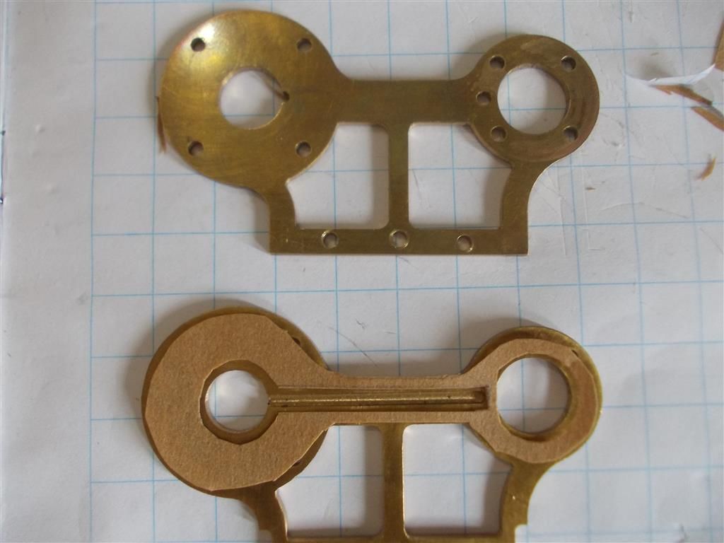

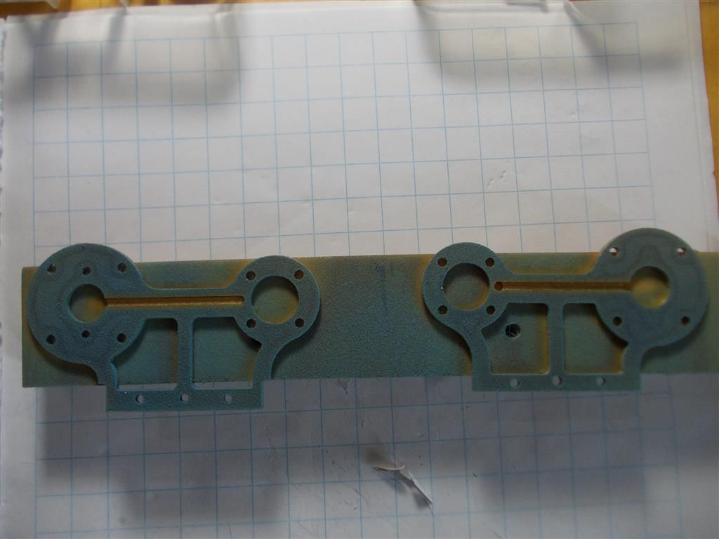

                I took the cylinder holders (frames) apart today intending to make a paper gasket for this part of the engine. It is a good thing that I never soldered all this together as per the instructions …what a mess that would have been !
                My first observation was that there was a lot of oil spread over the inside of both frames indicating air leaks in this area. My attempts at cutting a paper gasket were a complete disaster so I decided to try the Hylomar again. This time I laid some plastic tubing on the connecting groove to mask it off before spraying. All seemed to go well and I slowly put everything back together eventually achieving the same degree of freewheeling as I had before.
                It still does not work !
                1. Bengs should supply a precut gasket for the frames. This is a very important part of the setup and mucking around with various compounds, never knowing if it has worked or not as just not good enough.
                2. I could try cutting five paper gaskets for the cylinder covers and where the cylinders contact the frames but I am starting to feel that I am wasting my time.
                3. New bearings will not solve my problem. I spun the flywheel once both pistons had been disconnected and I was getting somewhere between 30 and 40 revolutions ; I doubt that I could do much better than this. What are other people getting ?
                4. I have failed ''Gasket Cutting 101'' !
                5. Can Hylomar be used immediately or should I have waited 24 hours ? It does not say on the tin ?

                #226407
                Howi
                  @howi
                  Brian you seem to be blaming Bengs again, YOU chose to deviate from Bengs instructions, you cannot now say it is their fault.
                  Making changes/not following instructions without the necessary experience/knowledge has led us to where we are.
                  My suggestion at this point would be to assemble everything as it should be.
                  Disconnect the work piston from the flywheel
                  Provide heat to the end of the glass displacer cylinder ( wait for 60 seconds at least to get some heat in) then slowly turn the flywheel over which should move the displacer piston as you turn the flywheel you should see the work piston moving in and out due to the action of the displacer. IF this does not happen then something is wrong somewhere. Either air not getting through or air leeks.

                            Posted by Brian John on 22/02/2016 09:42:36:
                            pgk : do you mean on the D. piston side ?
                            Whatever side that is .. the larger aperture/smaller diameter support side. I was wondering how the air(pressure) is supposed to route between those cylinders

                                Hylomar state let the solvent evaporate. When I've used it on cars that has happened by the time I get it on.
                                They do 3 grades. I assume light is the thinnest one. It can be brushed onto metal surfaces but the solvent evaporates pretty quickly in my experience.
                                A more watery semi setting variety maybe easier and better to use. Red Hermatite is one brand. A very thin coat which ever is used. These products are gasket lubricants not substitutes for them really. Red Hermatite less so.
                                Now the obvious things have been ruled out other than maybe distortion when it's bolted down I suspect you need to remake one or two parts. All those pillars aren't a good idea. Most likely the displacer con rod bearing and con rod and maybe the power piston after honing it's bore. The bearing will need an accurately set tailstock. One of the problems with making holes on a lathe is the fact that things tend to produce larger holes than their diameter so do try it on some scrap first. Tailstock misalignment generally makes the hole even bigger.

                                      PGK : larger aperture is the work piston. There is a hole in the end of the frame which connects to a hole which has been drilled down the side of the cylinder. This hole exits at the top and so connects the two cylinders. I am not sure if that is clear ?
                                      Tomorrow I will make paper gaskets for all cylinder covers. If that does not work then I will try an aluminium flywheel. I may also make another work piston/cylinder assembly but this will not be ''drop through''. I will keep as much compression as I can this time.
                                      I am not sure why soldering as per the instructions is any better than bolting the cylinder holders to the base ? True, my engine does not work but I cannot see this as the cause. The only other modification I have made is to make the work piston rod adjustable by cutting a thread on the end and installing two lock nuts. The original design called for this to be soldered to the connecting rod joint which would not have allowed any adjustment to the length. Again, why should this cause any problems ?
                                      I also used a small nut and bolt for the working piston joint instead of a rivet.
                                      NOTE from the instructions : '' After deburring, cleaning, and adapting the parts the base plate can be soldered softly.'' It does not really specify what is to be soldered.

                                        On jan ridders engine he recommends silicone for sealing .. simple clear builders silicone applied in a tiny amount to covers. I haven't tested for leaks as such but whenever i take the bits apart there's a nicely squashed very very thin even layer of the stuff there (which peels off easily). A lot easier than making sets of gaskets..any diy or builders merchants.

                                                  I have looked around the internet and settled on this silicone gasket material from Autobarn :
                                                  **LINK**
                                                  I will try this instead of paper gaskets.
