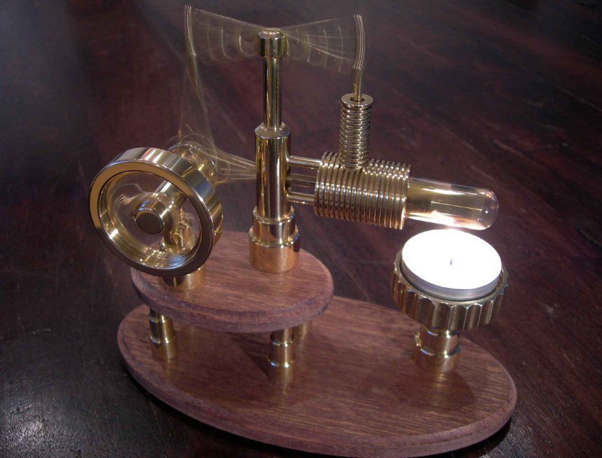

                                                I was playing with the little Bohm motor I got at Jaycar, before tea this evening, it wouldn't go, took the piston out, wiped the piston and bore with a bit of paper towel, put it together and away it went. The two fly wheels on it are about 40 mm diameter brass, and I think the motor would be better if they were at least 50 mm. A well designed motor will actually run (very fast) without a flywheel at all, the only difficulty is turning the motor enough to start it. In this state the motor has virtually no torque.
                                                Ian S C
                                                #226274

                                                    Here's the little Bohm, I just mentioned it because of how little it takes to make these motor not go.
