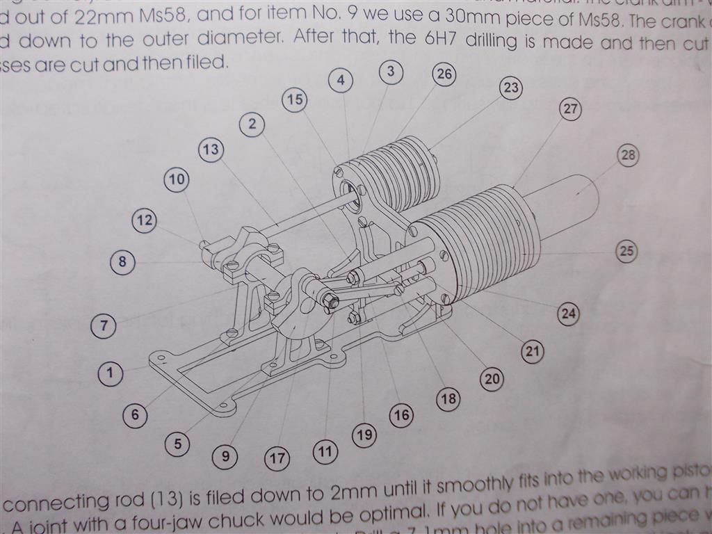

      I may have missed something here. Please have a look at the work cylinder plans and tell me what that ''2'' is to the left of the cylinder (part 26). Is that 3mm hole running down the side of the cylinder connected to the main bore of the cylinder at this point ?

        The 3mm hole is connected to the cylinder bore at the top of the cylinder and is shown as 2mm deep. The air in the system has to move freely between the power piston and the displacer piston with no leaks. A way to check if everything is OK is to disconnect the power piston and displacer from the flywheel, apply heat as normal and manually move the displacer piston backwards and forwards, you should see the power piston moving in relation to the displacer.

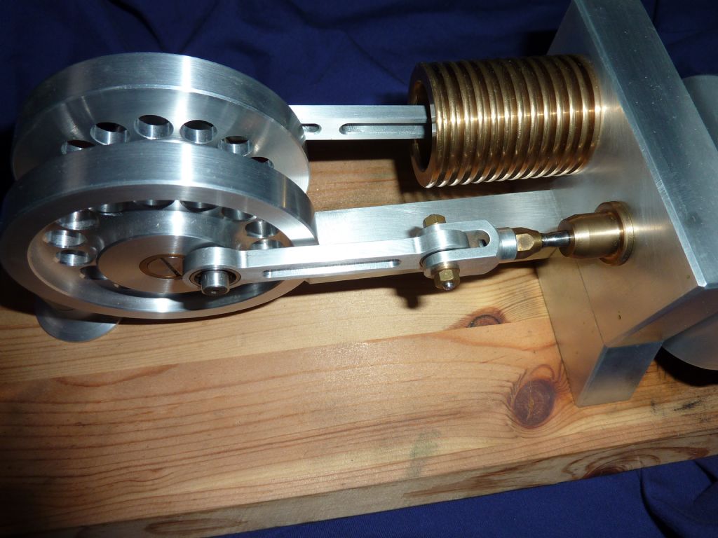

          linkage.jpgThe displacer piston drive linkage on that engine looks over complicated and would need pretty accurate machining for it to run freely , any linkage on a hot air engine needs a bit of play to account for tolerance buildups elsewhere and the design on this one doesnt seem to allow much if any hence the tight spots , if you cant get this one running freely i would be tempted to convert to a single rod running a clevis at the cylinder end for adjustment of the displacer piston , see pic of my similar type engine , it doest look fancy but its far easier to make and it works very well.

            I agree with Geoff regarding the coupling to the displacer rod, as you have it on your motor it would tend to pull/push side ways, creating a friction area. The fork that I use fits on a plain rod, and is held by a pinch bolt, saves putting a thread on the rod (lazy). I even used that system on my smallest motor, 3/8" bore. Displacer rod 2.5 mm dia.

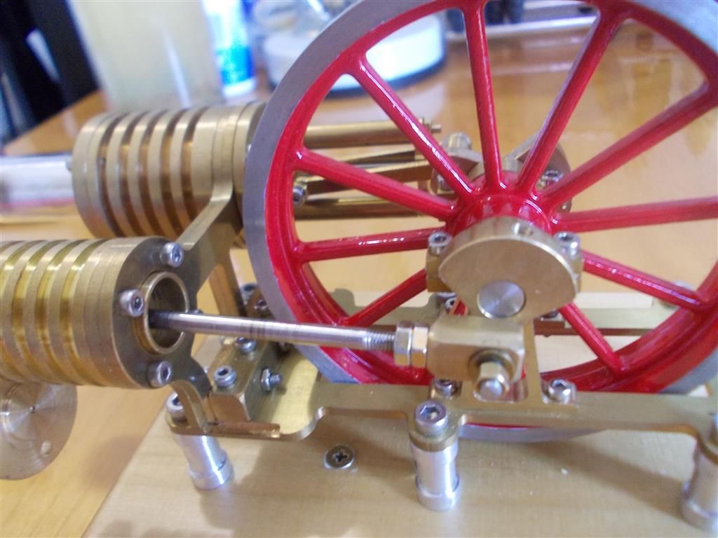

                  I used a 2mm drill bit in my bench drill as a milling machine to connect the hole to the main bore of the work cylinder. The engine runs much more freely now as the work piston is not just compressing air. When I spin it by hand it turns for about eight revolutions which I think is about as good as it gets. I like the improved linkage idea as outlined above and I will try that eventually but I do not think that friction is my problem now ; there is something else wrong and I am not sure what.
                  You can see the adjustment mechanism in photo #1 I made for the work piston connecting rod. This allows me to adjust the length and get the piston close to the cylinder head at TDC. Photo #2 shows the port outlet I made today and the piston at TDC…does this look about right ? I can't get it any closer to the cylinder head without it touching.
                  The work piston at TDC is just touching the newly enlarged port.
                  Very frustrating as it still will not run ! I get the feeling that it wants to. When heat is applied to the glass tube then the engine will turn over for about ten revolutions so something is happening. I tried to adjust the timing as I would a steam engine by advancing and delaying the crank slightly but this did not help….I did not really expect that it would but at this point I will try anything.
                  Points to consider :
                  1. The temperature here is very hot so maybe I cannot get a good temperature differential between the two cylinders ?
                  2. That hole down the side of the work cylinder may not be large enough or close enough to the bore to perform its required function ; I was worried about bursting through when I drilled it. As others have said, for a long hole like that it is best to just go straight to a 3mm drill bit rather than drilling pilot holes with smaller drills which will deflect. I may have to remake that cylinder again as it is not possible to enlarge that hole : the drill bit just wanders and follows the existing hole and would burst through the outer surface.
                  3. The heat transfers through the cylinder holders and the frame quite easily from the Displacement cylinder to the work cylinder. I assume that Bengs design does work and this is not the cause of my problem but what else could they have made the main frame and cylinder holders out of to reduce this heat transfer ?
                  4. I am tempted to make some gaskets for the cylinder covers as I would for a steam engine….a waste of time perhaps ?
                  5. What a bugger of a thing… it looks good though

                            Ian : I thought it was mentioned before that oil is a no-no in the pistons if Stirling engines ? I will try the soapy water on that gland to see if there is leakage there. If there is leakage at that point, is there someway to resolve the issue without making a whole new cylinder cover (24) ? If I knew how to thread cut on the lathe then I could make a gland cover and use some packing. Or perhaps I can do the same thing using an interference fit for the gland cover ?
                            I think part 24 is the only part I did not make two of…or three or four !

                              UPDATE : I still have a friction problem. As an experiment I disconnected the crosspiece from the D.piston connecting rod : I gave the flywheel a spin and it ran for 30 revolutions compared to about 8 revolutions when fully connected. The problem is friction on the displacement piston side. I will sleep on this tonight to decide what to do next.
                              Edited By Brian John on 14/02/2016 12:57:45

                                  No, this is the original flywheel.
                                  I think I will make up a linkage with a single connecting rod and a clevis as per the photo posted by Kettrinboy above. At this point I do not see any other solution. All the friction has to be minimised and there are to many points of friction in the original design.
                                  Edited By Brian John on 14/02/2016 17:06:38

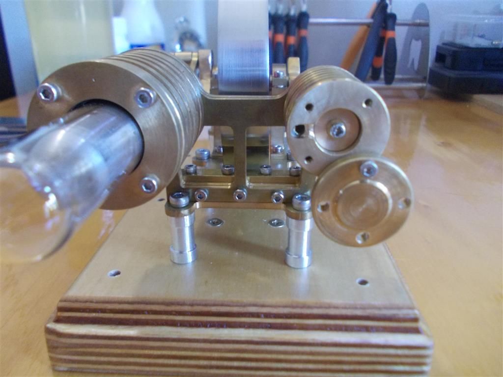

                                      I removed the glass tube and this did not make any difference to the friction so the glass tube is not the source of the problem.
                                      I am in the process of making a clevis pin and using a single connecting rod as per the above suggestion : it should be finished tomorrow. Hopefully, this will remove a lot of the friction.
                                      I am not sure why Bengs didn't go this way in the first place as it is much simpler to make ?
                                      I am still unsure about the D. cylinder cover (part 24). I do not understand why they have made the piston rod pass through so much brass (10mm in total) as this only adds to the friction.

                                        I think the idea is to use the thickness of brass as both steerage for the rod and a pinch point for the dsiplaced air. On the model i'm troubleshooting is a seperate bush – even longer and phos bronze into the ally cold cylinder.
                                        A carbon bush might be lower fricton, a cast iron one for duration?
