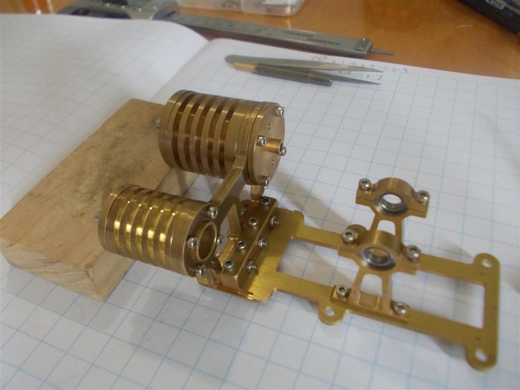

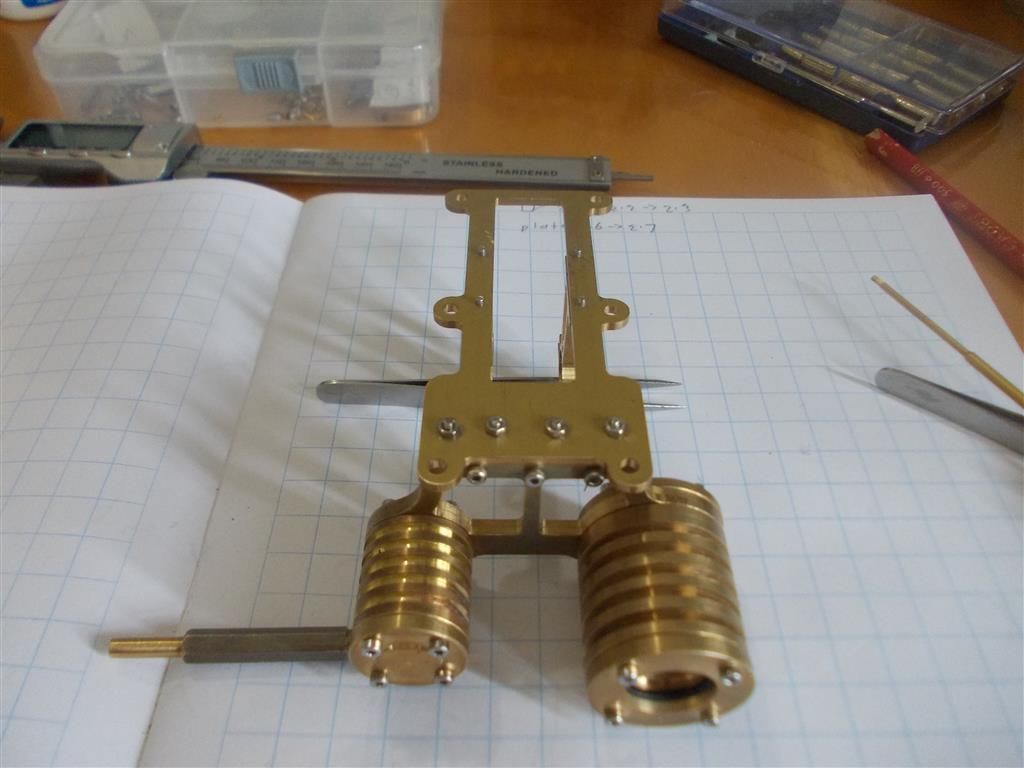

                                                  Moving into the final stages of assembly now that the M2 X 16mm socket heads have arrived. They were a bit long so I cut them down with the Dremel tool to make things a bit neater. I have order some M2 X 14mm and M2 X 12mm but I am not going to wait 3 to 4 weeks for them to arrive.  I know I will be using a lot of M2 socket heads in the future so I have ordered many sizes to have on hand. I have also ordered two more replacement sets of M2 X 0.4 HSS taps in the event of future breakages…and still looking for Alum !
                                                  I think this is a much better idea than soldering it all together :
                                                  Edited By Brian John on 05/02/2016 06:02:39
                                                  Edited By Brian John on 05/02/2016 06:03:59

                                                    Looks good with the screws holding it together. I agree better than solder.
                                                    No idea where you would get alum in Cairns. I do know that it is used in boiler water treatment to settle out soilds, or used to be, so not sure if a pool shop might have some for clearing murky pools??
