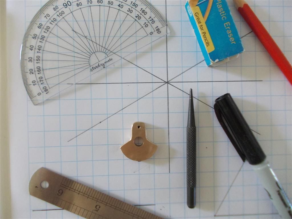

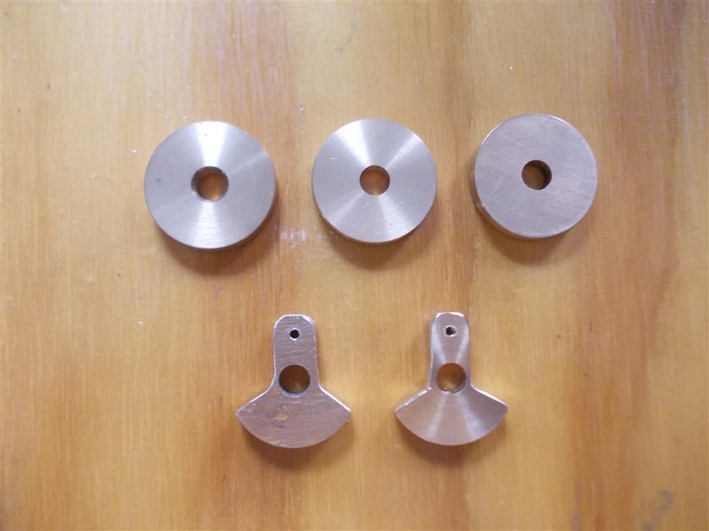

          The large crank arm was a complete disaster. I made a mistake by cutting on the wrong side of my marking lines hence taking away too much metal. Then I made the same mistake again on the second one ! I will have another go tomorrow and next time I will not rush it. I knew these parts would give me grief as soon as I saw them in the instructions. Fortunately, I still have three discs in reserve.

              Success : I got it right the third time ! The trick is to carefully mark out and then not cut too close to the lines with the slitting saw. I have to give myself enough room to clean up with the dremel tool and small files. I found that a pencil is good for marking out on brass as it can be rubbed out if you change your mind. The extra fine sharpie is good for making a dot before using the punch to mark a drill spot.
              I am still waiting on some M2 X 16mm socket caps to begin the final assembly. I am not going to solder the main cylinder section to the base plate as per the instructions ; I think that would be a silly idea in case it has to be pulled apart again. I have worked out how to join the two sections together using some 1/4'' square brass rod. I will post photos when the socket caps arrive from China. I think they will be here soon.
              I also have to decide whether to paint the inside of the flywheel my usual red colour. It looks quite elegant just the way it is.

                      When I make counter balanced crank cheeks, mine get cut out by hack saw and file, and I'v had the same problem of cutting the wrong side of the line.

                        I am not much good with the junior hacksaw ; it cuts in a straight line but always ends up at an angle ie. the cut is not perpendicular to the surface. I am not sure whether it is me or the hacksaw. I did buy a new junior hacksaw and still have the same problem !  I am okay with the full size hacksaw and I do not have the same problem with that tool. That is why I use the slitting saw for these small parts as it gives a much neater finish.
                          Brian,
                          I have mentioned this before, but : Please consider using a Jeweller's Piercing Saw for small jobs like this.

                            Will that cut through 4 or 5mm thick brass ? I think I would still have the same problem of keeping the cut perpendicular to the surface.

                              1. Yes
                              2. You won't know until you try it, but: Used properly, you should find it much easier.

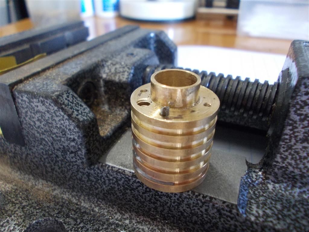

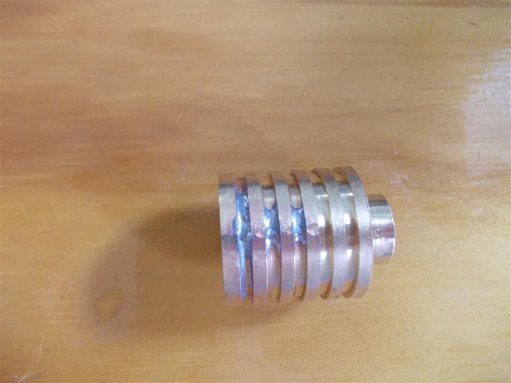

                                  You might remember that I mucked up the first work cylinder when the large 3mm hole burst through the side at one end. Today I repaired it using a small piece of brass rod fitted through the hole, soft soldering it in place then drilling out the 3mm hole again to remove the brass rod that was now partially blocking the hole. It all seems to have worked out quite well. It would not be too visible when the engine is assembled as it is facing towards the inside. I have since made another work cylinder so it was not necessary to repair this one. I just wanted to see if this would work.
                                  I have noticed that when drilling long holes that the drill bit seems to deflect a bit even when I go up in increments : 1.6mm 2mm 2.5mm 3mm. I am not sure what else I can do to avoid this problem.
                                  Edited By Brian John on 31/01/2016 06:01:22

                                    I too find it difficult to get very deep holes straight, if it's a through hole I find the best way is if I can drill half way, or a fraction more, then drill from the other end, you can then drill right through with a larger drill, and it will be straight.

                                      ''Drilll from the other end'' ……and end up with two holes ! I had already thought about that and dismissed the idea

                                        Perhaps someone with more experience than I can comment on the benefits of starting such holes with stub drills and slot endmills if equipment isn''t ideally rigid.
                                        I'm glad to say that my mill usually runs them pretty good if I start with an effective centre-drill but for tiny holes I've just bought stub drills to try on the mill instead (saves digging out broken tips)
                                        #223358
                                          I think you are drilling in two many small steps. I would go straight in with a 3mm or 2.5 then 3 if I wanted it to be on size or 2.8 followed by a 3mm reamer for a really good fit. By starting with 1.6mm you are using a very small drill that will be more likely to wander and then the rest just follow the crooked hole.
                                          PDK, get youself a spotting drill for starting holes, unlike center drills there is no small dia tip to break off, I now only use a ctr drill where I need a 60deg cone to locate a centre.
                                          #223360
                                          Ajohnw
                                            @ajohnw51620
                                            The smaller and crapper the drill the more chance it has of wandering. It's best to always start off with a centre drill. If you break the tip I explained what to do to get it out earlier but there is only a need to use the tip of the centre drill for holes of this size. It ensures the drill starts on axis but doesn't need the use of one of the very fine ones.
                                            Aluminium is funny stuff to drill. The hole needs to be drilled in stages with frequent withdrawals. The swarf often needs flicking off each time with a scriber. Rubbing some hand soap on the drill will help. How far in before pulling out – you'll need to find out for yourself. I don't know say 3mm drill, when the swarf has built up say 10mm back up the flutes. It's also a mistake to feed the drill in too slowly.

                                                1. The cylinder is brass, not aluminium. The hole is supposed to be 3mm but there is no need for a reamer as nothing goes in it (except air). This hole down the side of the work cylinder is connected to the displacement cylinder via the cylinder holders.
                                                2. I did have a 3mm spotting drill which I was using to start holes but it quickly became blunt after a few weeks and now it does not cut at all so I am reluctant to buy another. It is hard to guess the quality of these things when buying online. I have found that price is NOT a good indicator of quality : yes, good quality is usually expensive but just because it is expensive does not mean it is good quality !
                                                3. I have that exact same Irwin junior hacksaw as per the link. I still manage to cut on an angle which is not perpendicular to the surface. This is why I use the slitting saw in the lathe whenever possible. I do not have this problem when using a full size hacksaw so I am not sure what I am doing wrong.

                                                  Brian I tend to use two sizes of spotting drill 1/8" and 3/16" both that I have on the go at the moment are over a year old and I drill a lot more holes than you and they are still sharp so sounds like you got a duff one.

                                                    I'd try a centre drill if I were you Brian. They are designed for the job and don't flex at all. They needn't be exactly on centre either as they are capable of cutting on one side which will generate a true start for the drill to centre on when it's used.
                                                    It is best to cut at least a slight cone but taking a No 4 the tip is only slightly over 3mm dia., a No 3 slightly less. Your unlikely to break either size. I use a No4 most of the time and a No2 if I need to for some reason. Both sizes are pretty robust. If some one's tail stock is well out they may have problems with a number 2. I don't feed these as quickly as a drill but they do need to cut and not just rub especially on aluminium.
                                                    If you buy more spotting drills look for HSE or M35. Frankly I can't see the point of them as wonderful as they are,
                                                    I also have some No1's or 0's. A bit fine for a boxford really as they would ideally need a higher speed than it can give but the correct feed rate will look after that.
