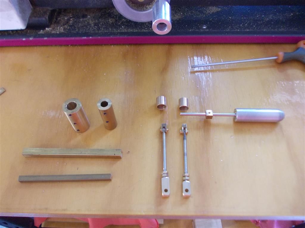

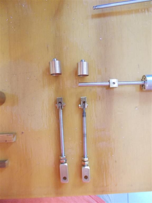

      Progressing slowly ! The small parts (12, 14 and 18) gave me some problems eg. drilling holes exactly in the centre of the end of a square bar. I have now made two jigs to insert 3/16 and 1/4 square bar and centre drill the end to mark the correct position. I then remove the work piece and drill the hole using the bench drill as the grub screws will not hold them strongly enough when using the lathe. This seems to work okay but part #18 was a pain : I made four and ended up with one good one ! I made two of #12 and two of #14 as I need the practise.
      The work piston connecting rod has two lock nuts on it. This is something I have added.  I have made two of part #12 : one is 12mm as per the instructions and the other is 15mm which will give me more room for adjusting the length of the connecting rod should it be necessary.
      I am still not sure about that 2mm socket head sticking up out of the piston. I may have to find a better way : perhaps some threaded rod and Loctite.
      Next time I do something like this I will use hexagonal bar as this can be held in the lathe chuck. My usual suppliers have gone missing in action so none can be ordered at this stage.

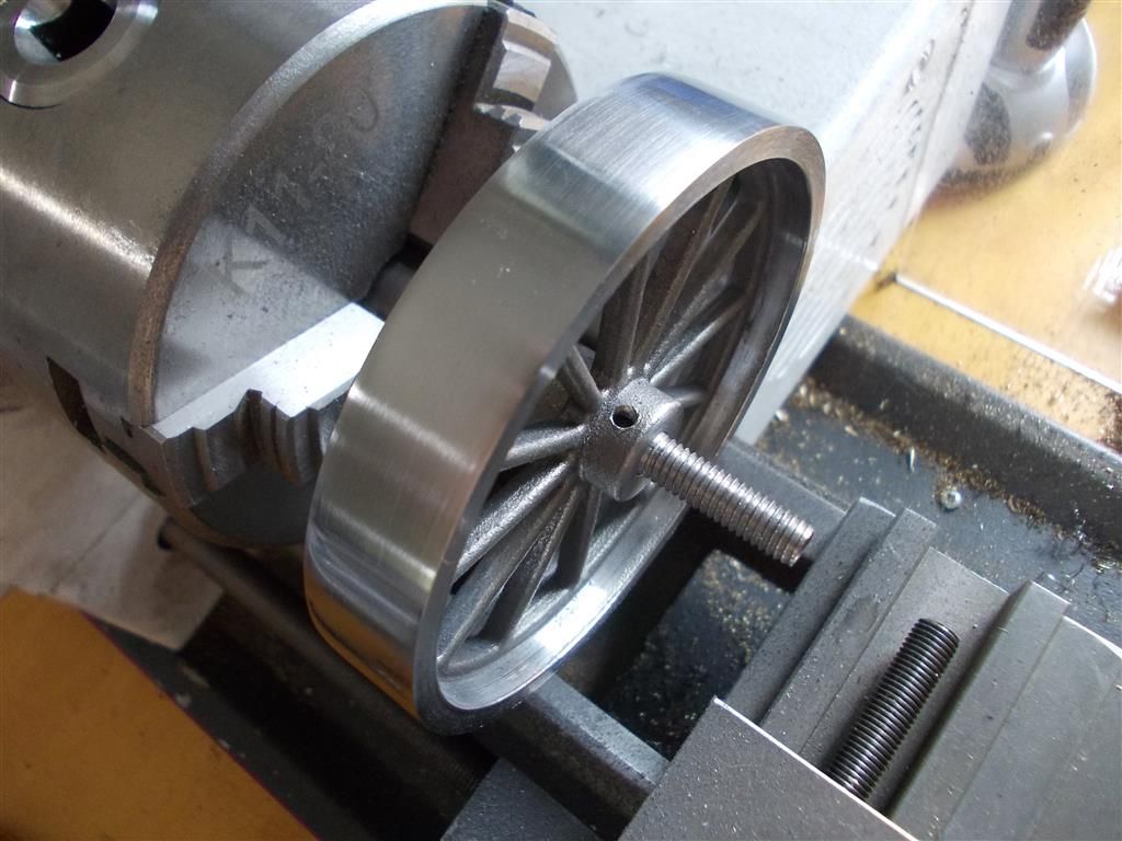

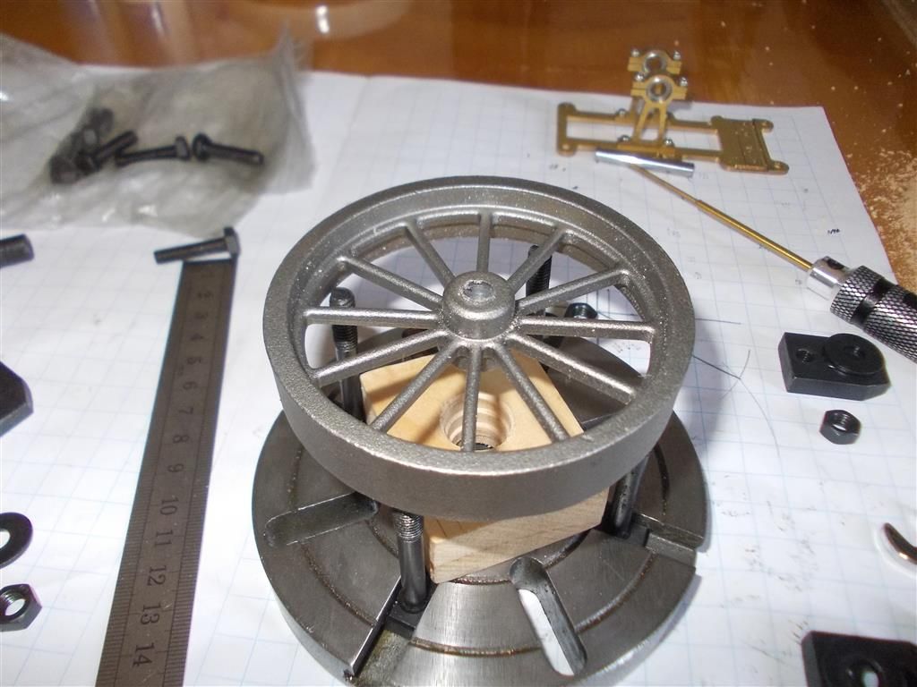

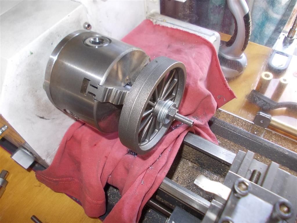

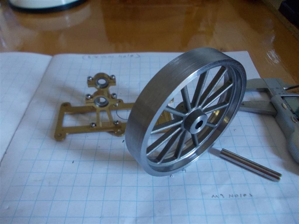

          I decided to tackle the flywheel next. I have been putting off my first use of the face plate but when I tried to set it up I found that I could not get the clamps inside the flywheel. The flywheel is too big …this was the smallest flywheel I could find at the time. Maybe I am missing something here ?
          Anyway, I went back to the old method of using a steel mandrel. This worked well with a number of brass and aluminium flywheels but this wheel is cast iron which I have never machined before. I have drilled out to 5.8mm and then reamed it out to 6mm ; I now have a nice fit for the axle. I have machined the hubs : what a bugger trying to hold the hub in the lathe chuck and getting it to run true !
          I have run out of time today but I will machine the edges tomorrow. The cast iron is tough stuff : I bent my 3mm drill bit when boring the axle hole.

          #222083
          pgk pgk
            @pgkpgk17461
            Attach a piece of board to the faceplate and screw to that?
            #222106
              Brian you may wantto add a ctr drilled hole onto the end of your mandrel and then you can bring up the tailstock for a bit more support.
              On my faceplate I drilled the mounting stud holes right through, tapped them and I now have 3 holes nearer the flange that I can screw studs into for holding work or driving a dog.
              #222120
              Ajohnw
                @ajohnw51620
                I'd say do put a centre hole in the end of the mandrel.
                Considering power and speed on a variable speed lathe you might benefit from buying a few tool bits of this style before even starting – cast iron can be very good at wrecking hss tools even when the lathe is run very slowly if it has a very hard skin – hopefully you wont buy any like that the usual problem is sand in the skin but it can be extremely hard even without that.

                #222166
                Brian John
                  @brianjohn93961
                  Jason : there is already a hole in the end of the mandrel. It was put there when I was making the mandrel. Thanks for reminding me to use it.
                  John : I do have a set of carbide tools. I found the flywheel tough to drill through but there was no problem facing off the hub. We will see what happens this afternoon when I finish machining it.
                  #222185
                  Brian John
                    @brianjohn93961

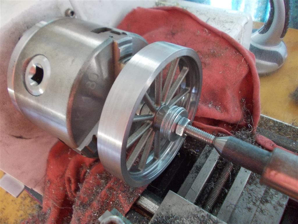

                    Okay…done , well almost. I have not drilled and tapped for the 3mm grub screw yet as I ran out of time. This is my first and last machining of a cast iron flywheel on this lathe. I ended up with a ''not too bad finish'' but it could have been better. I tried many different speeds and various tools to get a good finish. In the end I used a carbide tool on high speed (1200 RPM) with autofeed for the final finishing cut. Any slower and the lathe would stop…..even when taking 1/4 X 0.1mm cuts = .025 mm ! Even stainless steel is not as much trouble as this rubbish. Any future projects will have the cast iron flywheel substituted with a brass flywheel. I don't care what was prototypical ; I hate this stuff !
                    I am not sure how I will go about drilling and tapping for the 3mm grub screw. I do not have a tilting vice or a tilting drill press so I will have to drill it by hand. This will not be much fun considering the cast iron flywheel managed to bend my 3mm drill bit when using the lathe to bore the axle hole ! I am finished for the day : I will think about the best way to do this tonight and tackle it tomorrow.
                    NOTE : the finish looks worse in the photos. In reality, it is not too bad. I should not have tried to take a cleaning cut on the inside. It was quite tidy as cast and I only made things more difficult by trying to do this. I have machined enough brass and aluminium flywheels to know this by now ! I may end up painting the outside as well as the inside of the flywheel…perhaps black on the outer surfaces with red on the inside ? That will stop the rust. It is a lovely looking flywheel though ; I wish I could find something similar cast in brass.

                    #222191
                      Looks quite a reasonable finish to me given what you have to work with.
                      I would not say its the cast iron that is rubbish, more a case of at that diameter its on the limit of what the machine can handle.
                      #222192
                      Roger Provins 2
                        @rogerprovins2
                        With a little ingenuity you should be able to clamp the wheel at a angle on your pillar drill table.
                        Be much easier than by hand!
                        I'm surprised that your drill doesn’t tilt – all the other similar ones I've seen do

                          #222195
                          Brian John
                            @brianjohn93961
                            That is the supplied flywheel for the Laura kit.

                                You could soon polish the flywheel up with emery cloth Brian. Maybe with a drop of oil to help stop it clogging up.
                                You'll probably need an extension drill for the grub screw hole. There are 2 ways of doing that. Face, centre drill some 1/4 dia mild steel, drill a hole and then loctite the drill in in it. Or use a pin chuck to hold the drill and fit that in the machine's chuck. These might need tightening with pliers.
                                When you figure out how to hold the flywheel at an angle don't angle it any more than you need because the drill will be inclined to skid on the surface. A centre punch mark at the angle the wheel is at will help but I'd be inclined to mark the surface with say a 1/4" dia drill as well before using the one for the tapped hole.

                                  Jason : you are quite right, the table on my bench drill does tilt. There is large bolt which will first have to be loosened but I cannot shift it at the moment. I will give it a go tomorrow afternoon.
                                  John : I did try to give it a bit of a polish with some 1500 grit sandpaper but it made no impression at all.

                                    Try something like 180 or 200. Emery cloth or wet and dry not sandpaper. The cloth lasts a lot longer. I'm stuck with 180. I walked into a surplus tool place and the owner had put a large roil of the stuff and other bits and pieces on a pallet before the place shut down. The lads said help yourself. Actually I don't think the stuff I have ever wears out, it just clogs.

                                      Brian, you need to start with something quite a bit courser than 1500, try either worn emery cloth with a drop of oil on it, back it with a steel rule or fine file, or you can use wet and dry paper, say around 300 grit, then somewhere up to 1000 grit. You'll get that stuff at the hardwhere shop handy to have some (which reminds me, gotto get some).
                                      The only problem I can see you having is the BLACK dust, although that can be helped if you can rig up a vacuum cleaner next to the tool post on the lathe (just don't let the dust go through the motor on the vacuum cleaner).
                                      I normally cut CI at about half the speed of mild steel, and I usually cut the MS too slow.

                                          Brian John
                                            @brianjohn93961
                                            I could not budge that large nut (19mm AF)  to tilt the bench table ; it just would not move so I used a block of wood under the vice. When drilling the hole I almost did not leave enough room for the chuck on the tap tool (it was touching the outer rim of the flywheel) but I just managed to get it in there….lucky !
                                            I then polished it up with 400 grit wet and dry ; I had nothing larger to hand. It is a nice finish…almost a shame to paint it at all and that includes the cast surfaces which would normally be painted (red). I may just leave it as is.
                                            The last parts to do are the crank arms 8 and 9. You might remember that I made a mess of these at the start of this thread. They were the very first parts I attempted to make. Hopefully I can do a better job tomorrow. I cannot put them off any longer : there are no other parts to make

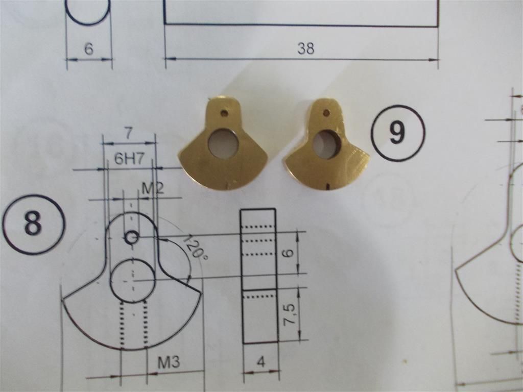

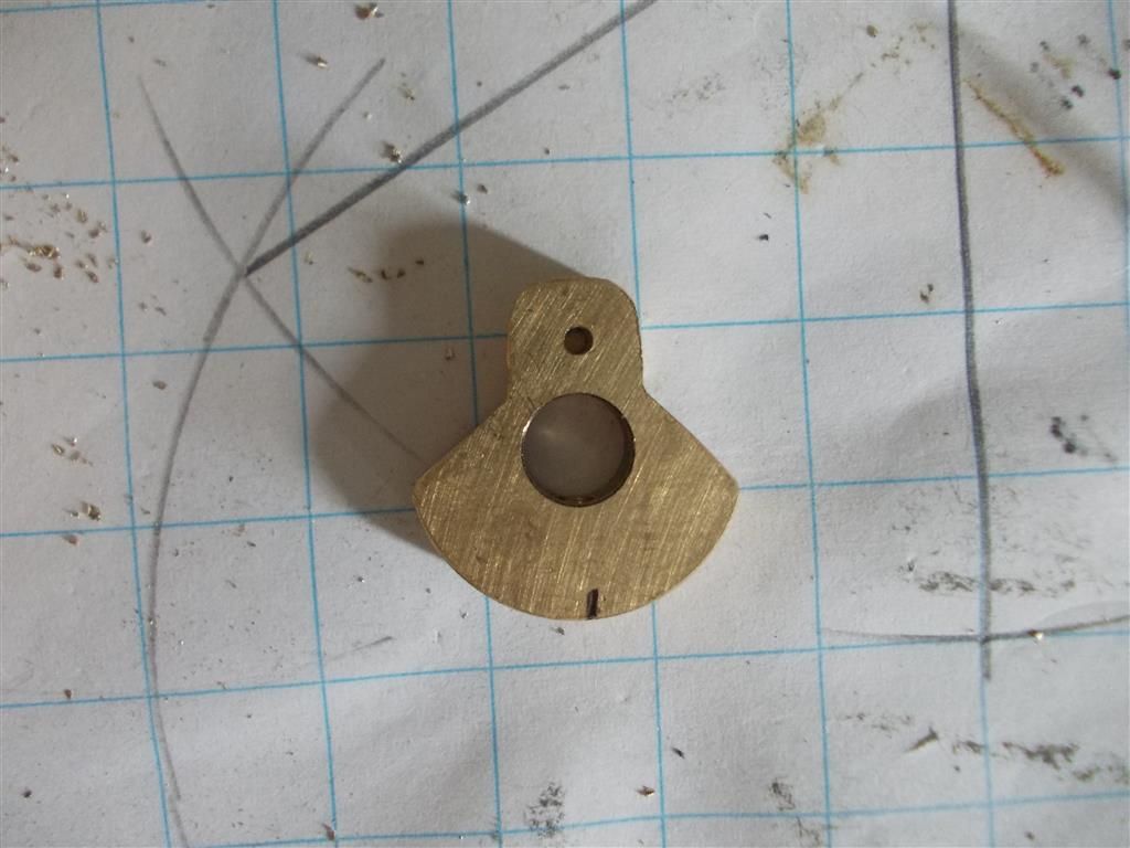

                                                I had another go at the small crank arm today (part 8). I now have a slitting saw which I did not have on my first attempt months ago. The slitting saw is a wonderful thing : if you have just bought a lathe then make this your next purchase (available from Arc Euro).
                                                I made two of the small crank arms today as I thought I might get better as I went along but it was not to be  I think the first one on the left is closer to the required shape but I am reasonably happy with the day's work. Why are the crank arms this shape anyway ? Could they not be circular on the model ? I realise that on the prototype the shape was probably based on weight distribution and the engines would run better this way.

                                                #222476
                                                pgk pgk
                                                  @pgkpgk17461
                                                  I must admit i had an easier time making my crank webs..partly the design didn't have your internal radii and the radius on the narrow end was left drawn as the original bar diameter (and i used my mill for the flats)
                                                  One option you have is to superglue the two parts together and file as a unit so they look the same then seperate with heat. Other options include drill holes for those internal radii and filing buttons for the narrow end radius.
                                                  #222481
                                                  Brian John
                                                    @brianjohn93961
                                                    I only need one small crank and one larger crank (I will make that larger crank tomorrow). I only made two small cranks today because I need the practise !

                                                      Ditto… I think I've made almost every part twice now..and one three times!
