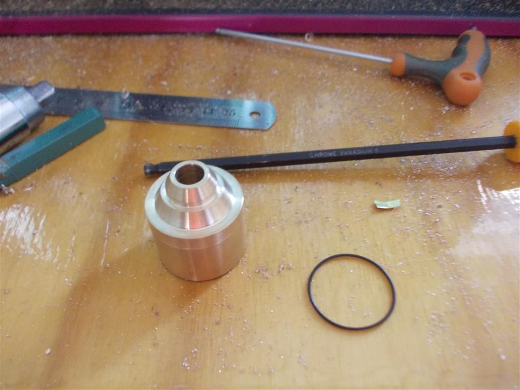

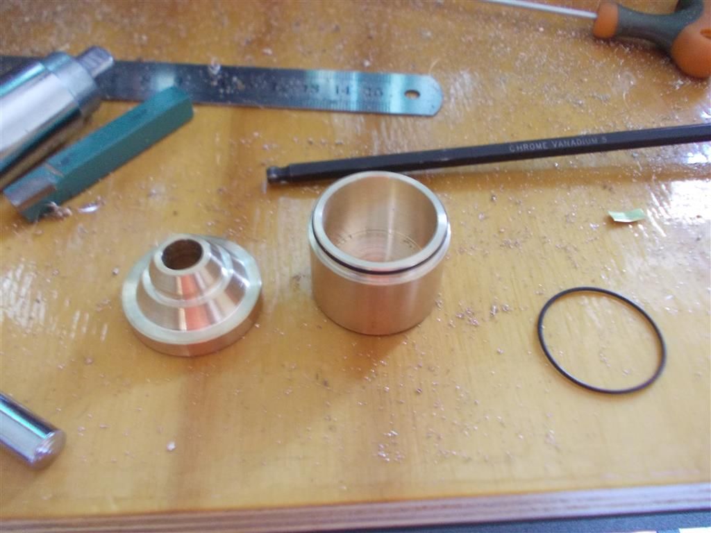

                            I tried to make the burner today : bit of a disaster ! It is a good exercise in turning tapers and using the boring bar. I successfully made the base including a recess for the rubber O ring. Then I made the top for it. I carefully made the top to fit the base and I ended up with a great interference fit…without the O ring ! So I then tried to take a bit more from the inside of the top to accommodate the O ring and now it is too big….bugger.
                            I can salvage the situation by drilling and tapping for an M3 socket screw on the side of the top ; that way I can just finger tighten it. This is not a bad idea ; the more I think about it, the more I like it.
                            Or I could make another top to fit this base and another base to fit this top. That would be a good exercise in turning and boring. I will end up with two burners but they are useful things and they have given me two O rings in the kit.
                            I will be extra careful tomorrow. How necessary is the O ring anyway ? I am thinking of doing without it and just using an interference fit (maybe with the M3 locking screw as well).

                            #220505
                            pgk pgk
                              @pgkpgk17461
                              I'm guessing the o-ring is there to make this a firm pushfit and to prevent leakage from carrying/vibration that could lead to ignition around the tank. Perhaps an O-ring with a thicker ring is availaable?
                              #220546
                              Brian John
                                @brianjohn93961
                                That is a good idea if I can get the correct size O ring : I have 28 x 26 x 1mm. I think I will need 29 x 26 x 1.5mm

                                #220559
                                Ian S C
                                  @iansc
                                  I think you may find that with out an O-ring it may leak meths when it gets a bit warm.
                                  I don't see it, but is there a wee hole (1.5 mm/ 1/16&quot in the top of the burner, this is needed to allow air in as the meths is burnt.

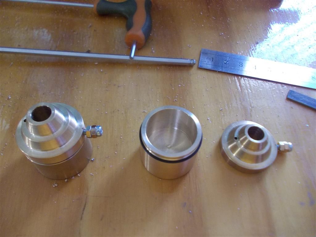

                                        I gave up trying to get the O ring to sit in the recess and have the top fit snugly over it. I can good a great interference fit between the top and the base but not with the O ring….bugger of a thing ! So I modified the design by drilling and tapping the side of the top to take a 3mm screw at the side. The nuts are just to give me something to grip with my fingers. It is not very elegant but it will do for now. The rubber O ring is not really doing anything now. I will make some wicks and try out both burners tomorrow. Yes, I drilled the breather holes too.

                                        #220864
                                        Ajohnw
                                          @ajohnw51620
                                          Personally I would put the O ring in a groove in the cap. So make the bottom, add bit of a chamfer to the inside edge of the top, polish and then make the cap. Aim for around 10% compression on the O ring but fit it in the groove and then try the base on it. Adjust accordingly while it's still on the lathe. This would mean that the total height of the top would have to be less than the depth of the cup – or it would be as I would make it.
                                          I have a small spirit burner that has a ground glass cap to go with it. Trouble is that when it's filled with meths and left for a while the stuff still evaporates so I would make a cap for the burner as well. In that case it may be best to put the O ring in a groove in the cap then fit that to the top part again while it's still in the lathe. Polishing it in the area the O ring slides over.
                                          The other way of course is to trap the O ring between surfaces and try some screw cutting. Aluminium isn't the best choice for that. It helps if it's anodised but it can still bind.

                                          Ian S C
                                            @iansc
                                            One problem some people have with O-rings. If an O-ring is to fit in a gap, like the top on a burner, it must have side clearance in the groove, because rubber can not be compressed, only distorted, so make the groove about 1.5 the width of the O-ring. You may know all this, but maybe someone doesn't.

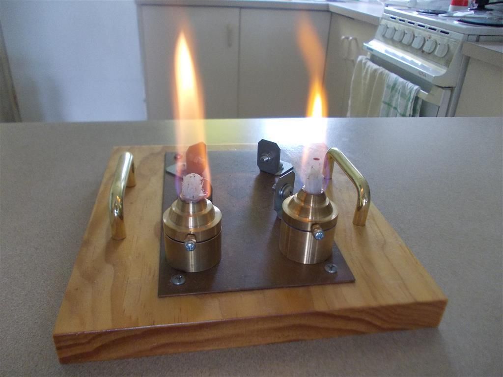

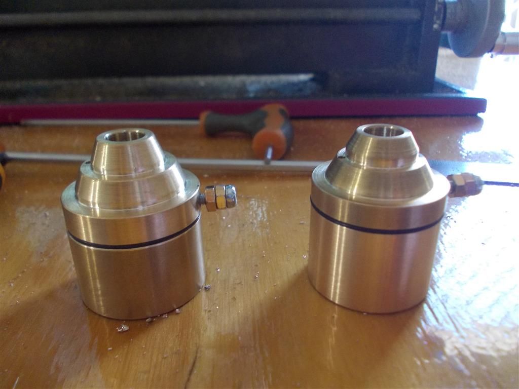

                                                I will not be trying the graphite : it is too messy.
                                                The burners work okay : 10 minutes of burn time with 5mls of meths.
