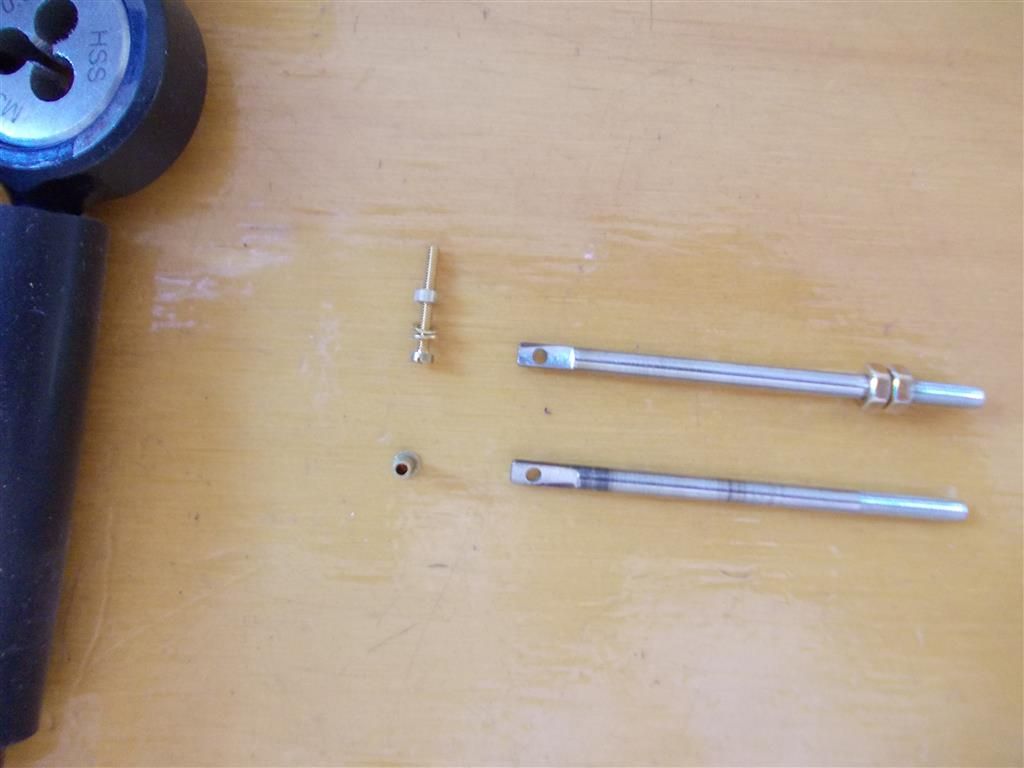

                    I made the connecting rod (13) today. I actually made four of them, two of which have been discarded. I decided not to drill the hole out to 2mm on the flat of the rod ; I have left it at 1.8mm. It will not now accept the 2mm rivet as per the instructions when fitting to the piston joint (14) but I will use a 10BA screw and nut with Loctite to hold it together instead. I thought drilling a 2mm hole was really pushing it too close to the edge of the rod. I have put 12mm of M3 thread on the other end so I can fit two lock nuts. This will allow me to make adjustments to the length of the connecting rod.

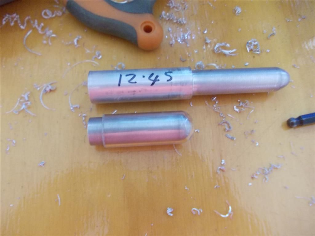

                      @brianjohn93961
                      I had a go at making the displacement cylinder today. I am getting there but the process has raised a number of questions. I made the bullet shape by producing a 30 degree taper and then rounding it off by hand using a large file. Jason : you are right. Turning the taper using the top slide wheel is much easier than I thought it would be…no handle required.
                      1. Why is it the piston made of aluminium ? I hate this stuff and my lathe does not like it either. It gums up my drill bits and my reamers and I find it almost impossible to tap. I have to drill and tap for an M3 grub screw that will hold the piston rod in position but I doubt it will be successful. I have had problems in the past tapping aluminium. If the piston HAS to be aluminium then I may have to make a brass sleeve and tap that and Loctite it in position in the piston.
                      2. My lathe chuck always gets very hot when working with aluminium. I noticed this a few weeks ago when I was making the aluminium columns (part 30). Why should this be ? Brass does not cause the same problems.
                      3. The ID of the glass cylinder is 13.2mm. The instructions say to make the piston 12.5mm but this seems like a very sloppy fit. You can see in the photo that I attempted to make one to this size (actually 12.45mm) but then stopped and made another one to 13mm diameter. This seems a much better fit and still plenty of room for free movement ie. it does not touch the sides of the glass tube. Any thoughts on this ?
                      Edited By Brian John on 07/01/2016 06:28:15

                        Brian there has to be room between the displacer piston and the cylinder ID for the air being displaces from one end to the other to flow unimpeded. Also, there has to be room for the piston to move up and down without touching the cylinder at any point — sometimes a bit tricky if the alignment of the piston rod and bushing are not quite spot on, or as the bushing wears a bit. Half a millimeter clearance all round is not unusual, so a total of 1mm difference in diamter.

                          Brian, what type of aluminium alloy are you using? Something like 2024-T3 is nice to machine, the cheesy soft stuff from the usual suspects (B**nings etc) is crapola.

                            This comes from Norweld in Cairns. Hopper may know what it is.
                            Why aluminium ? I am thinking of making a piston out of brass tomorrow.

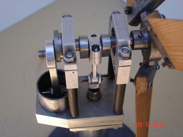

                                    Displacer piston viewDisplacer piston viewFor a displacer piston the ideal metals are stainless steel or titanium bored out to give a wall thickness of 0.25 mm or so , they have low heat conductivity and can stand high temps ,and the piston is as light as it can be , just to give you an idea the one in the pic is stainless steel, an aluminium bung is then usually loctited in the open end but there must be no air leakage into the piston or that can stop an engine from working , the reason Bengs have specified a solid aluminium piston is as its a solid piston there are no leakage problems and it is the lightest metal apart from magnesium to make a solid piston from , if you make a solid brass piston it will probably be too heavy unless you bore it out to lighten it and fit a bung , but if this is done properly it will be as good or better than a solid aluminium one

                                      AjohnW : they did supply a small piece of aluminium. I have not used it yet because it is only 51mm long ! I may give it a go tomorrow if I have time.
                                      I will give some thought to making a hollow brass piston and how the piston rod may be attached to that.
                                      If I do have problems drilling and tapping my already constructed piston, then I still have a few ideas up my sleeve to make it work.

                                        I had no problem making the displacer piston with the supplied material, although there wasn't much to hold in the chuck. It did seem like a fairly hard aluminium, but machined and tapped with no problems.

                                            Andrew : ''there wasn't much to hold in the chuck'' …..that is why I did not use it. I might give it a go tomorrow : do half and then turn it around and do the other half. That usually never works for me but what the hell !
                                            I had problems turning and parting off the Norweld aluminium. I would try to slow the lathe down but it would stop ! It never stops when I am turning brass, no matter how slow I run the lathe. From the above information, I would guess that the tools I am using are not suitable for aluminium. This would also explain the less than perfect finish I am getting ; I had to finish off with 1500 grit sandpaper.

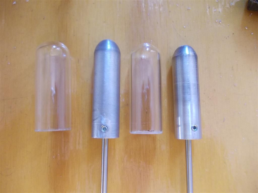

                                                      I did not have any trouble drilling and tapping that piston made from the Norweld aluminium. But I decided to make another piston closer to the diameter in the instructions using the supplied aluminium. This was much better : the aluminium machined like brass and my lathe did not get hot either. I wish I knew what it was so I could buy more from somewhere.
                                                      Anyway, now I have two displacement pistons (12.9mm and 12.7mm). I may make a 12.5mm piston tomorrow as per the instructions but my gut feeling is that it would be too loose.
