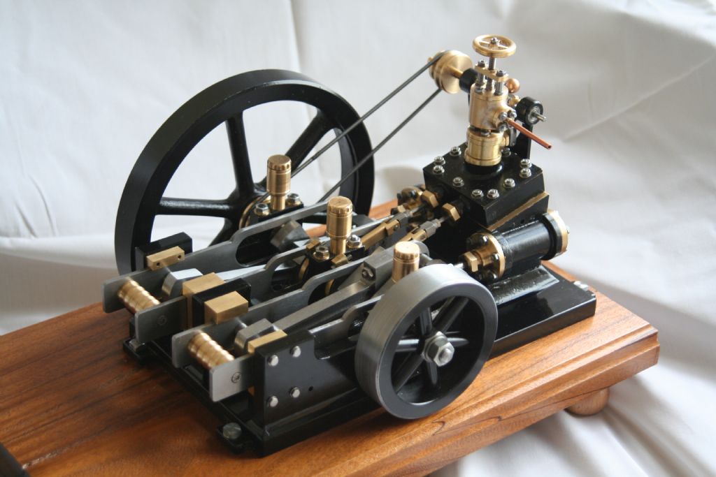

                          Mike/Jim Your engines look great it always gives me a great buzz when I see one completed and running. I'm extremely pleased that you enjoyed building it.
                          Jim I like how you've added the valve and governor and piped it for steam have you ever run it on steam ?. I know that one of my grasshoppers has been run on steam successfully but I've never heard of the horizontal being run on steam.
                          Jason is spot on regarding the use of studs and nut sizes, I just used standard M3 nuts with studs as they are easy to get. When using studs the trick is to get them all the same length the easy way to do this is to assemble the parts with two nuts then file down the stud level with the top nuts, remove the top nut and you've got the same length of stud standing proud making things look nice a neat.
                          As an aside I'm just completing a book for Crowood press on building this trilogy of engines, hopefully it will be out sometime this year: so keep a look out for it.
                          Stay Well
                          Stew

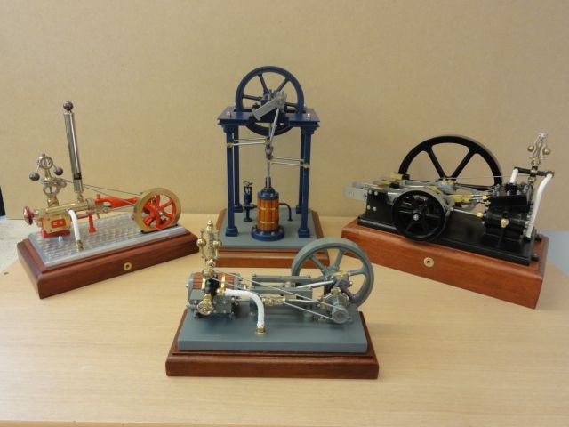

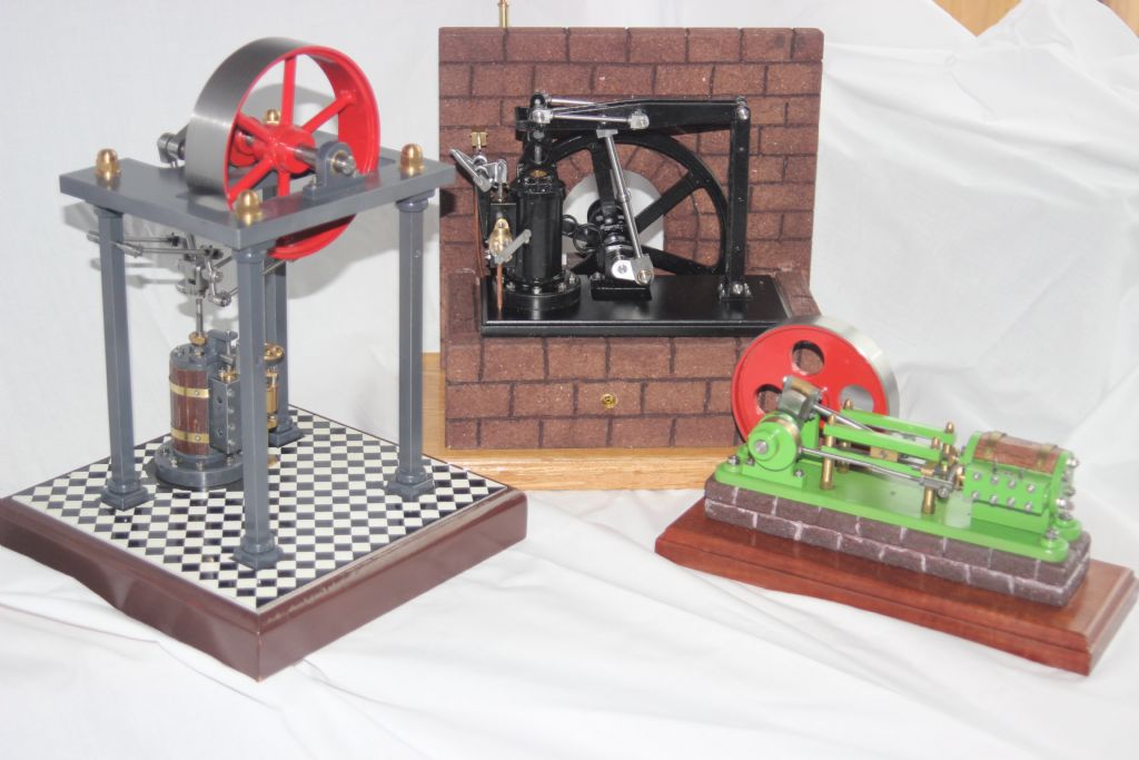

                            Hi Stew
                            Thanks for the comment. I like making your designs and always try to do justice to them.
                            I have never run any of my engines on steam; I know it would be a good thing to do but many of my earlier efforts have been assembled using adhesive where silver solder would be required for steam. Maybe one day a boiler will come to the top of the "round tuitt" list.
                            Just for interest here is a pic of my "Stew Hart Collection".
                            Jim

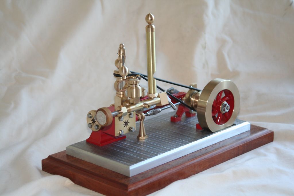

                              Wow Jim that's an impressive collection of engines nice to see it includes the popcorn engine and the over crank engine, the over crank was the first I designed and built and submitted for publishing. You must do the the Grasshopper next to complete the trilogy
                              Ok you've shown me yours I'll show you mine
                              Thanks for your comments and interest in my designs
                              Stew
