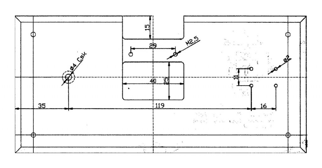

        I have been slowly making this engine and when I come to the base plate there are two dimensions the same. One is 35mm from the end and the net one along is the same. Clearly this is wrong as this dimension is at least three times as long. Hopefully Stewart can clarify this. Happy New Year to everyone.

          Hi there. I am building the same engine and Stewart sent me the original plans. Does this Help?

            Hi Anthony, Thank you so much for taking the time to reply to my query, now I can get on with the base. Regards Metalmuncher
