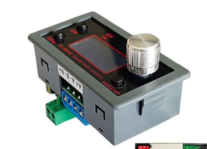

There are alternatives that include speed control and reverse in a box like this but this example is max 30V. It may be possible find one that does 60V. The wiring is simple except for the limit switch. No problem using a microswitch to cut the power, but the problem then is how to restore power so the motor can be reversed out of trouble. Might be easier to wire the switch to a buzzer and position it to warn the operator to STOP NOW!
In the example, there are two green terminals marked + and -. Just run one wire from + to any of the three + terminals on the S350, and a second from – to any of the three – terminals on the PSU. The controller also has 4 terminals labelled A+, A-, B+ and B- that match the stepper motor.
