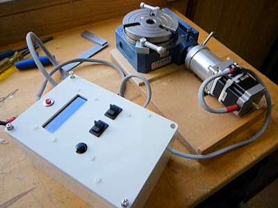

        There is a long thread on the subject here
        I built one using Dave’s (SOD) Arduino code which is still available here
        It works extremely well.

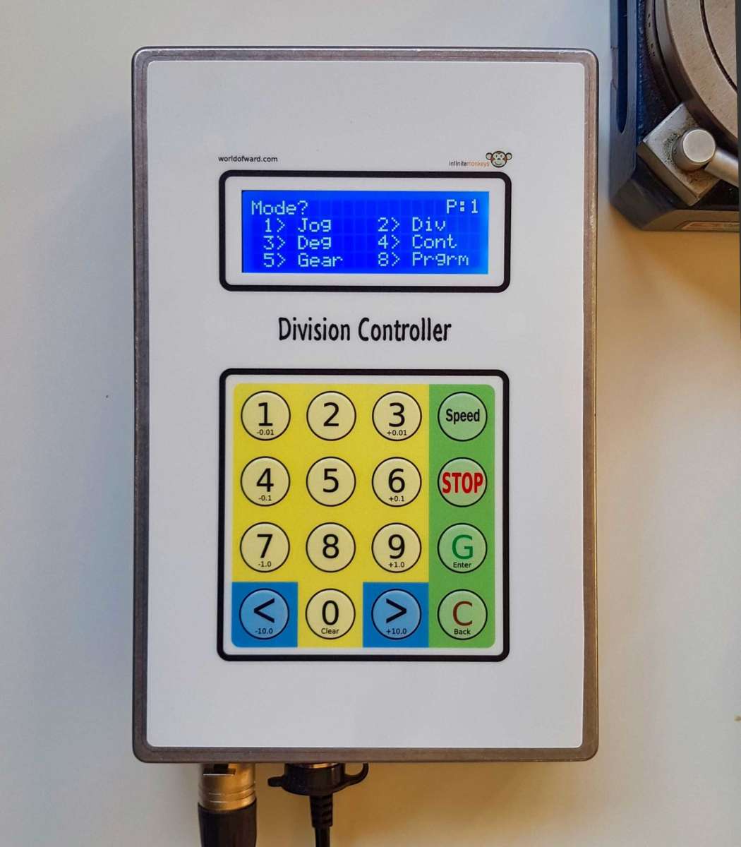

          Or World of Ward (PIC rather than Arduino), available as a finished product, or kit.   Note posh keypad.
          ControllerIMG-scaled

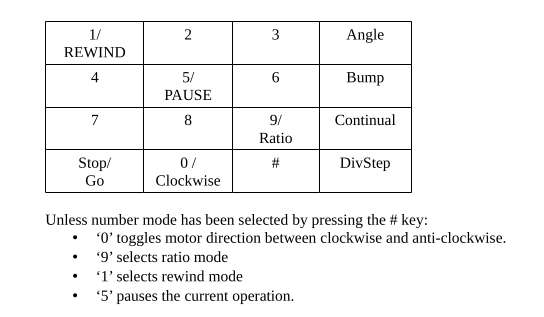

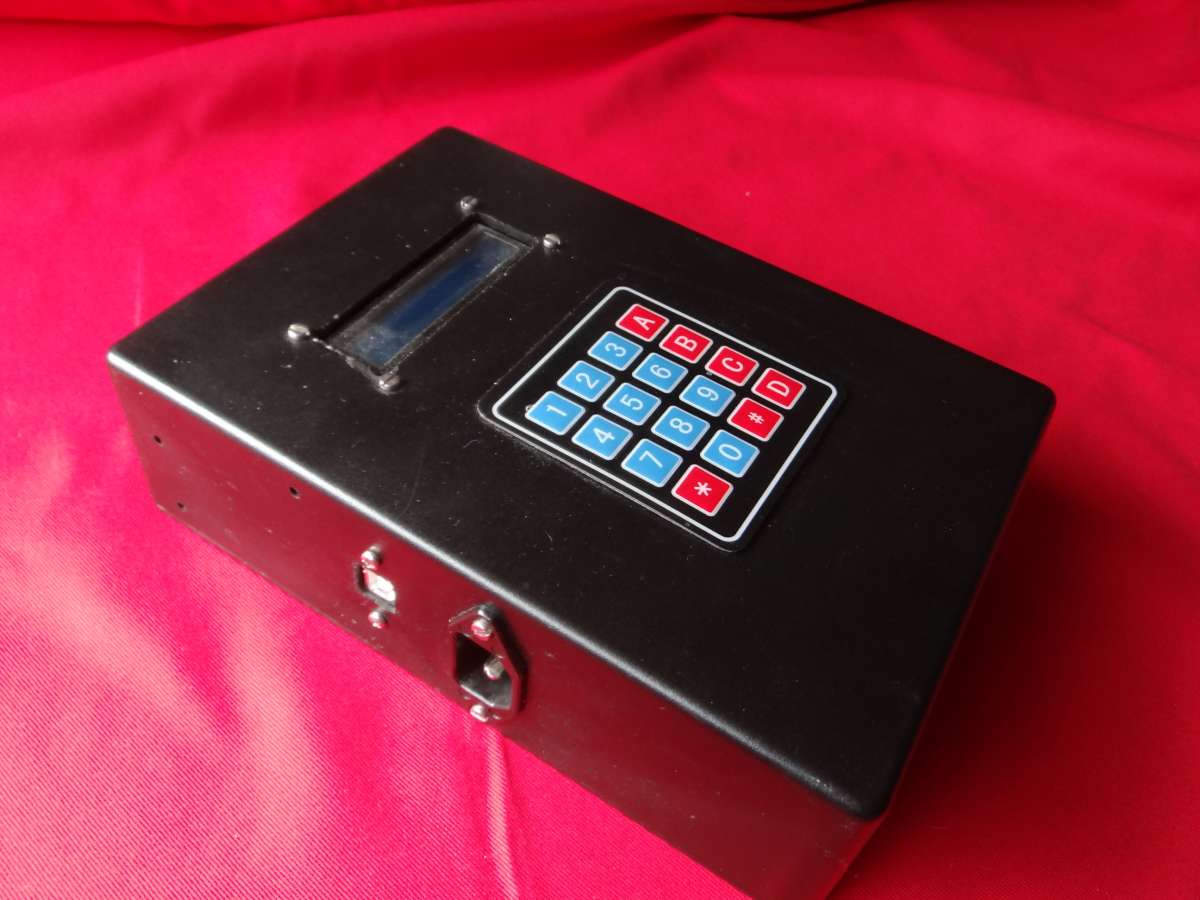

          Gary Limings uses a nested menu, which John Stephenson didn’t like, so I wrote a keypad controller
          DSC05965
          Where my ordinary £2 keypad is set-up as:
          keypad

            Thank you very much everyone it is world of ward i was trying to find but could not remember the name.It will be taped to the inside of the box now i ,Iwanted to fit a decent key pad as now having sausage fingers trying to work those smallbuttonts was getting very frustrating.Thanks again Graham
            #757486
            Dell
              @dell
              I have the world of ward and the nice thing I find about it is you can have two or more  different size rotary tables and just use the one controller, I have 2” and 4” and I believe that it can run another axis at the same time although I haven’t done it.
