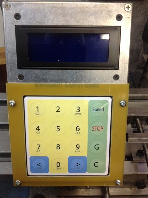

                Not everyone likes the sort of nested menu interface Gary uses to set-up his indexer. John Stevenson asked if anyone could do similar without nested menus and I offered this keypad operated solution with additional features; the software and documentation can be downloaded from dropbox.
                #349552
                John Haine
                  @johnhaine32865
                  There is also the ward indexer which I use and works well. See my album from which this photo is taken…
                  I second the point about making sure the wheel is properly fixed, having produced a 48 tooth ratchet wheel when I was aiming for 60…
