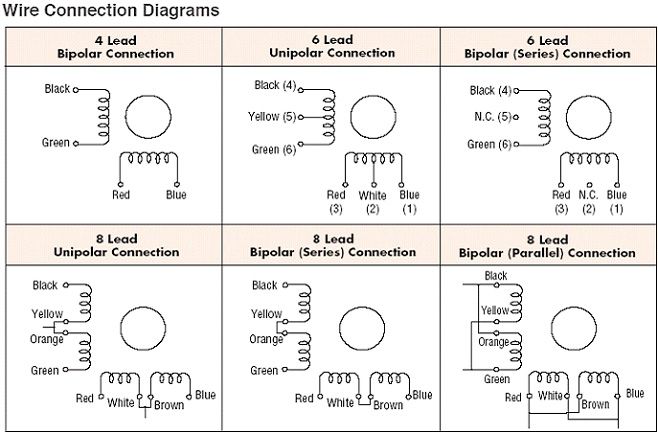

              OK, I will try again – Keyboard developed a 'sticky key' during the last attempt…
              To use a UNIPOLAR wired motor on a BIPOLAR stepper driver does not make sense. A Bipolar driver cannot drive the center tap at all – You cannot provide a power source to said center tap as there is no ground to reference it to – The bipolar stepper driver will be most upset…
              IF the stepper motor is a true 8 wire motor , ie, it has 4 SEPERATE windings as you intimate, and if your stepper driver is a Bipolar driver, labeled on the motor connections as A+, A-, B+, B-, then simply wire the motor in BIPOLAR mode, either Series or Parallel, and connect it to the driver.
              You do need to know the wire colour codes of the motor you have. Then connect  either in SERIES or PARALLEL mode as in the last two images in the picture below.
              If you require Hi-RPM from the motor, connect as in the series connection, and provide the driver with the maximum DC supply voltage is can handle, in order to obtain useful torgue from the motor.
              If you require Hi-Torque rather, then connect as in the parallel connection.
              The indicated wire colour in the images are not an international standard, and so may not apply to your motor.
              You NEED to get the connection directions correct, to ensure correct current flow..ie, a reverse winding in a series or parallel pair will pop the driver..
              Joe

                                    Thanks to everyone who replied. I have the data sheets for the motor and driver but haven't figured out how to upload them on this site. I'm new here. The motor driver shown by John Haine is exactly what I have, if this driver is only capable of driving bipolar series and parallel motors then it is useless to me as the software I have from the constructor is for a unipolar motor.
                                    The motor data sheet shows that the 8 wire motor can be wired for bipolar series and parallel and unipolar by bringing out the center taps. The motor is 4.5volt+dc. and the centre taps become the power wire in unipolar configuration.
                                    The data sheet for the motor driver is specific that the power supply is between 18 an 50volts+dc. If the driver is compatible with a unipolar stepper motor then I can upload the data sheet, if not then I guess I have a motor driver for sale, cheap.
                                    I did try using the motor as a series wired configuration but the rotary positioning was not accurate???

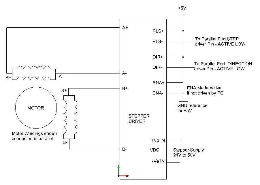

                                        Pictures and words..
                                        Neil said it – Your motor and driver will work fine if your software delivers STEP and DIRECTION pulse control to the driver.
                                        Connect up as these diagrams –
                                        The Motor winding are shown in parallel – connect in series if you wish and as Neil said, leave the center tap unconnected.
                                        Then connect to the PC printer port as below – your driver data sheet indicates that active low STEP pulses are required, so connect the printer port pin to the -ve PLS input. Connect +5V to the +ve pulse input, ditto for the DIR control.
                                        Joe

                                            You may not need the +5v Supply Dave. To know definitively I would need to know what the sense of the output Step pulse is, from your PC printer port.
                                            If your CNC software generates a positive going pulse ( your driver requires a pulse of at least 2us) then you can connect the PC port pin directly to the PLS+ input, and connect the PLS- input to the PC printer port ground pin.
                                            If however the sense of the pulse is low-going, ie, from +5v down to GND and up again, then you have to connect the PC printer port pin to the PLS- input, and have to provide a +5V source to the PLS+ input ( as in my drawing).
                                            If you have no idea either way, just connect the printer STEP output pin of the printer port directly to the PLS+ input, connect the PLS- input to the printer port ground, and try it! You do not even need to connect up the DIR+/DIR- inputs to the driver to try this – all that happens is that the motor will not reverse direction while testing…
                                            Joe

                                                  I won't go into the vagaries of full and half stepping and all the bog's that beckon …To go down that road we do need to know what Dave's software can actually do – else we just fill Dave's question with more complications before he even gets the motor to turn!
                                                  However, We are not yet done it seems..
                                                  Dave, my answer holds with reference to the need or lack of the +5V supply. As I said, if your software drives the pulse low-to-Hi, then just connect the printer port pin directly to the PLS+, with the PLS- at Printer Port GND.
                                                  This connection works because the printer port Driver IC can then supply, or source, the current needed to drive the opto-coupler in the Stepper driver input. If you already know this, forgive the following explanation –
                                                  Consider that the Stepper driver is looking for a 'contact closure' on the STEP input to provide a STEP command to the motor itself. Imagine that contact to be a relay contact, (instead of the opt-coupler it is..) and that the Printer port has to provide the current through the 'relay' coil to close that contact.
                                                  That can be done by grounding the 'bottom' of the relay coil, and supplying a voltage ( from the printer port pin) to the top of the coil. This would then be called "sourcing" the current to the coil.
                                                  Another way is to provide a separate voltage supply to the top of the coil ( the added +5V supply..) and then connecting the Printer Port pin to the bottom of the 'relay' coil. When the printer port pin pulls this connection to ground ( the same ground as the ground of the added +5V) supply), then current flows in the coil and the contact closes. This is termed 'sinking' the current to ground.
                                                  The fact that the 'relay' is an opto-coupler makes no difference – the end result is the same.
                                                  But be careful of grounds between the driver, the PC and the +5V supply, if used.
                                                  John Haine mentions a 'BOB' – this is a board that generally provides opto-isolation between the PC and the stepper driver and the rest of the CNC machine. It is not a bad idea to use such a board, as it does protect the PC to some extent, but don't get hung up on it just yet.
                                                  The Stepper Driver INPUTS ( STEP and DIR) ARE opto-isolated anyway, and the -Ve lead of the Driver main DC supply is normally NOT connected to ground or referenced to the STEP and PLS inputs. Just leave that ungrounded in the entire machine!
                                                  If using a separate +5V supply to source the PLS+ and DIR+ input current, connect the ground (-Ve) of that 5V supply to the printer port ground. A small Wall Wart giving 5V out at 100mA will be good enough.
                                                  DO NOT use a 5volt regulator to obtain +5V from the Stepper driver main DC supply! That will require that you connect the driver main DC supply -Ve to the PC Printer Port Ground. That is inviting trouble..The DC supply to the driver must go only to the driver – do not reference it to the PC ground.
                                                  Joe

                                                      Hi. I have been away from the computer most of the day, so the latest posts are a lot to absorb.​ I have scanned the data sheet for the motor and driver. If some one can tell me how to attach them to this message I'll upload them.
                                                      Joe, thank you for the lengthy explanation it will take me a while to absorb this and see what is relevant to my situation. As you have pointed out I may not need the 5vdc.
                                                      Here are the pin numbers to be used from the printer port supplied by the constructor.
                                                      Pin 8 to step.
                                                      Pin 9 to dir.
                                                      Pin 20 to grnd.
                                                      John Haines has raised a curious thing that bugged me when I ran the stepper motor as a bipolar motor. When indexing a full turn the indicator needle on my indexer did not return to the starting position. I'll leave it there for now.
