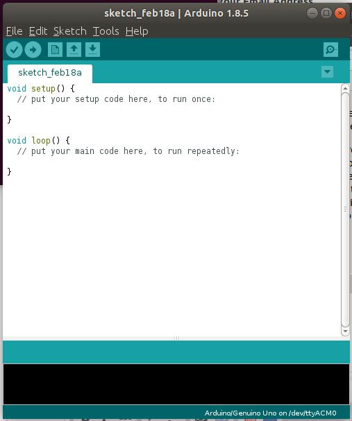

            More on Arduinos…
            Computers work with numbers stored in base 2, binary. All modern machines work with 8-bit numbers called bytes. An 8 bit computer processes single bytes, a 32-bit computer processes 4 bytes at a time, and a 64-bit computer works on blocks of 8-bytes. But under the bonnet TRUE, FALSE, integers, characters, floating point, inputs, outputs, instructions, flags, dates, times, internet addresses and everything else are all represented by bytes, either singly or in groups. The only difference between types of data is the way they are encoded, and the way they are manipulated by the programmer.
            Working with data at hardware level is outrageously difficult. As a result huge effort has been put into developing tools allowing ordinary humans to cope. Software tools allow problems to be expressed in human-friendly ways, then translated them into a form understood by a computer, and then loaded into the computer. Even though much of computing is about hiding detail and complexity, there is still a lot to learn. The Arduino is designed to get people started relatively painlessly and the software used to program it is free. It runs on Windows, MAC, or Linux. Also, if you don't want to download and install more software on your computer a Web based version is also available.
            All Arduino programs start with this default template:
            Bottom right shows an Arduino Uno plugged in to my computer has been recognised.

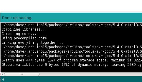

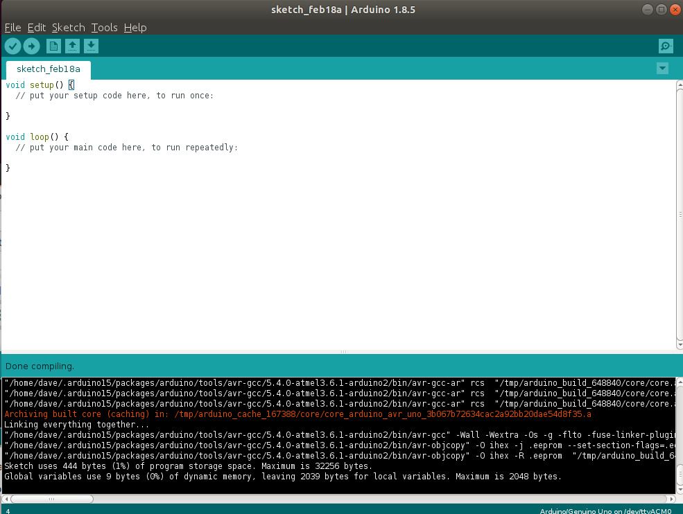

            Believe it or not the empty template is a valid program. Pressing the ✓button compiles the instructions in the template (ie translates) into code that can be downloaded into an Arduino, and which works. It creates two functions: setup() is called once when the Uno is powered up; then loop() is called afresh every time it finishes, forever.
            The lower pane (in black and white) shows no errors, and tells me how much space my program will consume on the Arduino, which being a tiny computer makes it necessary to keep an eye on this. (Note: normally the Arduino IDE is set to minimise detail in the lower pane, but it can be set to tell all, which is occasionally useful when debugging.
            Pressing the right-arrow button downloads the compiled program into the Arduino where it is installed and starts running. Success or failure messages appear in the lower pane again:

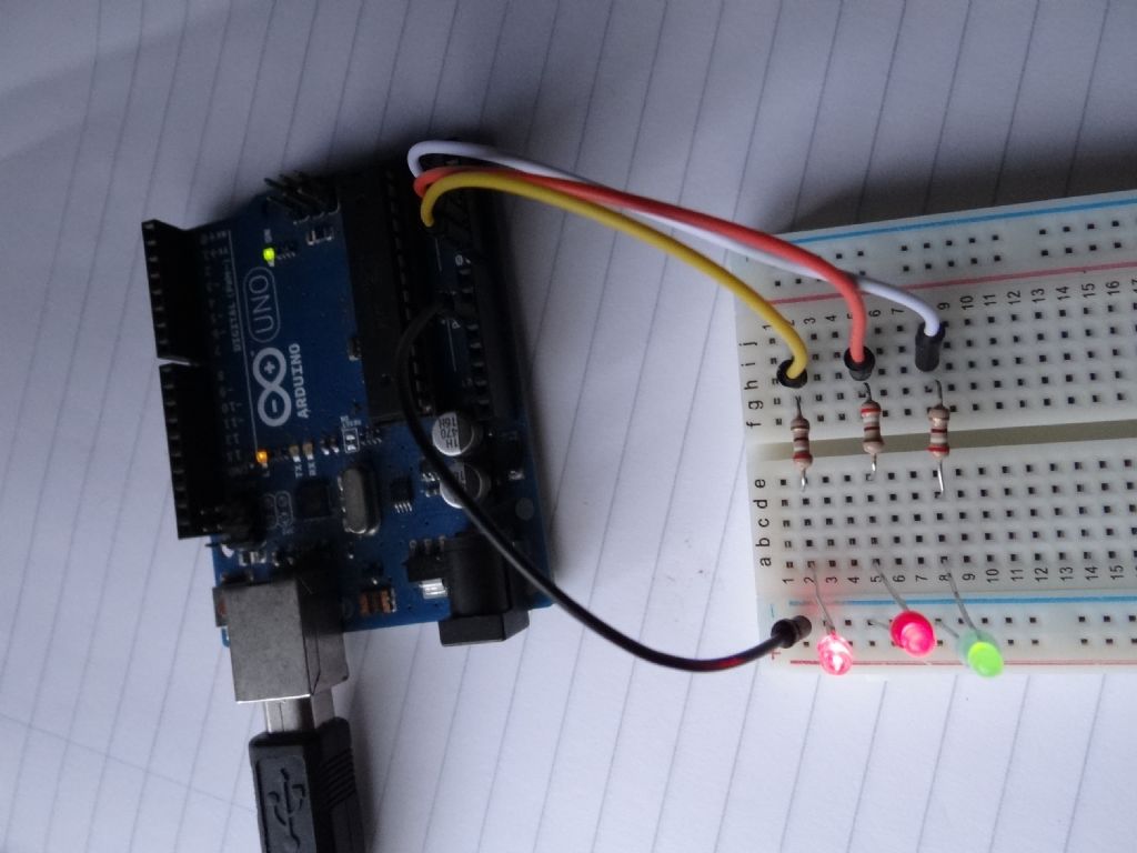

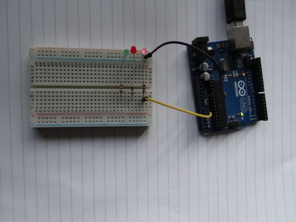

                    Before plunging into code, it's worth setting up the Arduino so we can see if it's working. Not necessary to connect it to a driver, motor and power supply at this stage, building them can be left until later. All we need do is test the signals output on pins A0, A1 and A2 are as planned.
                    The outputs can be tested with a multimeter, or an oscilloscope, but LEDs and a few resistors on a solderless breadboard will do the same job. These provide lines of connector strips into which components can be plugged to make temporary circuits.
                    All that's needed to test the Arduino program (or 'Sketch' in their jargon), is three small LEDs, with resistors arranged to drop 5V output by the Arduino to roughly1.5V on the LED. Any value between 220 ohms and 1000ohms should do the job. Boards and resistors available from ebay / amazon etc. Don't mess about sourcing three resistors – buy a selection box. Other values may be useful later. Ditto LEDs, get a small selection.
                    Plugged into the board and connected to the Arduino:
                    Not very clear in the photo but the Black jumper goes to a socket on the Uno marked GND, and the Yellow jumper goes to A0.

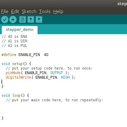

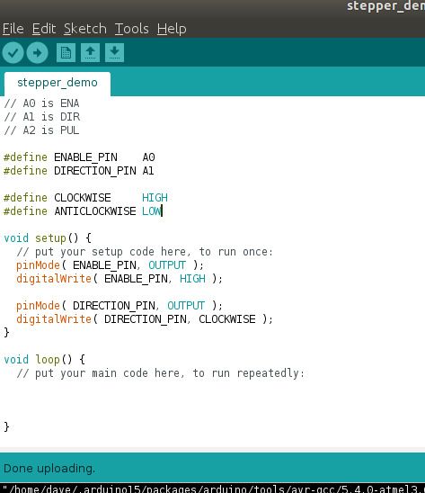

                    The pink LED connected to A0 (ie ENA+) is lit. This was achieved with these instructions:
                    Lines starting // are comments. Not used by the Arduino but helpful reminders for the programmer.
                    I could have used A0 in the raw, but instead "#define ENABLE_PIN A0" creates a meaningful alias. Not necessary In a small obvious program but a useful trick for complicated code, especially if you wrote it 5 years ago and can't remember how it works. It's easier to remember what ENABLE_PIN is than what A0 is connected to.
                    In setup() the program starts with a pin_mode() command that declares ENABLE_PIN (that is A0) to be an OUTPUT to be used later. This happens in the next statement: digitalWrite() is set HIGH, and 5V appears on the socket marked A0. It causes the LED to light, and it would enable a stepper motor controller when one's connected later.
                    Next, motor direction is set by adding similar instructions for pin A1:
                    I used #define to create meaningful aliases for CLOCKWISE and ANTICLOCKWISE rather than remember HIGH means clockwise. And if I get these the wrong way round and the motor runs in reverse, the problem is fixed at the #define – I wouldn't have to check every HIGH scattered throughout the code to see if was setting direction or doing something else.
                    As expected compiling and installing this causes the red LED to come on as well.
                    Coming next, the instructions needed to output pulses on A2, aka PULSE_PIN, and eventually to be wired to PUL+ on the stepper driver.

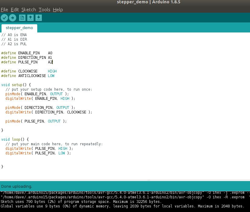

                        The program so far just allocates two pins as outputs and switches them on. As this is only one once, it's convenient to put the instructions into setup().
                        Sending pulses to the motor driver is a repeated operation and it makes sense to put the code into loop(). loop() is called automatically when setup() finishes, and it is called again each time loop() finishes. The instructions in loop() will be applied over and over again until the power is turned off. The logic in loop() typically does something like:
                        IF something_happened THEN
                        do this_function()
                        ELSE
                        do another_function()
                        To send a stream of pulses all that's necessary is to set an output pin to HIGH and follow that with another instruction to set the pin LOW. Each time loop() is run, it sends HIGH LOW to the motor driver.ard_pulsefast.jpg
                        Checking message pane shows the program has used a trivial amount of resources – there's plenty of room for expansion. (790 bytes used of 32256 available)

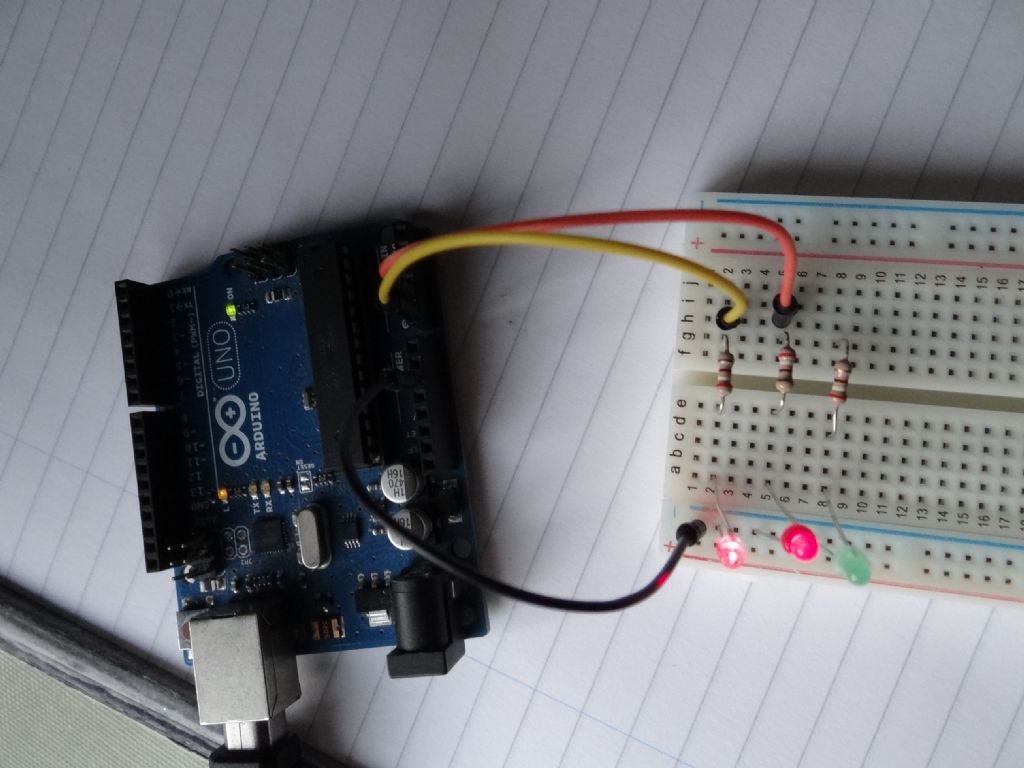

                        Now all three of the test LEDs on the breadboard are lit:
                        Not obvious in the photo but the Green LED connected to PULSE_PIN is dimmer than the other two. That's because it's ON for half the time and OFF for the remainder. The pulses are far too fast to see individually, but an oscilloscope reveals all:
                        The oscilloscope shows each pulse lasts 6.87 microseconds, and there are about 145000 pulses per second, each one of which would step the motor once. Assuming the motor, power supply and stepper driver could physically cope with that, a motor set to 200 steps per revolution would spin at 43500 rpm, and the same motor set to 6400 micro-steps would spin at 1359 rpm. In the real world, the electronics in the stepper driver might only be up to 50000 pulses per second, and – especially if accurate high torque stepping is wanted – a stepper motor should be run much slower than that. Voltage is important to the speed at which a stepper motor will turn reliably, as is the time a PSU takes to deliver a current pulse. (A supply designed to deliver 4A continuous might not be so good at 4A bursts.)

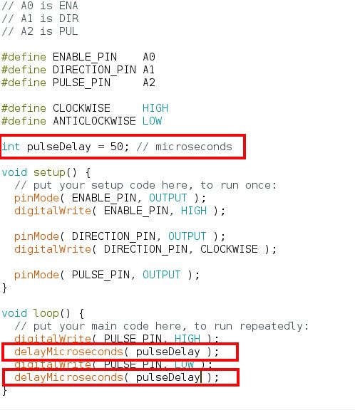

                          A slower pulse rate is achieved by ordering the Arduino to wait for a short time between HIGH and LOW. Changes inside Red boxes.
                          To provide flexibility, the delay is stored in a variable. That used, called 'pulseDelay' , is declared as a signed integer, which on the Arduino is ±32768. I set it to 50 and note they are going to be microseconds. Further down the code, the variable is used in a new function called 'delayMicroseconds()'. Given a number, this instruction waits for a time. The time delay could be hard coded into the program, but using a variable makes changing the pulse rate easy. For example to provide speed control.
                          Functions like digitalWrite(), delayMicroseconds() and many others are provided with the Arduino. They are fully described in the online documentation, with examples. There are also many tutorials available. The Arduino is programmed in 'C' (actually a variant of C++), and most of the standard C and C++ functions are also available, organised into 'libraries'. Functions can be written by the user, and there many user provided libraries as well. With luck someone else will have done most of the hard work for you already. There is a simple built-in stepper library worth looking at and a much more sophisticated library here. It adds features like acceleration which is needed to get the very best out of a motor. Not needed on a rotary table or head lifter, but a CNC application would benefit.
                          Arduino can also exchange messages with the host PC. These are useful for debugging because they allow your code to report the values it's working with, and you can check they're right. Next example adds a Serial link back to the PC and uses it to show that a switch INPUT has been detected.
                          Apologies for the first red box – it should be around the declaration below.  My mistake.
                          Second red box – this code adds the instruction 'Serial.begin( 9600 ). It opens a USB serial connection with the PC running at 9600 bits per second. Opening the Arduino IDE's built in terminal will connect to the Uno and the two can exchange data. There's no obligation to use the connection.
                          Also added is an unsigned long integer called 'pulseCount' set to zero. On an Arduino Uno, unsigned long can hold an integer between 0 and 4,294,967,296 In the next red box one is added to pulseCount every time a pulse is sent to the stepper driver.
                          The program also allocates A3, aka DEBUG_PIN, as an INPUT_PULLUP. INPUT_PULLUP makes the pin HIGH by default, and a switch wired to ground the pin can thus be detected. The state of the input is tested with digitalRead(). If the read is equal to LOW, the value of pulseCount is printed to the Serial line, and sent to the PC. Serial.print() doesn't throw a new-line on the remote terminal, Serial.println() does.  Beginner booby trap, '=' is an assignment, the equality test is '=='.  Don't mix them up!
                          If A3 is connected to ground, a stream of numbers appears on the terminal. Otherwise the program doesn't bother. Note that the time taken to communicate with the PC adds more delay and reduces the pulse rate slightly. Example terminal screen, yes it soon gets up to 2 million:
