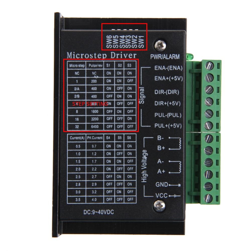

                                        Do you want to understand how they work, or just enough to use them? The former is difficult, the second a good deal easier. The same is true of most types of electric motor – not many on the forum could give you a detailed explanation of how AC motors actually work. Much more common is people who've learned enough to wire them up. I know this because I'm one of them.
                                        A basic stepper motor has two windings. The motor isn't fed ordinary DC or ordinary AC. It works by applying particular sequences of DC pulses to both windings.
                                        The motor doesn't turn smoothly, it steps. It can do one of three things per pulse-combination;

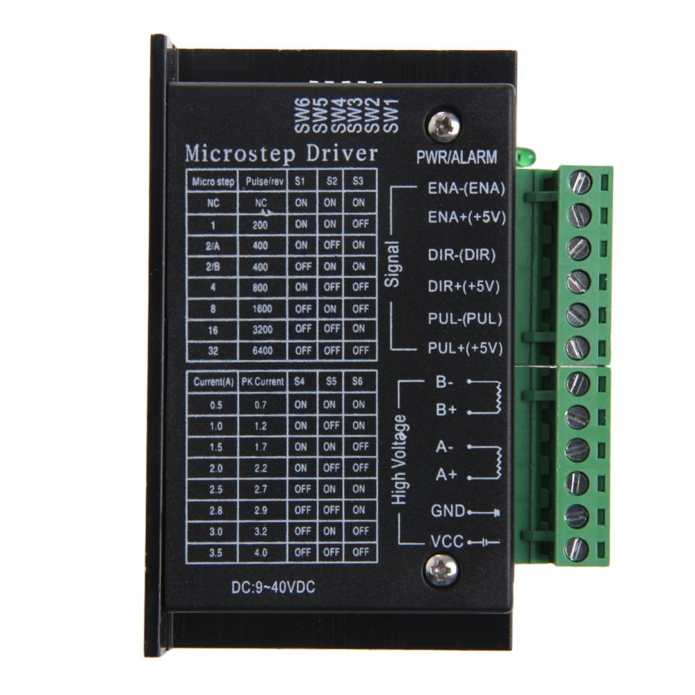

                                        #396394
                                          Part Two:

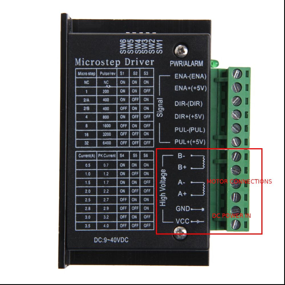

                                          Although intimidating at first sight, taken one at a time, the controller is rather simple to use. The DC Power Input and motor are connected here, in the red box:

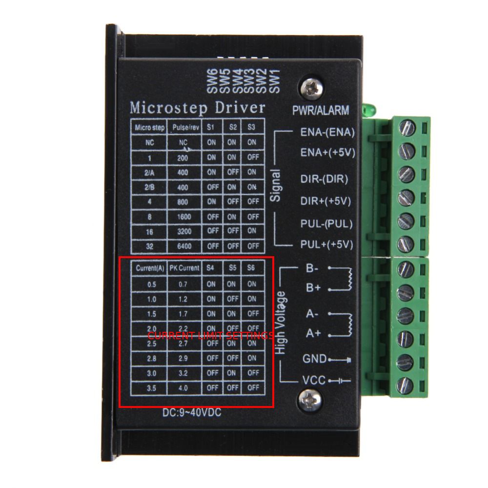

                                          This particular controller works with between 9 and 40V. Check your motor's specifications for it's upper limit but generally stepper motors will run 'better' fed a high voltage rather than a low one. But they work across a wide voltage range – it's the current that matters. For the same reason it's 'better' to use a crude unregulated DC power supply than a fancy regulated unit; regulated power supplies tend not to perform well driving pulsed loads. However, I didn't understand that when I built my rotary table and it works perfectly well with a cheap 12vdc regulated LED power supply.
                                          If you whack a lot of volts into the motor there's a risk of of heating it due to exceeding its power limit (again see spec for the maximum current a particular motor will take.). To avoid damage the controller provides switches (marked SW1 to SW6) that can be set to limit the maximum current delivered to the motor. Given an unknown motor, you can start with the lowest setting and move up the range until the motor works properly, ie turns without losing steps.
                                          The number of micro-steps needed for the motor to do a full revolution motor is set in the same way. The ends of the switches can just be seen in the red box at top of photo. The number of micro-steps is a compromise that depends on the application. Generally it is set to the lowest number of steps needed to achieve the required step accuracy. No point in simply going for the maximum number of steps, because there is no such thing as a free lunch. At high micro-step settings the motor is more likely to lose steps under load and the rpm is lower.
                                          Finally the control connections. These occur in pairs working in the opposite sense to suit the electronics used to control the controller.  By convention these can either signal 'ON' by putting 5V on a connection, or signal ON by grounding a connection that has 5V on it already.
                                          ENA is enable. The controller won't power the motor unless this is ON.
                                          DIR is direction. When ON, pulses are generated to turn the motor clockwise, when OFF the motor turns anticlockwise.
                                          PUL is Pulse aka Step. Each pulse applied to this input moves the motor one micro-step.
                                          ENA and DIR can both be set with ordinary on/off switches but PUL requires a stream of pulses. These could be generated with a simple chip like the NE555 and a speed pot.  More likely something sophisticated like an Arduino or PIC micro-controller would be used. They can be programmed with whatever the user wants to do. For example, an Arduino could calculate the number of pulses needed to rotate the motor by an angle input by the user, then enable the motor, set direction, issue the right number of step pulses, and then dis-enable the motor. By keeping count of pulses and direction changes the micro-controller always knows where the motor is. A more sophisticated controller could translate G-Code to drive several stepper motors on a CNC machine. Controllers can be bought ready made in various shades of complexity.
                                          What could possibly go wrong is another question!
                                          Edited By SillyOldDuffer on 15/02/2019 12:03:46

                                                To power the motor, I used a cheap ebay/amazon PSU as sold to drive LEDs. Not ideal for stepper motors but easy to get:
                                                These are available in various voltages and power outputs. Get one with watts to suit your motor. I used a 12v PSU on my table; although it's fine a 24V supply would have been better.

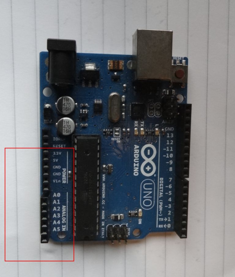

                                                Next wiring an ArduinoUno as a controller. It's job is to ENAble the driver, set DIRection, and PULse the motor, ie tell it to step. Though this can be done with conventional electronics, it's more flexible with a small computer like an Arduino. But swapping conventional electronics for a computer means learning how to program the computer.
                                                Wiring the black box driver to an Arduino is simple, this shows signal HIGH = ON, LOW = OFF:
                                                ENA-, DIR-, PUL- all connect to GND on the Arduino, leaving + signals doing the controlling. ENA+. DIR+, and PUL+ are each wired to an Arduino input-output pin. There are 20 of these, some with special characteristics. Pins A0 to A5 (red box below) have extra analogue capabilities, but this circuit uses them in bog-standard ON/OFF mode.
                                                Connections to a UNO are made by plugging breadboard jumper leads or pin headers into the sockets. Headers need soldering. If soldering is preferred go Nano, they're cheaper.
                                                When an Arduino is plugged into a PC, it's powered by the PC. However, you might not want to power it that way in a workshop. Instead either plug the Arduino into a USB telephone charger, or buy a wallwart in the range 7 to 12vdc to plug into the black socket top left. 7.5Vdc preferred.
