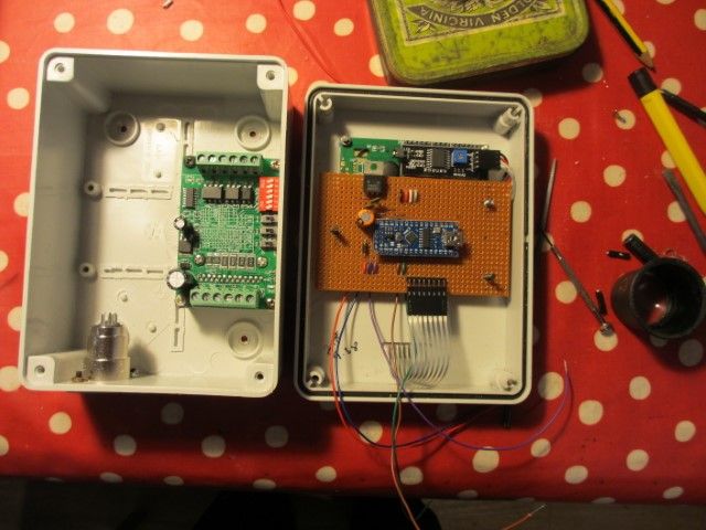

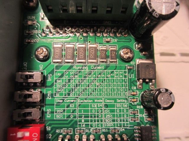

      I'm building an electronic dividing head, pinching ideas from contributors to the forum, principally John Haine for the mechanical design and Silly Old Duffer for the electronics. My stepper driver is as photo. I think that 'excitation mode' means microsteps, and Stop current is the current through the motor whilst it's not moving. I also think "1" means on. Can anyone confirm? Any idea what I should set Stop Current to? Any idea what Decay Setting is, and what it should be set to?
      Last thing I want to do is release the magic smoke!

        Martin Kyte
          @martinkyte99762
          Excitation is microspepping as you say. Stop current would be standby or holding current when not stepping. Set as low as you like to provide enough of a 'detent'. It's a worm drive so it's unlikely to move anyhow.
          Don't know about the decay setting. I'd set it to 25% and see how you go. (tune for minimum buzz and check you are not losing any steps. What's the part number?
          regards Martin

            It's one of these TB6560

            I.M. OUTAHERE
              @i-m-outahere
              This link will explain what fast , mixed and slow decay rates do .
              **LINK**
              i think you will find 25 or 50 % will do you for a rotary table .
              1 is on 0 is off ( they are using the 0 and 1 as used in logic instead of off and on ) .

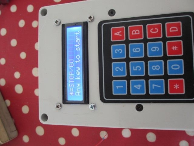

                Today I finally got all the loose ends together, joined the various bits and switched it on. Surprisingly it worked first time. Now to fit a motor to a rotary table. Watch this space.
                Thanks to all who came up with the mechanical and electrical design, and helped with setting up the driver board. Here's a photo of the completed boximg_3557 (small).jpg

                    There's a well documented issue with these inexpensive stepper driver boards., The fact is the designers of those boards did not follow the recommendations set by Toshiba for the power-up and power-down sequence.
                    There are other minor design faults but this is the one that can lead to total TB6560 failure.
                    In simple terms the logic (5v) supply onto the IC should be established and stable before the stepper drive voltage is applied to it and should be maintained until the stepper drive voltage is removed . These boards derive the logic voltage from the higher voltage via a 7805 (or similar) making this impossible as supplied.
                    There are mods that can be done to overcome this problem but they involve cutting of PCB tracks and the construction of a delay module.
                    The solution to the issue may be to hand by using spare pins of the Arduino, a MOSFET and a few more lines of code.
                    In depth discussion here. https://www.cnczone.com/forums/stepper-motors-drives/139306-can-tb6560-driver-design-violate-chips-specs.html
                    Good luck
