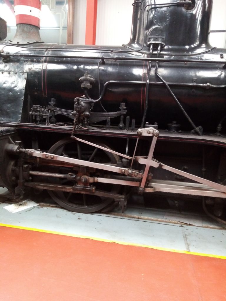

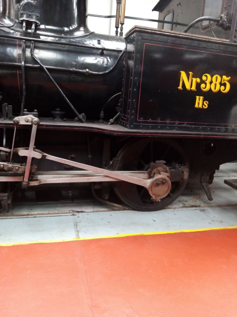

        There are examples of die up for forward running with Walschaerts but are there any examples of link up for forward with Stephensons? Duncan might know.
        Also, I don’t understand why the correct drive line is different for loco and launch links. They are not that different. Don’s book shows the preferred arrangements but doesn’t really explain why, stating that the preferred arrangements limit die slip.
        I am designing outside Stephensons for Simplex, just for something different, and even raising the cylinders slightly and angling them will still have the launch link only 3/4” off the rail head in full gear.

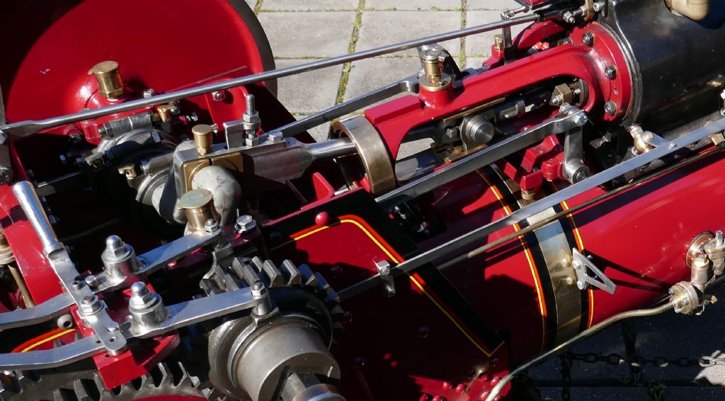

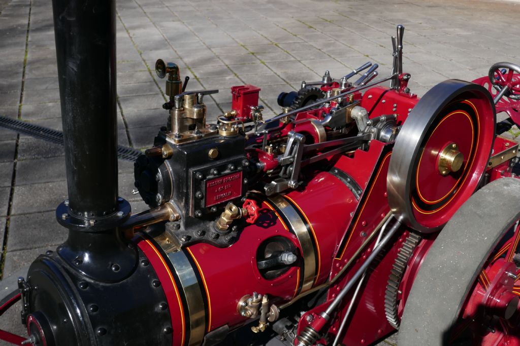

          On my Ruston Proctor engine, the quadrant link is up when going in the forward direction. If is was assembled in the down position it would just be a matter of swapping the connection of the links to the eccentrics to go forward.
          A difference with the Ruston, compared to some other engines is the control lever points up where others point down.

                Most traction engines (Three Shaft Engines) run link down to save wear and tear on the lifting link pins, on a Four Shaft Engine which the crank shaft runs backwards, in order to get the link down in forward gear the eccentric rods have to be crossed.

                  Thanks for replies and pictures. TEs usually have links end suspended so already are sub optimal from a locomotive point of view.
                  I have put my numbers in Don’s spreadsheet and next will be the Wallace simulator. I played around with the program example for Stephensons 2 making link up forward but it deranged the events. I did not persist. I agree that 3/4” clearance is probably enough (the cylinder drains are much lower) so easiest to go with convention. Reassuring to learn that Polly links are quite low.

                                    The Lewin locomotive "Erith" had outside Stephensons operating through a rocker, but I'm not sure inspiration is quite the word for it. **LINK**
                                    This photo of the RHDR locomotive "The Bug" might be more useful as it shows the valve gear layout very clearly **LINK**
