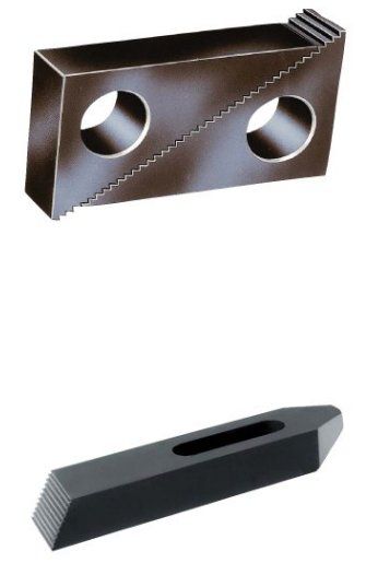

      Every time I mill something with clamps I have mixed feelings about the clamps I have. I really should get some step blocks but while looking around I saw these clamp plates that can be used directly on a step block.
      Any one tried them? I'm happy the blocks with normal clamps are ok so can't see why these wouldn't work out.

          That's the sort that came with my big clamping set, I use them with no problems – although they can be tricky to set up as they can take a lot of space and have 'big noses'. .
          I've got the 12mm slot 58-piece set here: http://www.arceurotrade.co.uk/Catalogue/Workholding/Clamping-Sets
          (Except in red!)

                The only problem I could see is the limited angle range to keep the steps locked together with no chance of slipping.
                Neil makes a point though. The one is the shot are 25mm wide – how wide are the arc ones? I would be looking for M8 – m10 slot for my dore westbury.

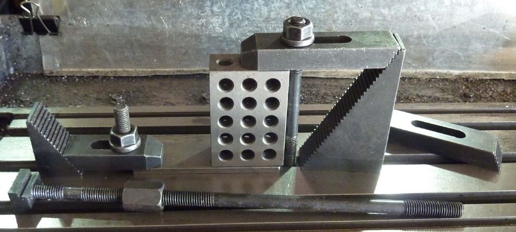

                    Hi John,
                    Not sure of what you mean by " limited angle range to keep the steps locked together with no chance of slipping". I use my clamp set all of the time and have never had one slip. A must have if you are mounting jobs on the mill.
                    They have M10 bolts(screws ?) and has a set of blocks which can hold items up to 90mm high. It comes with a range of bolts of varying length up up 180mm and some extra long nuts for joining two bolts together. Spacers can be positioned under the step blocks if they are not high enough.
                    Paul.
                    Edited By Paul Lousick on 15/08/2015 00:43:43

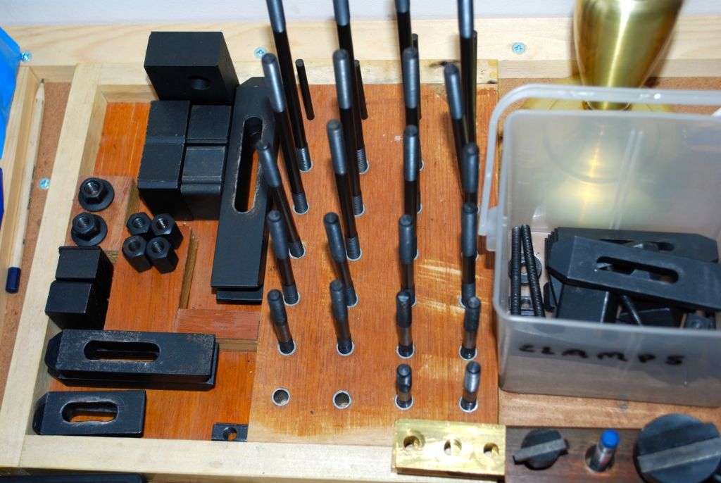

                            Hi John
                            I couldn't do without mine and they are very easy to use..
                            There are more of the same missing here in the photo as there is something set up on the mill.. (The studs are different lengths)..
                            I think I paid about £50 for the set, may have been a bit more but not much…

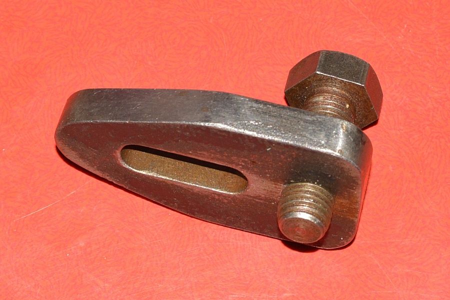

                                              I have the problem of buying a retired toolmakers dore westbury. He made just about everything himself. I've managed with this type so far and I can understand why he made them – they can be rather expensive to buy. They are heat treated, 3/8 thick and 3in long. There is also some smaller stuff.
                                              As these work rather well I didn't really want to buy a set but the prices buying bits and pieces work out far more. He made a number of clamping bits and pieces for it but the studs are a bit of a mess. I could fix that via high tensile all thread. For some reason he settled on 5/16 bsf for studs. The T slots may be metric, M8 I suspect but M6 is available in the same size of T. I'd guess he had something else about and 5/16 fitted both. It's easy to make T nuts, a strip at a time and then saw them off.
                                              The reason I wondered about setting the height on the step blocks and the angle range of the stepped clamp is that I did use the blocks briefly and from memory the steps are angled so that they pull together rather than slide apart. I assume the clamps with the steps on the end are the same so past some angle they wont pull together. When the clamp isn't level spherical washers should be fitted as well but I suppose that's really only needed for rather powerful millers but suspect I might get some of those.
                                              T nuts are sold threaded all or part way through but at a couple of quid plus each where I have seen both styles offered I don't think I will be buying any,
