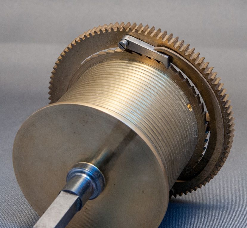

                      As I posted previously I think the grooves are a spiral thread – a system used in weight driven clocks from an era long before anyone thought of model engineering! (Or maybe before the Stent was a twinkle in it's designer's ancestors eye)
                      Here, as they say, is one I made earlier!
                      Cheers Norman

                        Many thanks for the advice. I don't think the Woodward design included a spring tensioner but I like that idea. I will try the grooves as per the clock barrel and I was only thinking of a few turns.
