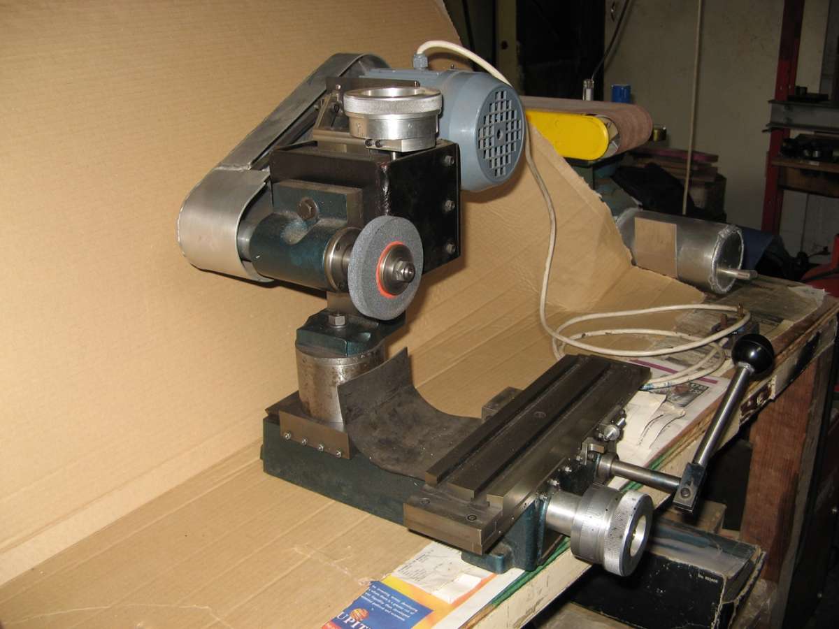

                        That MEW article illustrates this pattern, built by A. S. Gray. His is of otherwise “standard” layout so the cutter-holder is on the end of the table, and completely overhanging the bed – though to be fair I think he may have moved it further than normal so as to show the wheel more clearly. Another difference is that his grinder’s table has just one T-slot, offset to the front. Mine has two, symmetrically disposed.
                        By contrast, Mr. Parkes’ Stent has its motor mounted quite low down and well out to the back of the machine.
                        However you do it leads to large cantilevered loads on the column, but they all seem to work very well!

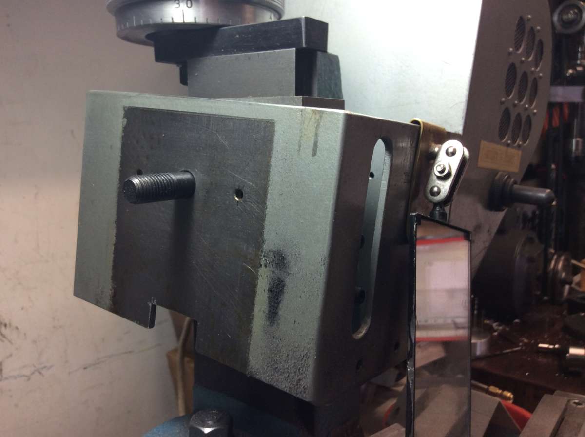

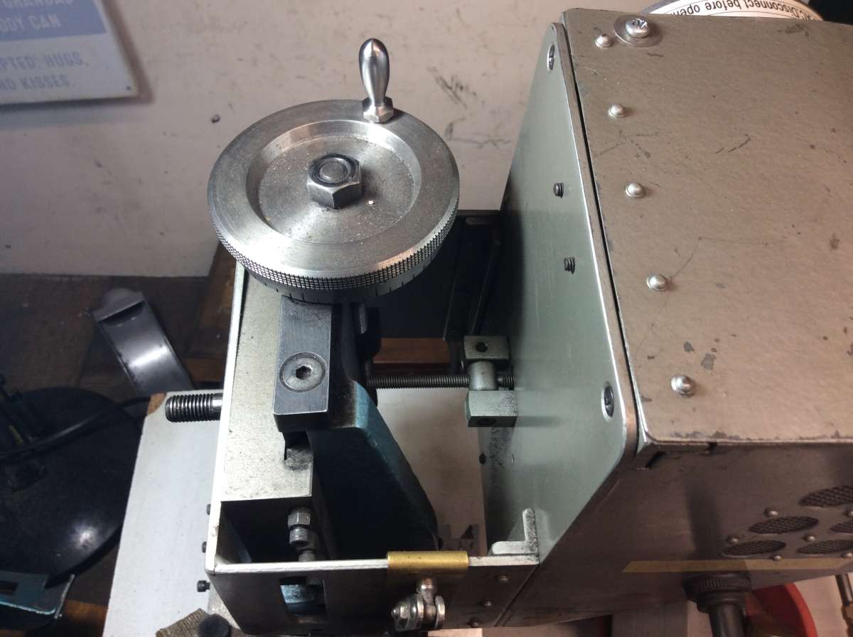

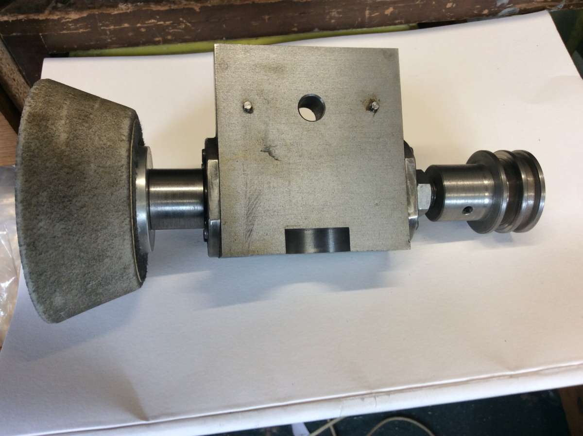

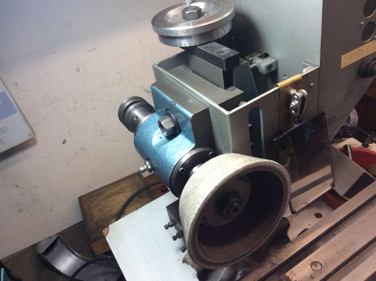

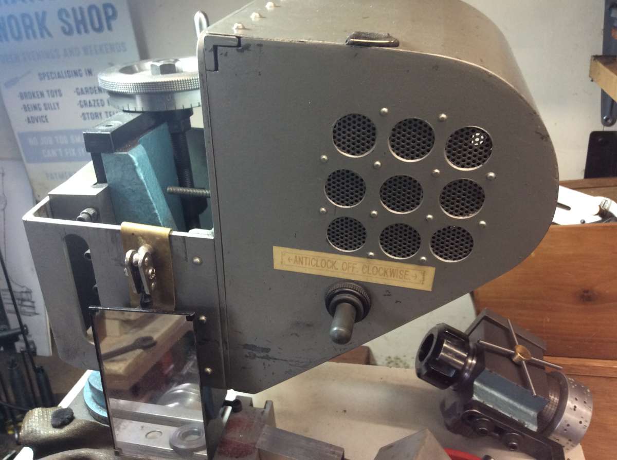

                          Here’s how I made mine. I have made a “box” that keeps the motor and spindle in line. Also a raising block to enable a magnetic chuck for ginding tappet shims and other thin plate.
                          Yes it can be made with the spindle to the left or the right of the column. Which is correct??
                          Cheers

                            I think the original design was with the wheel on the left because it was a sort of copy of the Clarkson but that has the ability to slew the table round to the left of the column. So later builders thought it would be better on the right more above the main bed. However that is not necessarily good if you have a long tool mounted say in an air bearing on the right end of the table.

                              I would not like to say which is “correct”. It may depend on what you envisage sharpening.
                              As Bazyle says, the original does have the wheel to the left of the column but that can lead to the table having to be well over the end of the bed in ordinary use, so some constructors have reversed the layout so the wheel is roughly over the middle of the bed.
                              That right-hand version would probably suit most users, including me, sharpening ordinary milling-cutters, reamers and the like. If you are likely to be servicing more exotic tooling such as his air-bearing mounted ones, you might well want to modify the machine further to suit your own needs.
                              I note the protective rubber cover on your grinder. I have found butyl pond-liner good for this, having a sizeable piece left over from making luxury accommodation for my garden’s frogs. I used a piece rather as you have, on my milling-machine.
                              That’s a neat box for the motor mounting: a welded fabrication?
                              I am going for the right-hand version in completing my grinder, and made a couple of small parts tonight.
                              I also completed the Guide & Guide Arm – two pieces glued together. Well, glued if you don’t accidentally make them a bit slack as I had. Slight countersinking and peening, plus the recommended ‘Loctite’ , sorted that, then a light touch on the the lathe and some modest draw-filing gave it a tidy finish.

                                Nigel,
                                “That’s a neat box for the motor mounting: a welded fabrication?”
                                The U section is welded plate and the part across the top is a flat plate with angle bar welded each end to allow it to be bolted together. It is fixed to the spindle bearing mount by countersunk screws.
                                I also use a revesible motor and I have two spindles, one LH thread and the other RH thread. And another spindle which is extended to reach the mag chuck.
                                Here’s another pic from the top. And yes the bench does need a clear out!

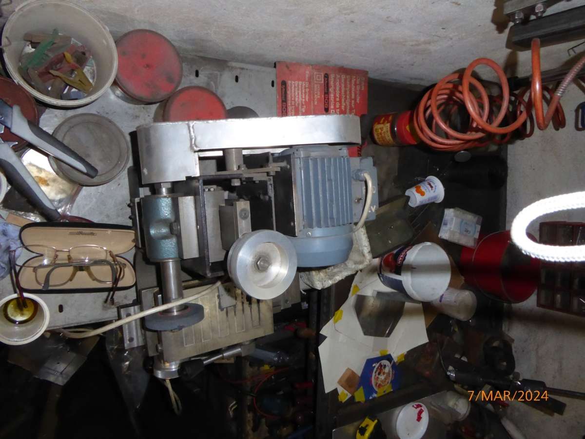

                                bernard towers
                                  @bernardtowers37738
                                  Going back to my post on the 4th I said about using angle but mine only has angle on the right hand side (motor side) the left hand is sif bronzed to allow more tilt of the wheelhead if necessary . The bearing block has two pins added to keep the relationship between the head and motor.IMG_3486IMG_3485IMG_3487IMG_3488IMG_3489

                                    That’s very neat and impressive work, Bernard!
                                    I now have the motor, sitting on the table on one side of the computer.
                                    The grinder is slowly taking loose-assembly shape on a stool on the side side.
                                    The original design has the motor way out to starboard of the column, on the opposite side to the spindle and approximately level with it. As I am making mine with the central spindle, the motor will be off to port. That basic layout seems to make the machine very unbalanced with a large overhung load on the column mounting, so I see other you and other constructors have inclined the drive to bring the motor closer to the column.
                                    I’m catching up on finishing all the bits up to column-top, then once I have assembled the basic machine I can decide on how to mount the motor, and your approach is a valuable guide!
