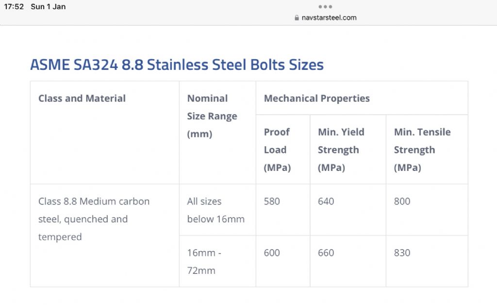

                        Posted by Robert Atkinson 2 on 01/01/2023 17:31:27:
                        "8.8 stainless steel bolts" is an oxymoron.
                        Robert.
                        Oh dear … that’s unfortunate:
                        https://www.navstarsteel.com/grade-8-8-bolts.html#sizes
                        Edited By Michael Gilligan on 01/01/2023 17:58:52

                                  Posted by Michael Gilligan on 01/01/2023 17:58:13:
                                  Robert.
                                  **LINK**
                                  Come back to me when you have a tracable source. That table is titled "stainless steel" but the content says "carbon steel". ASME SA324 does not exist. It is a supplier website of dubious veracity.
                                  An 8.8 bolt is by definition high tensile steel. Minimum tensile strength 800 MPa. Stainless steels are lower than this, typically 500 to 700 MPa for common grades. A4 is used for some fasteners and is available in 800 MPa minimum tensile strength (A4-80). However this does not meet the 660 MPa minimum yield strength of the 8.8 specification.
                                  Robert.

                                        Posted by Robert Atkinson 2 on 01/01/2023 22:10:55:
                                        Robert.
                                        Hence my comment, Robert
                                        I have no intention of ‘coming back to you’ … I was simply quoting something unfortunate.
                                        P.S. __ You might find further entertainment on this page:
                                        https://www.steelmetind.com/high-tensile-grade-8-8-bolts.html#chemical
                                        Edited By Michael Gilligan on 02/01/2023 09:23:15
