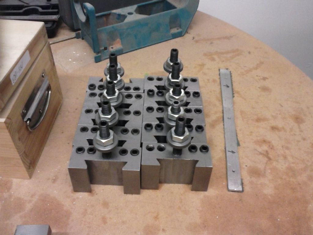

          I made a bunch of these a while back.. ordinary cold rolled bar. they seem to work fine.

            I used ordinary black mild steel to make my toolholders. They might not last as long as hardened toolholders, but when they afre worn I can just make some new ones.

              You won't wear them out if you use black rolled bar. Avoid "O1" ground stock it is not easy to machine and expensive for no real gain.

                          Any old steel to hand will do. I've even got 5 in aluminium (ran out of steel stock)…
