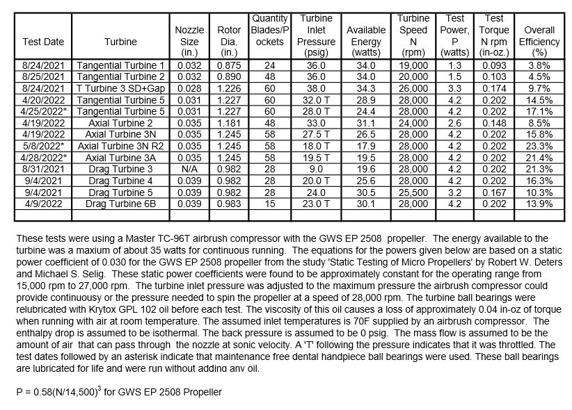

                                        #609612
                                        Turbine Guy
                                          @turbineguy
                                          Hi Martin,
                                          My Model Turbines thread has testing of various types of turbines with results like shown in the following table. There are albums for each of the turbines shown in the table so you can see photos of the parts and drawings showing some of their dimensions. I do my testing mostly with air but have a few tests with steam. There are a lot of pages in this thread describing the design, construction, and testing of several types of turbines and small steam engines for comparison.
                                          I hope you find this helpful,
                                          Byron
