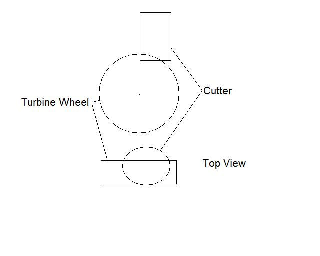

                      The ‘Jeggli’ type DeLeval is not so difficult to make.Each blade is curved.The inner curve (on the inner edge of the blade) has a larger radius than the outer radius.I used to make two cutters by drilling a suitable bit of silver steel and then mill or file saw like teeth on the end to make a tiny hole saw.You set the thing up as shown in the attached crude drawing.As you will see most of the saw clears the metal blank
                      The ‘outside hols saw’ is made similarly but has a smaller radius than the Inside saw. It cuts the outside radius of the blade.It will have to be made and set up by eye.However in the small sizes 20-40mm diameter the outside of the blade is not so important.

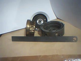

                                TerryD Sorry for the delay in responding to your query. The buckets on a Stumpf turbine are ‘U’ shaped. The steam (or air) is directed down one side of the U and goes round the bottom of the ‘U’ and out the other side. A Pelton wheel which is specifically designed to work with water which has a large ‘Head’ but smallish volume. Its buckets are a ‘W’ shaped. It is a sort of double Stumpf.
                                There is one point about the Stumpf wheel. It was used on most air driven Gyroscopic aircraft instruments. The instrument’s case was ‘airtight’ and was evacuated by a venturi mounted outside in the airstream. Air was allowed into the casing through one or generally two nozzles. This simple arrangement gave them enough speed to do their business, but no power was drawn from them. From memory they were generally over 2 ½” in diameter and often over ¾” wide. The buckets were milled quite deep (well over 1/8” deep) and relatively few in number.

                                        This is the inside of an aircraft gyro, it has 24 buckets 1/2″ across, and 1/16″ deep. There are 2 inlets, 180 deg apart. Great what you find in the junk box. Ian S C
