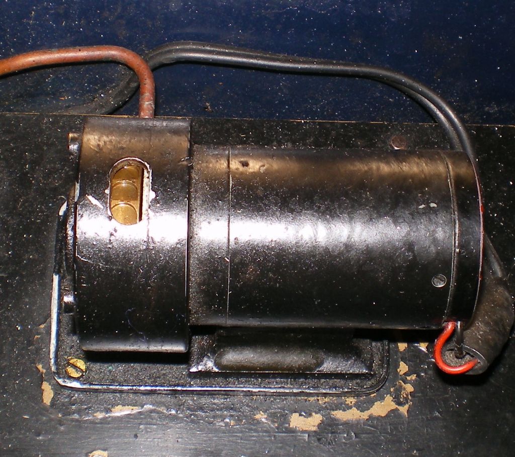

      James,
      Thanks for the photo. Your model certainly shows that it’s not necessary to use blades with difficult shapes to get a working result. If your turbine produced several watts then that is an impressive performance.
      Could you tell us please how the steam enters and leaves your rotor? I can’t tell from the photo.
      And, could you please give some details on the motor? The power of 36 Watt would seem to imply quite a large motor.
      Thank you
      Paul

                Hi Paul
                Sorry I forgot about the in and out.
                 The steam or in this case the compress air enters by a 1/8 hole at the top left hand side and out at the bottom right.
                There were two more units one with 6 blades and the last with
                4 and they were all on the one shaft. The air (steam) would enter the
                first then into the second and the n the last.
                The motor is just a standard motor that is for R/C cars so has a lot of out put for it’s size.
                As you an see from the photograph the winding are quit large for the size of the motor.
                James.

                  James,
                  Thanks. I have looked up this motor and found this data, and a lower price!:
                  Mtroniks Vision 500 Marine >>
                  Mtroniks Vision 500 is a 540 size Johnson motor
                  This 540 sized Johnson high speed motor is ideal for marine use. Unit comes complete with motor suppresion capacitors.
                  Dimensions :
                  L57.0mm
                  D36.0mm
                  Shaft diameter 3.0mm
                  Voltage, 12V
                  Off load current, 1.18A
                  Max current, 54A
                  RPM, 16500RPM
                  Part No: V500M
                  Price: £4.99 (Including VAT at 20%)
                  This could be what I am looking for. From the data above I can calculate the performance as a generator and see if it could match the turbine. The speed is one of the highest I have found. I would then have to design a robust coupling and frame to hold the turbine and motor together.
                  Thanks for the help
                  Paul
