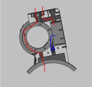

      Bom Dia.
      Tenho uma dúvida. Se o meu desenho cad do bloco de cilindros estaria certo com as entradas de vapor e suas saídas, ou seja, a estrutura interna do bloco.
      Att Matheus Ferraz, um brasileiro.
      Mods Translation
      "Good Morning. I have a doubt. If my design cad of the cylinder block would be right with the steam inlets and their outlets, ie the internal structure of the block. Att Matheus Ferraz, a Brazilian."

          You look to have things about right.
          It is more usual to have the steam passage up from the boiler to enter a chest at the top of the cylinder and then have a separate passage down from this chest which is covered by the "regulator" so that the flow of steam can be controlled before it enters the valve chest. The top cover of this regulator chest can be used to mount the safety valve and a whistle should you want one.
