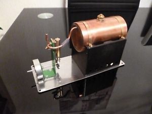

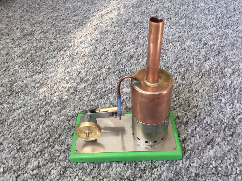

                  Re pipe size ,for my smaller models I use 1/8” dia copper tube with a 22 gauge wall thickness.Bends easily without kinking.For connection use thick wall silicon tube as used by the aero lads for ic engines.No it won’t blow off if you consider how low the pressure is in the pipe.

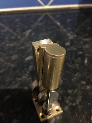

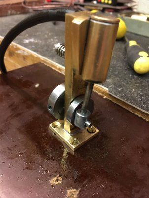

                      As a matter if interest, I had to make a second cylinder/port-face assembly for my Slim Jim – the first, made in accordance with the drawings, had a design error – you can see what it is in the pic below. A valuable lesson to check plans/drawings carefully before proceeding – it should have been obvious to me, but I naively assumed published drawings must be right.
                      Problem simply solved by using a wedge-shaped port block so that ports were still covered at 'full swing' and at my embryo stage it's all good practice. Spotted the problem on first assembly, second assembly with modification ran immediately on compressed air without tweaks or fiddles so I was very happy.
