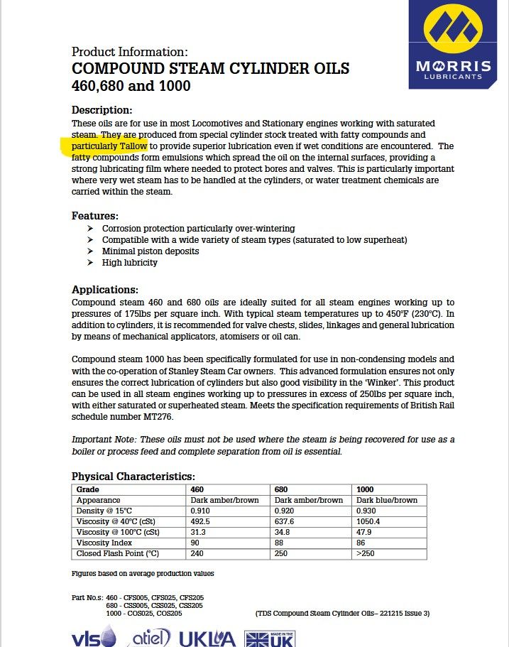

                            Not quite correct, Tallow is still used today:-

                              Steam oil today still most often contains tallow, as its makers and sellers proudly proclaim. Sometimes it is referred to as fatty oils or fatty compounds, other times as tallow. Here are two of many examples. LINK LINK  (Edit: As Nick posted above while I was sweating over a hot keyboard.)
