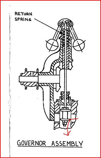

                                By proper I mean 1000hp plus, I'll let you get away with throttle governing on a traction engine. I can't find the diagram of basket seat, so I've done a hand drawing and scanned it. Basically steam can get past the top seat then out through the holes in the side of the tubular bit of the seat, it can also pass down the centre of the bobbin, then do a 180 degree turn past the bottom seat and out through the holes again. The bottom plate of the seat is solid, just has a guide bush for the bobbin. The bobbin has a spider to connect the outer bit to the bit which fixes to the spindle. The downside is that for a given flow area the valve has to be a lot bigger diameter than one where steam is fed to the undersifde without going through the bobbin.

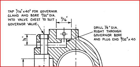

                                #308171
                                Anonymous
                                  Thanks for the diagram. It's unfortunate that the way my cylinder block is designed there simply isn't any room for proper balanced valves, of any sort, and the associated valve seats.
                                  Andrew
                                  #308208
                                  Anonymous
                                    Here are my calculations on the steam flows in the cylinder block. Clearly I've made a series of assumptions, which are probably pessimistic in practise, but the intention is to get order of magnitude answers as to whether the engine will be choked by inadequate steam supply.
                                    Although the engine is a compound we only need to consider the HP cylinder. I'm not going to worry about the case of the simpling valve being open. The HP bore is 2", stroke is 3.75", and I have assumed 500rpm as a maximum. Although I haven't designed the valve gear yet I think that a maximum cutoff of 75% is reasonable.
                                    So the maximum volume of steam per revolution is:
                                    2 x pi x r² x stroke x cutoff
                                    The volume is times 2 because the engine is double acting. I make the answer:
                                    17.67in³
                                    and per minute, times the maximum rpm:
                                    8835.7in³/min
                                    The steam passage to the valve chest is 9/16" diameter, so how long would a 9/16" diameter cylinder be for one minutes worth of steam? Basically the volume of steam divided by the area of the steam pipe. I make that:
                                    35555in or 2963ft
                                    So to provide the necessary volume of steam said steam will need to be travelling at 2983ft/min, aka 33mph.
                                    That's quite a conservative value compared to the 5000ft/min recommended by some older textbooks, and modern steam engineering recommends even faster flows. Presumably because that gives smaller pipes, equals cheaper to install.
                                    So on the basis of the above calculations it seems that the engine is unlikely to be choked with a 9/16" diameter supply area. I just need to make sure that the same area is maintained, or exceeded, through the rather complex steam passages in the cylinder block. The passages are under my control as there are no cored passages in the block as supplied.
                                    Andrew

                                          Martin Johnson 1
                                            @martinjohnson1
                                            Hello all,
                                            I have only just come across this post, but hope I can shed a bit of light.
                                            First, the theory, Imagine a graph of governor opening up the left and speed across to the right. To govern you must have a curve that falls from left to right. To get isochronous governing, you need a curve that is a vertical line at the desired speed. In practice the best we ever get is a very steep slope – even on electricity generation work. As Andrew has derived in his post of 15/7 you need to get the springs and masses right, otherwise you can get instability (hunting), when the curves described above on the opening / speed graph become a Z shape.
                                            In practical terms, for a given mass of balls (bit like this post) you need the correct spring RATE. Changing pre load will change the set speed, but does nothing about stability or instability. You will also appreciate that to get some degree of governing with a modest speed variation is in theory achievable, but to get good governing you are trying to create that very steep curve, while avoiding creating a Z curve.
                                            Everything that has been said about increasing forces by increasing rotational speed, and ball mass is correct and will give more actuating force.
                                            The Filby design is dire, in that the governor is expected to move a cylindrical plug with 160 psi pushing it to one side – think if the stiction! On the 4" Burrell SCC, I managed to work in a scheme of drillings to achieve what Duncan has sketched above. I then very carefully made a wee bronze cage loctited into the block and a stainless bobbin,. After many years of further work, I was able to see if it would restrict speed. Under "no load", it didn't.
                                            After 10 years of running the model, the governor drive pulley always has a load of oil on it – so I concluded that trying to drive a governor with a flat leather belt was probably a non starter.
                                            Taking those two factors into account, my enthusiasm for working governors rather died. However, I have the world's only model of a Burrell Patent Dustproof governor – but without the internals completed. I then decided to build a 7" scale steam lorry, but that is another story………….
                                            If you can do it, Andrew, I will be the first to applaud, but please don't get trapped down that avenue – I want to see your two engines in steam – governor or not!
                                            All the Best,
                                            Martin
