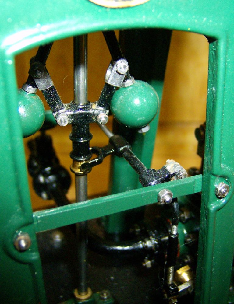

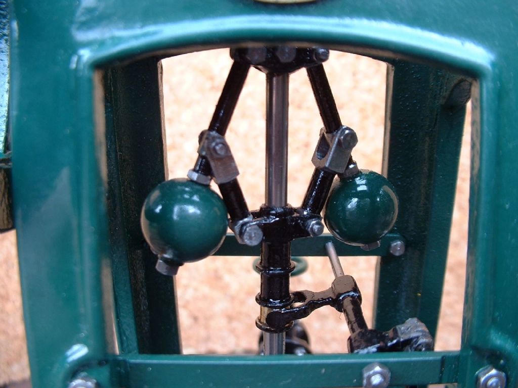

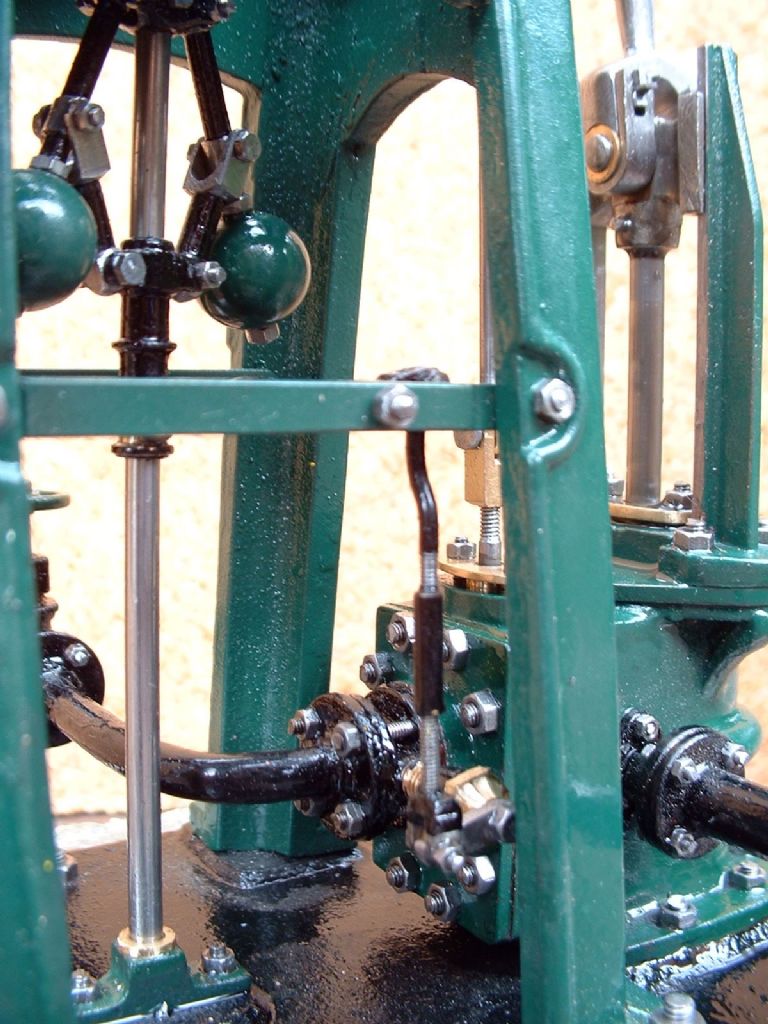

              What matters, IMHO is the force available to correct the governor position.
              This makes it all even more complex, as the displacement for any given error in speed will be much smaller, and that would suggest you really need a proportionately more sensitive mechanism. In particular 'stiction' in the valve is going to be a major obstacle for achieving the same degree of control as a full-size governor.
              I don't speak from complete ignorance of the practicalities, I built enough bits to make about three non-functional governors before succeeding with this working one, in 1/12 scale.
              I now in the other thread there were comments about the valve closing completely, I just settled for a loose fitting valve spindle so it just gives a significant throttling effect. That said I am not convinced it has any significant impact on engine speed.

                I did mention a slight speed increase in the other thread as Duncan has also suggested which could be done without being too obvious to the casual onlooker. If I remember rightly you already have the crank pullies made so that would leave you with just a decrease in the governor pully to gain some speed but that may then give you issues with the amount of wrap around and risk slipping belts or excessive tension in the belt. As the speed is squared this would be worth looking into.
                The other variable as I mentioned in the other thread is the springs both the flat springs that support the balls, making these thinner will allow the balls to throw out more. The same with the torsion spring and that can be reduced in dia and you may also be able to play with the levers that tension the spring.
                Your biggest sticktion area will be that gland that seals the spindle into the top of the block, too tight and it will make it hard for the spingle to move up and down, too loose and it will leak. Fred has been having problems here on his Fowler.
                It's a shame you did not mention your balls a couple of weeks ago as there was an engine running nicely on the belt driving a saw bench at Guildford I would have taken closer note of the set up.
                The next stationary engine I plan to make did originally have a pickering type governor so I may make one too, though most of the photos that I have of it don't show the governor – no doubt there is more money to be made by Prestons if they sell it separately.
                J
