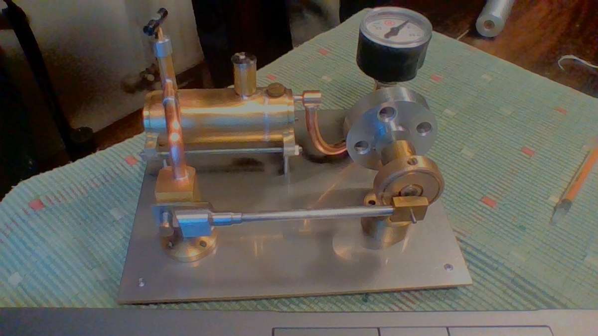

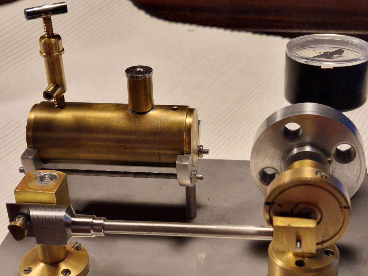

      Hi,
      today I finished model, pressure tested boiler with air, no leaks, so I tried to run it on steam. I heated boiler which produced maximum 0.7bar steam (boiler volume 34000 cubic mm; max filling volume 28200 cubic mm) which is quite a lot and cylinder (max volume 400 cubic mm) was trying really hard to run but couldnt turn flywheel around, I made oscilating cylinder engine, are maybe the holes not in perfectly aligned position, because piston only pushes when in maximum height position (intake only starts on highest position) or is the flywheel to heavy? Any ideas appreciated. Also added model image for reference, sorry for bad quality and my english.
      Martin
      WIN_20240221_01_06_32_Pro
      #715515
        It would be worth testing the engine on air first which takes the boiler out of the possible list of problems. Just remove the plug on the right and feed air in through that hole. See what pressure it needs to run.
        It is not easy to see on your engine where the cylinder ends and the piston starts, are you running the rod straight into the cylinder and using that as the piston?
        The engine will not self start you need to flick it round to get it started.

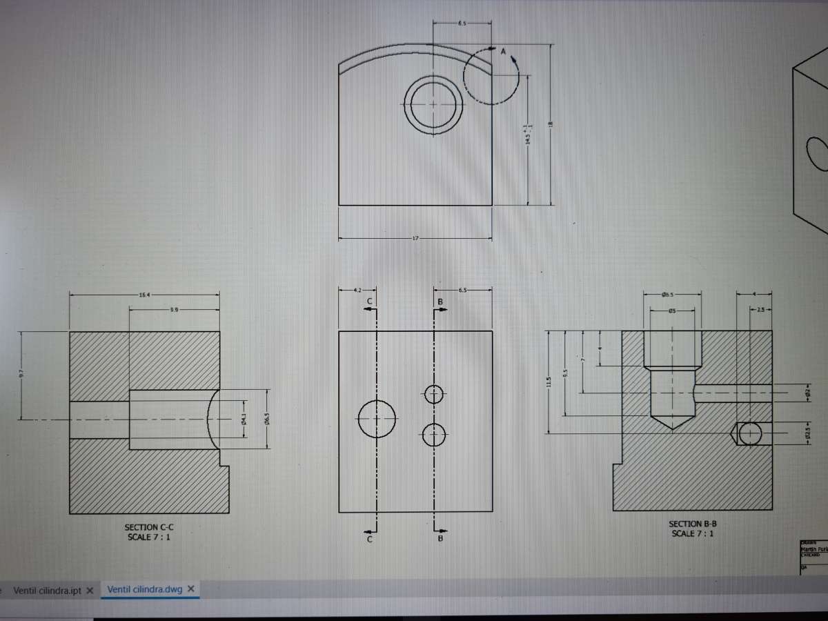

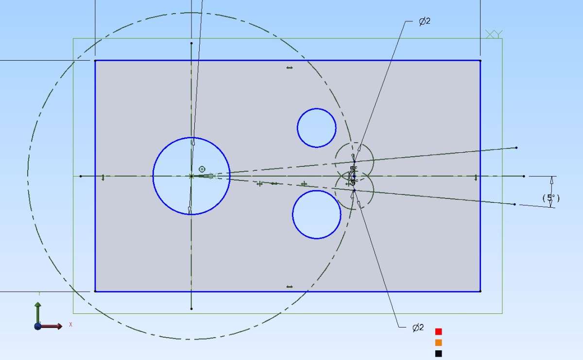

          Can you post a sketch of the port block with size and position of the holes relative to the pivot and also what size hole is in the cylinder
          #715567
          Dark Knight
            @darkknight31337

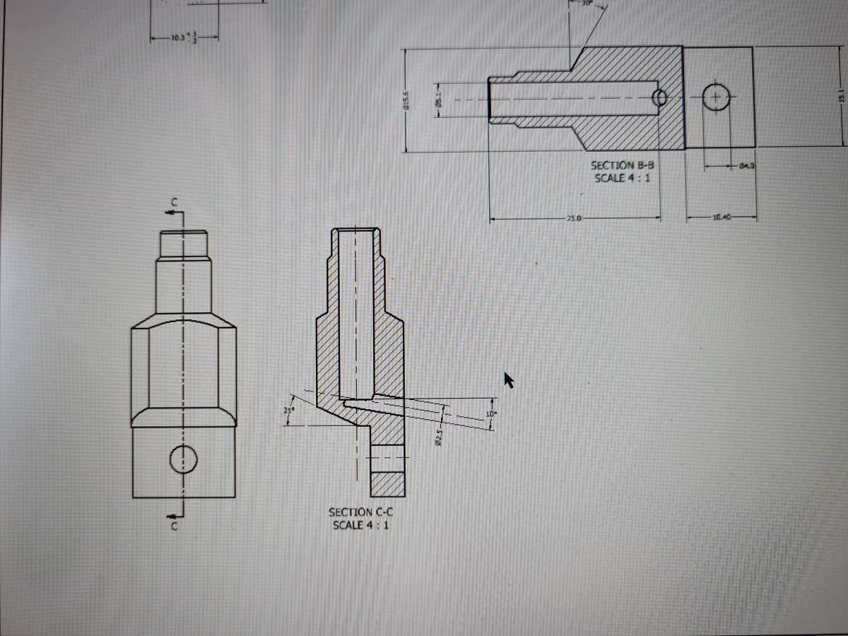

            Here this are my cad drawings, I hope this help, I suspect that the holes alignment is bad. Maximum cylinder angle off center line on valve block is 5 degrees

                  What is the distance from pivot to hole? and is it the same on both parts
                  distance2
                  Your main problem looks to be that the two holes are not equally spaced above and below the pivot height but need that dimension to plot it out.

                    Scaling off your drawings (yea, yea, I know, but in the absence of dimensions …..!!) it looks suspiciously as if the arc of the port in the cylinder coincides poorly with the ‘arc’ of the ports on the block-face.
                    (Plus that piston-face surface-area is very small and will not help.)

                      By my estimates the two holes, inlet and exhaust, are too far apart for a single hole to act as both inlet and exhaust on the cylinder. The crank looks to be about 18mm between TDC and BDC and from the drawing looks like 4.5mm between the holes. That means the ratio of the holes to the distance between the pivot and flywheel centre should be about 4:1 and it looks more like 10:1
                      Change the exhaust on the block into a slightly larger hole and you may get it working but it needs proper analysis in the CAD model.

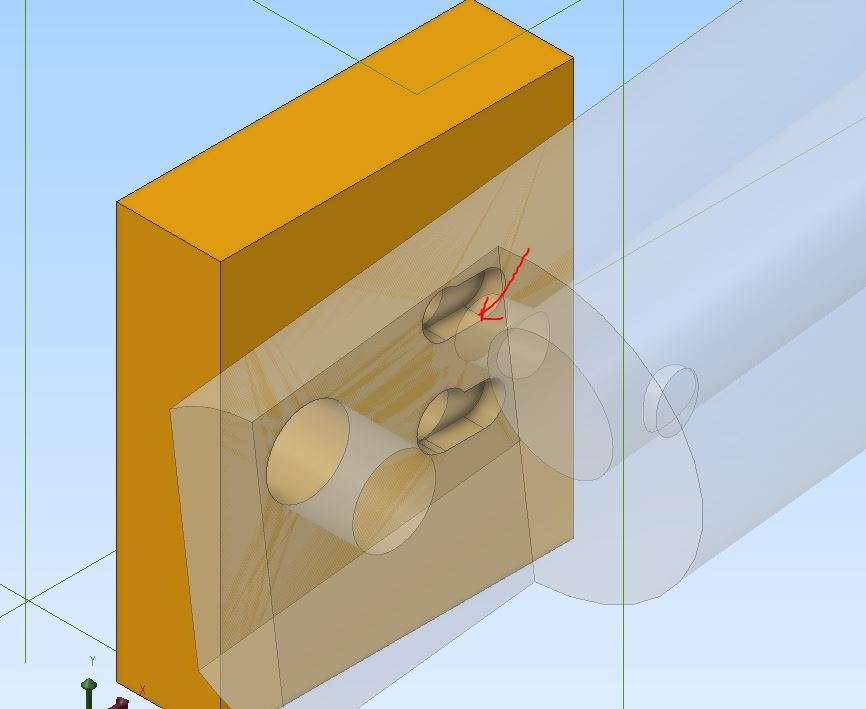

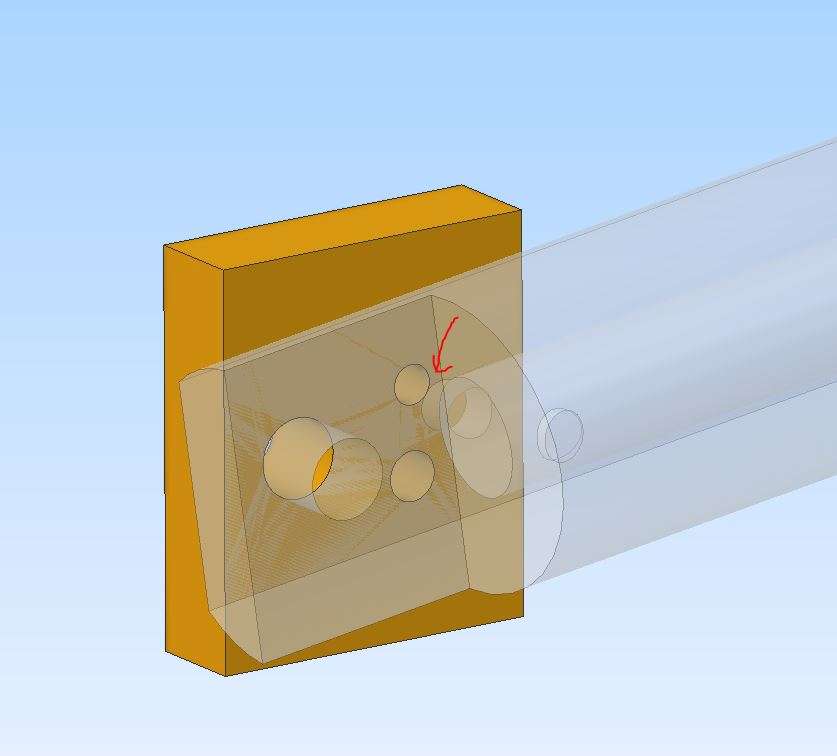

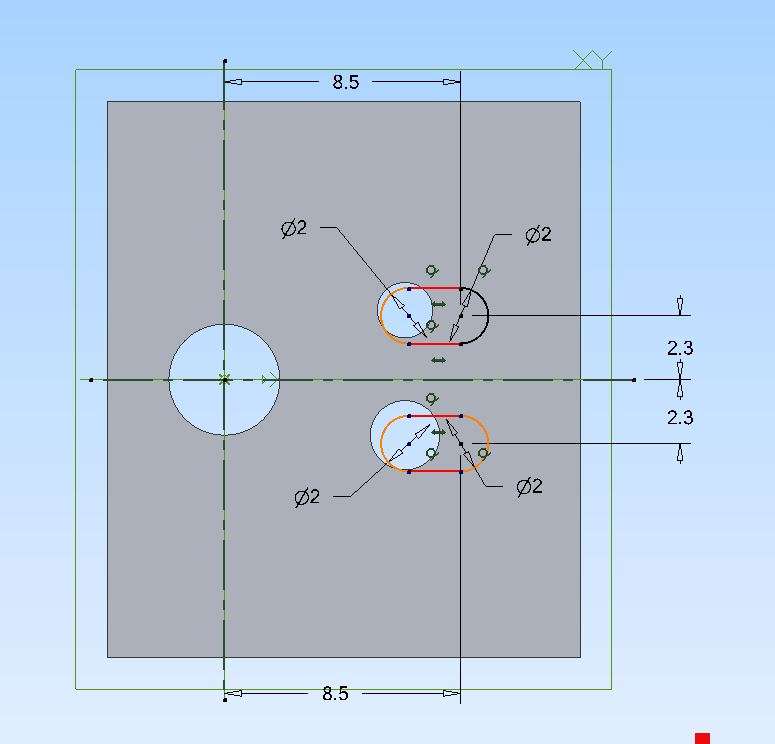

                        I scale the cylinder hole as 8.5mm from pivot and the block holes 6.5mm from pivot. Plotting those to the 5degree movement stated then it’s never going to see any steam into the cylinder. Green dotted circles are the cylinder ports at their max movement
                        ports3

                          Hole of cylinder is 2.5, also did you make hole on cylinder a little bit further back then 25mm because its at angle of 10 degrees (around 2mm). Maybe my drawing measures are little off than actual ones on model. I will remeasure… I tried to run it again now boiler got to 0.4bar and i figured why it ran before on 0.7bar, my valve had small ball bearing for ensuring tight seal on regulation valve, that ball bearing got stuck in hole in valve. I had to fix it today and remove ball-bearing. Now I soldered it on threaded rod of valve (image). Today I tested it again on air and it starts running on around 0.4-0.5bar. In this boiler I can achieve steam pressure of about 0.4bar, so conclusion is that boiler is a little bit to small. Should I make brass insert in cylinder, that it will require less steam, or should I make another smaller boiler and connect it with original boiler, that way I can produce higher pressure steam?20240221_210324

                              Distance between center of holes is 4.5mm if you still need.

                                My drawing are way off, im almost certain now XD ;(

                                    Yes I did allow for the angle of the cylinder hole but have now enlarged it to 2.5mm.
                                    I think the best thing is to forget about steam for now and just get it to run on air, once you know it runs then try it on steam.

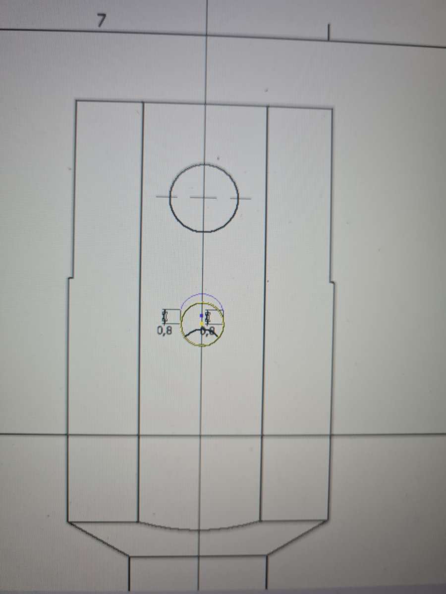

                                    I’ve drawn it out again and as far as I can teel the cylinder hole is further away from the pivot than the holes in the port face so does not connect.
                                    ports 5
                                    rather than making complete new parts it would be possible if you have a milling machine to cut two 1mm deep slot 2mm wide which will extend the holes too where they are able to connect with the cylinder.
                                    ports 6
                                    It is not ideal but worth a try before remaking other parts.
                                    ports 7

                                        20240222_130125Currently I don’t have a milling machine. I could enlarge hole of cylinder along Z axis with drill bit, if that doesnt work i will have to dump valve block completely.

                                          Ok I fixed it today by enlarging hole on face of cylinder, here is a link to compressed air test run:

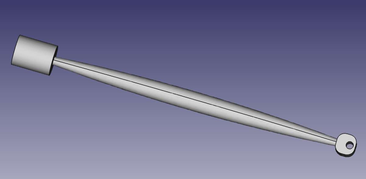

                                            The conrod is very heavy.  Try reducing the weight, perhaps:
                                            conrod

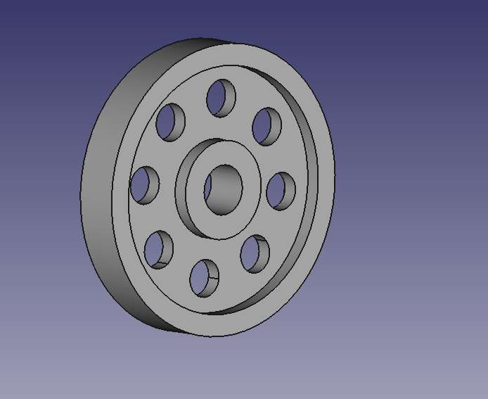

                                            The flywheel diameter looks too small to me, and it is too solid.  A flywheel’s weight should be concentrated at the rim, done by removing metal in the middle, like:
                                            flywheel

                                                    Thanks for advice, I will fix flywheel and I will see what can I do about conrod.
