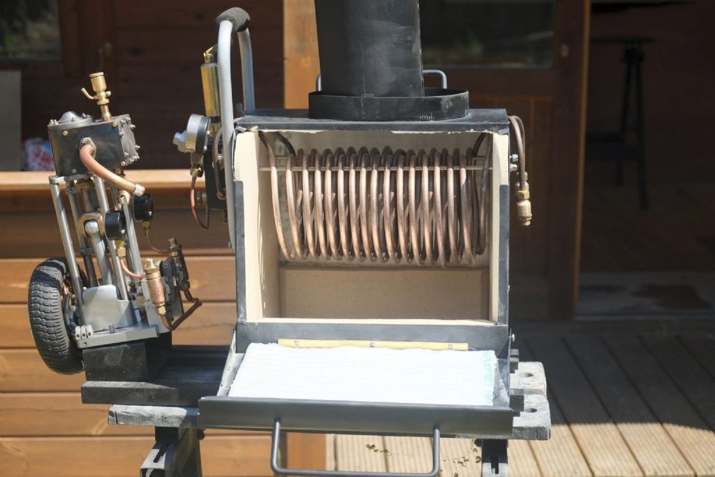

                                    #616155
                                    Peter Cuthbert 1
                                      @petercuthbert1
                                      Hi Model Engineering Friends
                                      I thought it was time to provide a brief update on this project. Much has come in the way of it including Solar PV with battery, much fighting with our electricity retailer, much work on the improvement of the rear garden, particularly in relation to Builder Shame dating from since the time the house was built rigt up to thelast time we had builders on site, adding the mezzanine floor to the garage, and trying to find door and window suppliers capable of installing kit that is pushing the latest building regs. On the hobby side I have worked with long time steam canoe and mono-tube boiler enthusiast John Emmett on a couple of articles on mono-tubes for the SBA's Funnel magazine. With those done it seemed a good idea to create a website to bring together all kinds of mono-tube steam generator information/views from anybody who is willing to contribute. Having used Concrete CMS before I volunteered to do the basic set up work, but found I had got the latest version (v9) which is quite different to the version with which I was familiar. Steep learning curve time. Anyway the framework and some material is there now and contributions will be welcome: https://www.mono-tube.org.uk
                                      Having worked with John I am now of a mind to copy his mono-tube steam plant in Snipe but using the existing Cygnet. As work on that starts I will keep you posted. A picture below:
                                      Best wishes
                                      Pete
