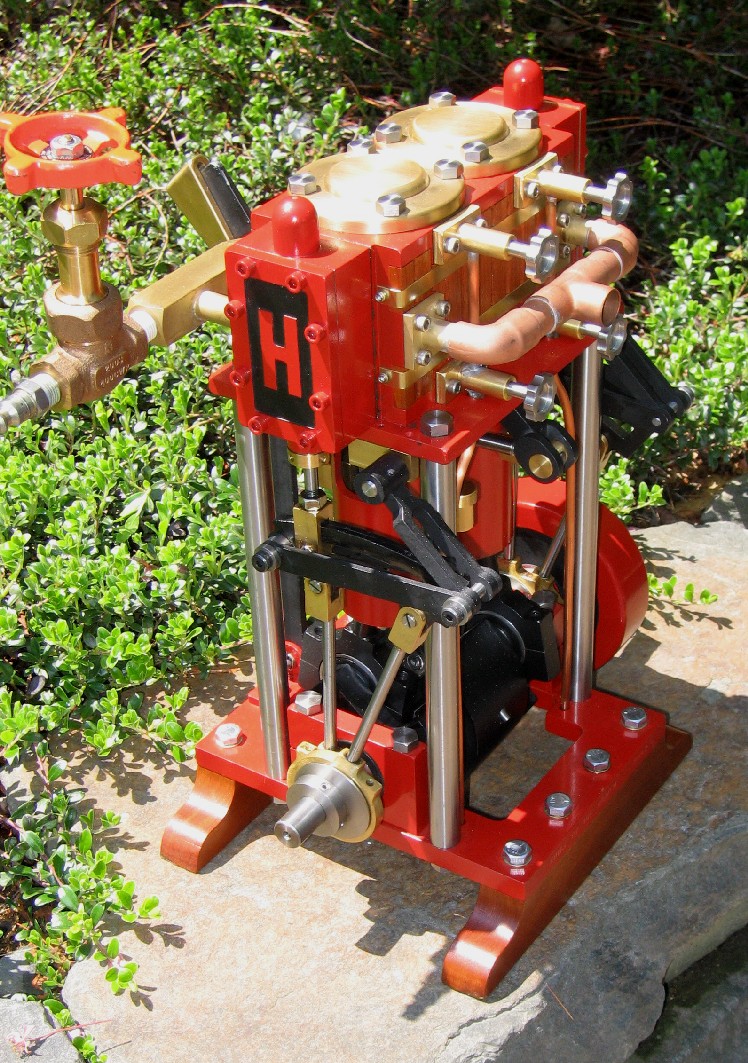

                Niels Abildgaard
                  @nielsabildgaard33719
                  Posted by SillyOldDuffer on 30/05/2021 10:24:33:
                  1. The 5 kn requirement is quite tough because the power needed to overcome resistance is proportional to speed squared. Travelling at 2kn needs a lot less power, and 10kn would need a much bigger motor.
                  Power demand grows with speed cubed for water friction and much worse for wave resistance close to decent hull speed (no planing).
                  Thats why the canal experiment is more important than designing steam plants first.
                  A mr Hiraoka has designed a casting- free engine for Heisler locomotives that can be a very smooth running V compound engine for a canoe
                  Canoue Compound
                  Edited By Niels Abildgaard on 30/05/2021 18:02:51

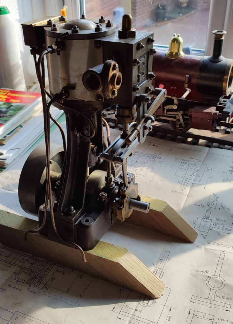

                                                Peter Cuthbert 1
                                                  @petercuthbert1
                                                  Hi Model Engineering Friends
                                                  I had not expected to activate this thread again, but life throws all sorts of things at one. In my case I have managed to purchase a Stuart Turner Cygnet, the engine that seemed to be the favourite for this application. However, it was bought sight unseen so I am somewhat disappointed. The disappointment is that it has not come with the pumps that Stuarts presumably included in the package. Thus my main reason for posting is to ask if there might be a) anybody sitting on the pumps bit of the Cygnet package that they might wish to dispose of in my direction or b) anybody who has had a successful design of pumps (minimum is a feed pump, air pump is a luxury) that would fit.
                                                  Cygnet
                                                  The engine was built in about 1996 and has only been steam tested and never run for any length of time. That does seem to be corroborated by the amount of compression when turned over by hand. The parts all look to be very well made but I think the maker was a Utilitarian. The engine is in no way set up as Steam Boat Porn. For me it will need to be stripped and painted, the brass polished and a wooden jacket applied to the cylinder as the very minimum.
                                                  It seems that the original owner arranged for its manufacture only to find it was too small for his boat. He kept it, as we all do, as something that might come in useful later. Now at 88 he has decided that it had to go. Of course in the negotiations I failed to ask if the pumps were still with it. There is the possibility that it never had the pumps. I notice that the Cygnet castings currently for sale on the Steam Boat Association Small Ads site does not include the reversing gear. I notice also that the ST present site has such things as reversing gear as 'options' which makes it very possible that the kit was bought without the pumps. It is a Cygnet as it has the solid flywheel and the smaller base casting.
                                                  Regards, Pete
                                                  #591623
                                                    They sold the Swan and Cygnet in both Non condensing and condensing versions, you got the basic engine in the non condensing kit or the pumps etc in the condensing kit so looks like yours was the basic one. Both came with reversing gear.
                                                    You might also try the Stuart Models FB group to see if anyone has the pump drawings or even contact Stuarts, I should think they could be fabricate das castings are unlikely to be available.
                                                    I have a feeling John Bertinat did a revised pump design, probably in an old ME if he did
                                                    Edited By JasonB on 26/03/2022 07:49:09
