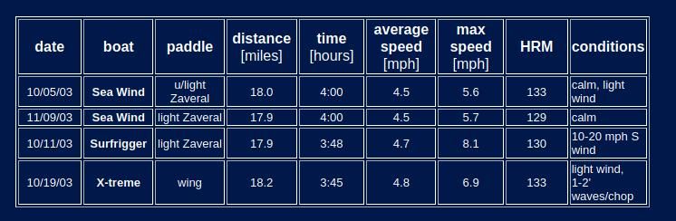

                                                Not trying to change your mind Pete! However, the reasons for rejecting steam-electric are a little suspect:
                                                1. As small steam engines are grossly inefficient compared with electric, it's odd to reject electric because it's allegedly inefficient. Efficiency isn't a good primary design target. Better to meet the basic requirements first, and improve efficiency later.  Effectiveness first, efficiency second.
                                                2. The calculation assumes the steam engine has to provide full power to the propeller. Not what I meant. I suggest the steam engine's purpose is to look good whilst supplementing the battery. Steam is a range extender, not the prime mover. Back to the question of duration. How much energy is needed to pull a canoe of resistance x at v knots for h hours? How much steam must the boiler produce to maintain that, and how much coal must be carried? If duration is 5 minutes, the boiler is a doddle, if 2 hours, the boiler is a big problem.
                                                3. If Trolling Motor propellers are inefficient, why should any other type be better? I suggest losses will be even worse if steam and propeller diameter, pitch and RPM aren't matched and the propeller doesn't have room to bite. I see Trolling motors avoid bite problems by sinking the propeller at least 0.6m below the water line. For a shallow calm-water craft, like a canoe, it may be more efficient to fit paddle wheels.
                                                4. The 5 kn requirement is quite tough because the power needed to overcome resistance is proportional to speed squared. Travelling at 2kn needs a lot less power, and 10kn would need a much bigger motor.
                                                5. No one said the motor had to be 12v but even assuming 60A is required, why is that scary?
                                                Thinking of paddles, how fast can a canoe be cruised by a human? This chap measured himself over 18 miles, taking about 4 hours. Assuming he's fit, he probably sustained about 250W output. He averaged 4.5mph (3.9kn), which suggests a Stuart should be adequate power wise, and the limitation will be the boiler.
                                                In comparison, a 12V 100Ahr battery could deliver 250W (21A) for about the same time, 4 hours-ish.
                                                It's a very interesting project, however you choose to tackle it, more power to your elbow! Please keep us informed.
