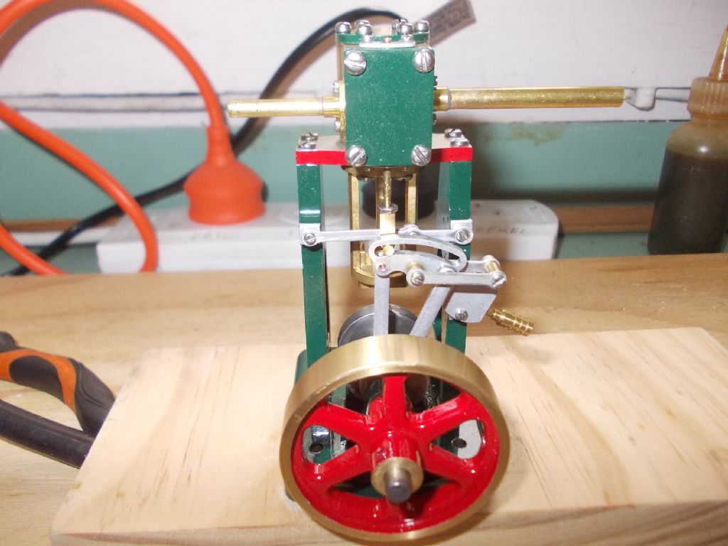

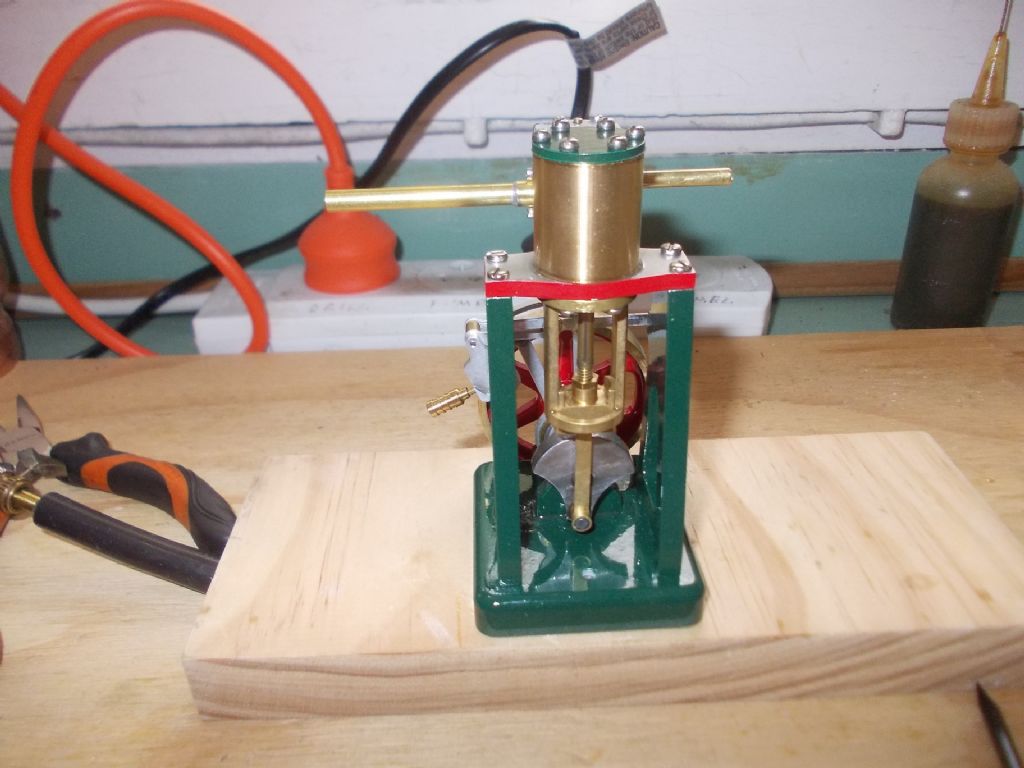

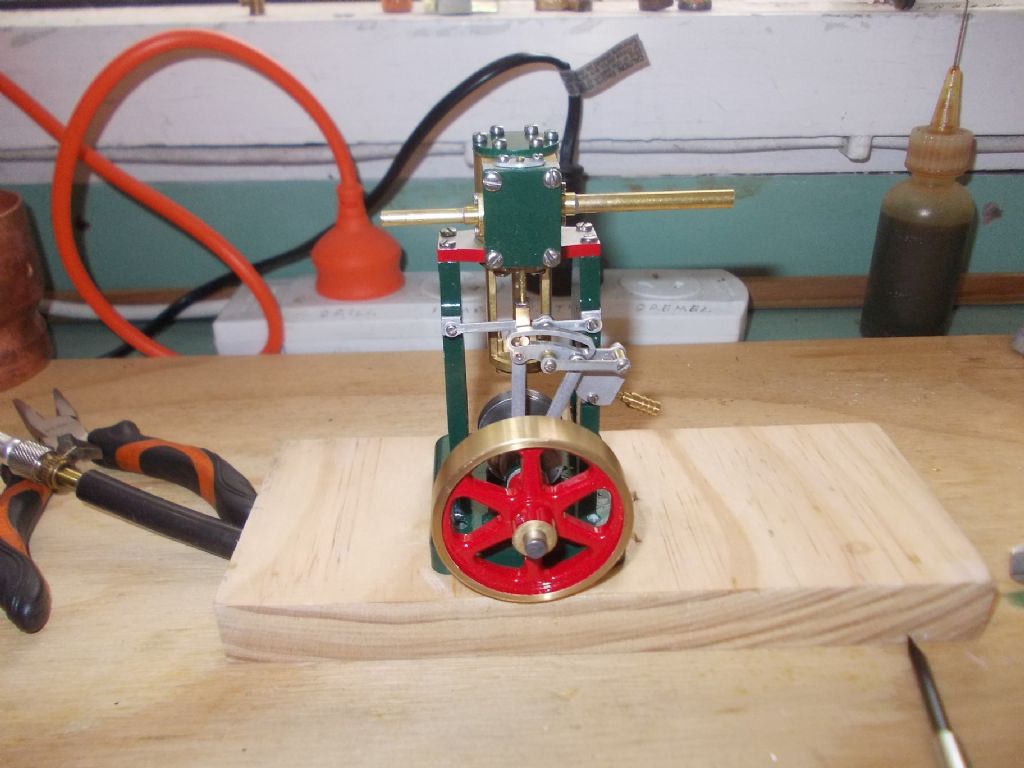

      I have just finished painting and building the VR1A stationary steam engine with reversing link from Graham Industries in the US. It is a fully machined kit and quite cheap. It is not a ''shake the box'' kit but the instructions are very good with lots of helpful photos in the supplied book. I only had one problem with a 2-56 threaded hole which would not accept the screw. Fortunately I had a 2-56 tap on hand to clear things up. (I don't even remember buying that !)  I will post a video of the engine running later. I intend to match it with a suitable size boiler and construct a steam plant but it has to be run in on air for at least one hour. It does run very nicely right from the start.

        Graham Industries VR1A

          Well done Brian. But if I might make a comment. Change all the round head screws for studs and nuts and it will look a lot better ( It won't run any better though ) smiley

            I know but this kit came from the US so all the threads are imperial. I have a good range of metric socket heads but nothing at all in imperial. I was a bit surprised that the kit came with slotted head screws.
            NOTE : the imperial fasteners are quite expensive compared to the metric version. I have been looking on ebay.

              Graham industries does sell a set of hex head bolts for these engines – even comes with the appropriate sized box spanner. Linky

                Nice job, looks like it's about the height of a "coke can", would that be right?

                  Geoff : the height of the VR1A is 100mm.
