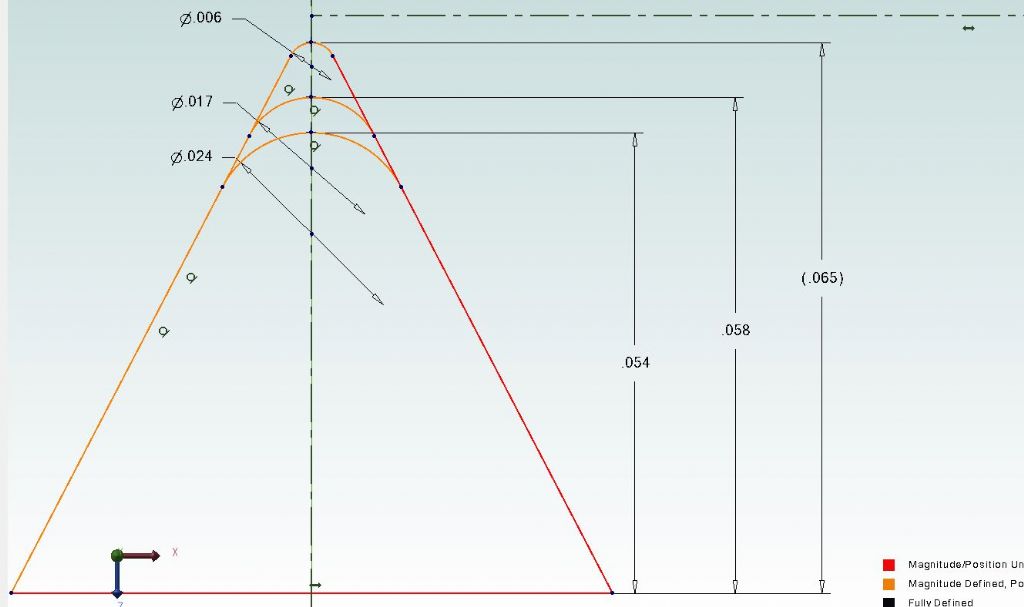

          I can see (thank you Jason for the drawings) how different profile inserts make a difference to thread depth. What I cant understand is 1. Why manufacturers don't publish some type of chart or equation for applying to thread cutting. 2. How anyone copes with the trial and error method I used. Making a bolt is not a 5 minute job. 3.Why a full form/profile cutter would need to take any material off the top of the crest. A 1/2" bolt had an OD of 0.500". A 1/4" bolt has an OD of 0.250" etc. Surely it is what it is. Why would we need to make that OD less?

            It does not reduce the OD. If you look at that first image I posted of the Whit thread form you should be able to see the crests of the threads are rounded not pointed but the top of those crests measure 1/2"
            This rounding of crests that the full form inserts give is a good indication that you have fed in the correct distance, if there is a flat you have not gone in enough if you keep feeding after the inserts starts reducing the OD you have fed in too far
            As for a get around you just need to measure with thread wires and note the infeed for a given tpi then next time you come to cut that same tpi you will know how deep to go. Or do the calculation, sketch in CAD etc as posted earlier

                    As I said easy enough to work out how much more infeed is likely to be needed for partial form inserts that will get you quite close.
                    A quick look at an insert manufacturers catalogue gives the tip radii of full and partial forms.
                    A full form 12tpi whit insert has a 0.012" radius (0.024dia) and stated infeed of 0.054"
                    A G55 partial insert which covers 14-8tpi has a 0.0085" radius ( 0.017" dia) but no infeed given but from the above you can see it would need an infeed of 0.058" to get a similar flank measurement
                    An AG55 Partial insert has a tip radius of 0.003" (.006dia) again no infeed but from image needs an infeed of 0.065"
                    So depending on which partial form insert you have feed in to those numbers, thread may still seem a bit tight so a file running along the crests may be all that is needed to get it to fit. Flex in the machine, spring passes etc will all affect final fit so can't always just go by numbers
                    Edited By JasonB on 03/08/2023 08:59:16
