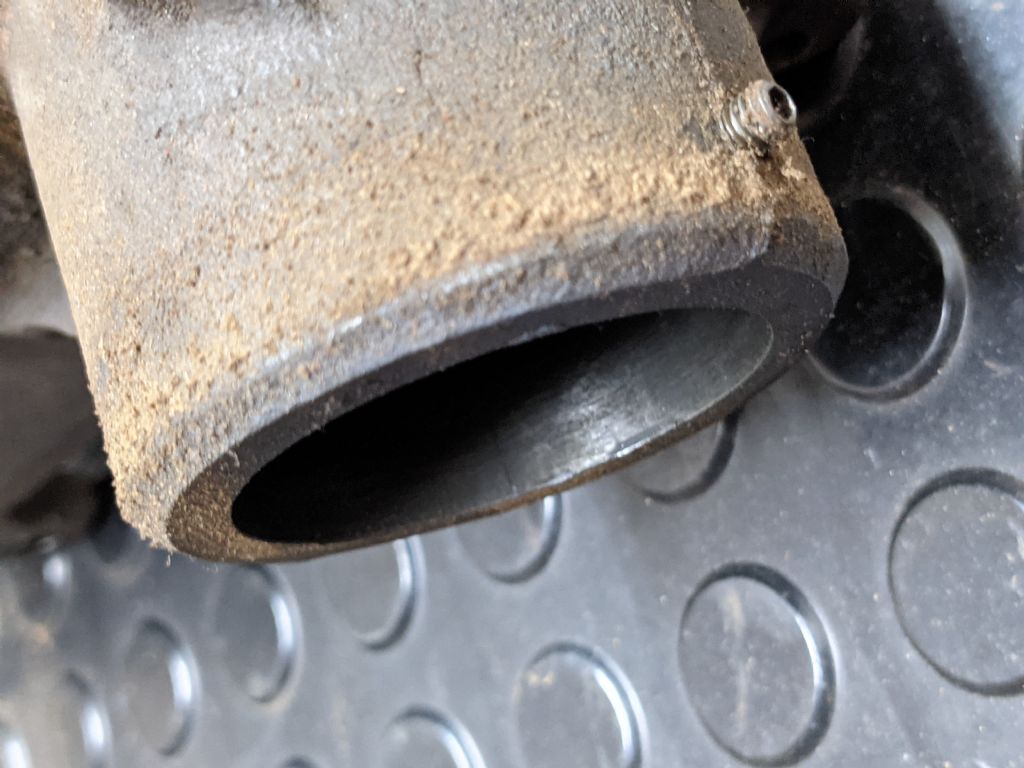

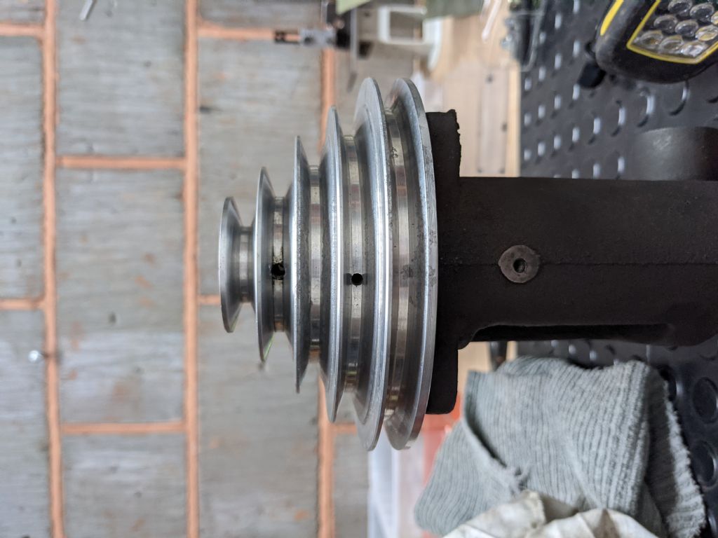

      Yesterday I was cleaning the cast iron body, the only parts left on the body are the whole Spindle Bush Pulley Assembley, quill removed. While cleaning I noticed the following:
      Bearings run tight, a flick of a finge gives less than 1 rotation. I would expect many rotations for a light bush/pulley in ball bearings. No noise or noticable sideway or up/down play in the bearings. When scrubbing the pulley from above there was a small clunk sound and i moved downwards about 1 mm. The sound was from the inner pulley hitting the top of the base. From below it was possible to see the outer race of the lower ball bearring move up/down in the houseing. When turning the pulley the outer race could also turn, but so could the inner race ie not stuck.
      Checked the manual (http://www.altsawsandspares.co.uk/spares.html) and did the following:
      Tigthend the grub screw through a hole in the pulley (second gear from below – see photo). This stopped the whole assembly moving up/down and the outer race of the lower bearing rotating. Loosening increased the up/down movement to ~5 mm, but it did not free the whole assembly for lifting up and out of the housing.
      Removed the 2 grub and 2 set screws for the pulley and applied light tapping and light force with a puller, heat – not moving.

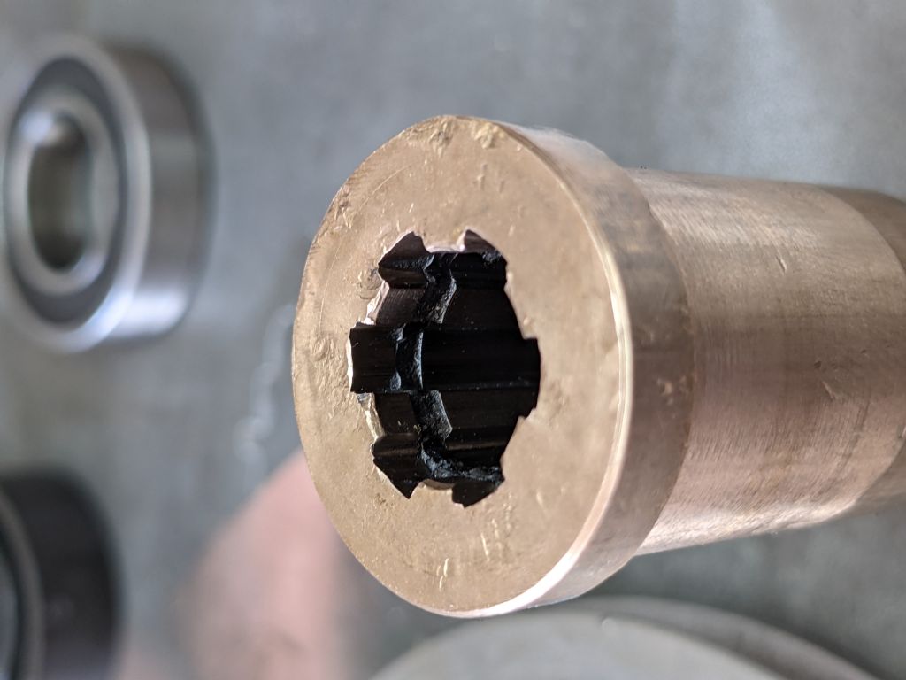

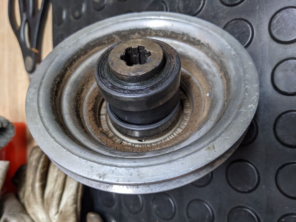

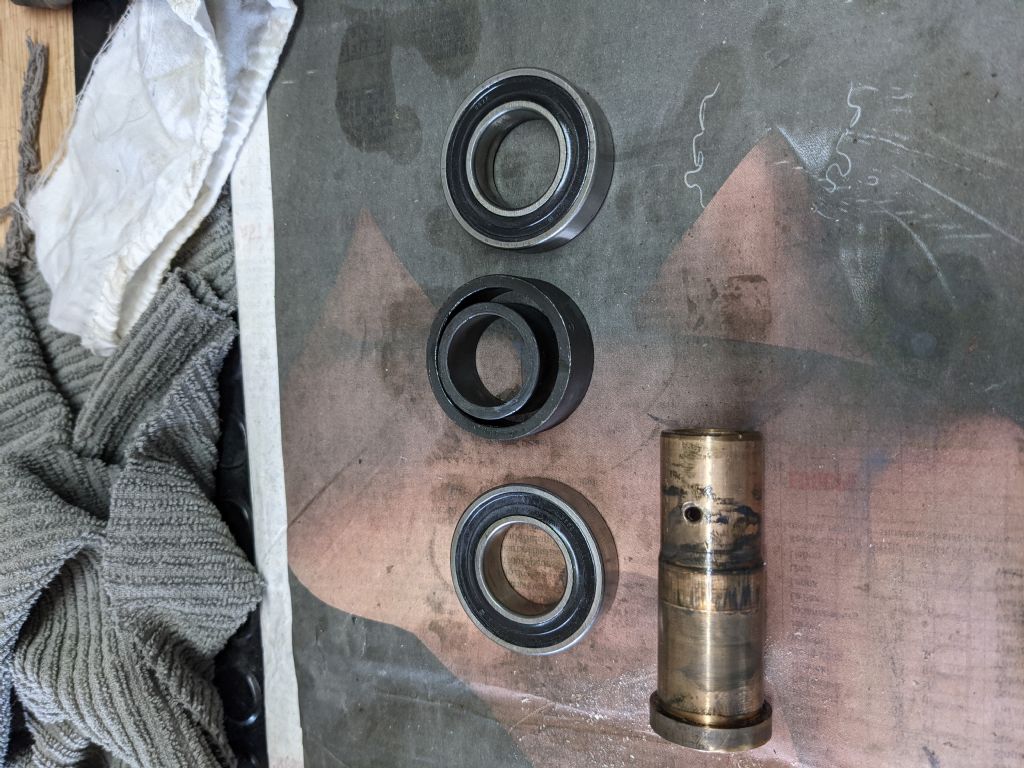

              Got the pulley off with a couple of heat treatments, penetrating oil and gentle tapping with a wooden dowel while hot.
              So there is an inner spacer quite tight. The leftovers of the o-ring is in an inside groove on the spindle bush.
              Pulled the bearings and spacers off in one go. Bearinngs are metric 47/25/12 mm and the pulley bore 5/8''
              As can be seen from the pictures everything goes on from above to the seat on the spindle bush..
