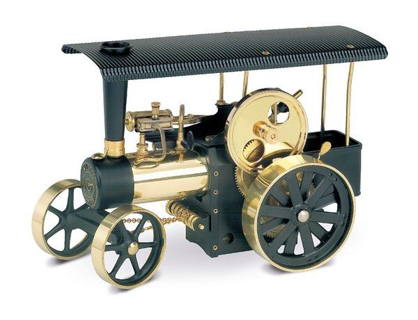

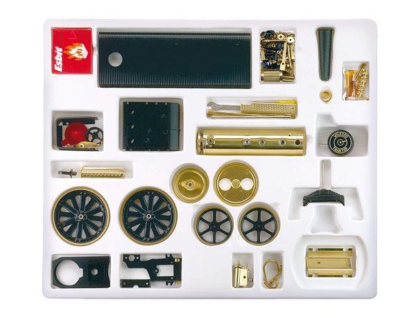

        An 11 year old, wanting to build a steam loco is very commendable and should be encouraged but as stated already they can be very expensive, requireing a workshop with power tools. Lathes and milling machines are dangerous tools and someone with little or no experience could easily hurt themselves.
        Many clubs will take a youngster under their wing and teach and supervise young members.
        Wonderland Models sell a Wilesco model steam traction engine in kit form. **LINK**
        #527414
          That Wilesco looks a pretty realistic starting point, Paul yes
          Educational, and useable in itself.
          Not bad, at £1 a day for a year
