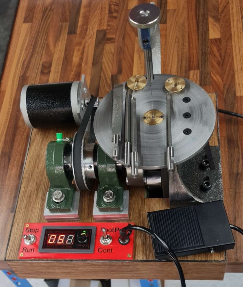

                      Peter Cook 6
                        @petercook6
                        Just to close things and as a final thanks to those who helped boost my confidence. The filing machine is now finally finished – and it works!! This is it set up with a Jewellers 3/0 blade in the saw bow, and some 4″ files in holders on the table.
                        Filing Machine
                        To face things I used a 10mm HSS end mill with 9mm step over and had no trouble machining the castings, and managed, without too many operator errors, to get all the holes in the right places although I was surprised at how much material I had to remove in places to get to finished dimensions. The bow was no real problem, but turning the table on my little Taig (using riser blocks) was a bit close to the limit  hence the slightly dodgy finish!
                        It still needs a belt guard and (perhaps) painting but works well for both sawing and filing.
                        For anyone doing the same thing I finally used a 24v 100w 3000rpm motor geared down 6:1 which gives me speeds from about 70spm to 450 SPM although without the weight of a Myford to hold it still the vibration at the top end is a bit startling.
                        The only thing that concerned me was the possibility that the lower saw blade adapter could drop down/out if the saw blade broke, and would come into fairly violent contact with the top of the conrod, so I added a grub screw to the bottom block of the bow, and flats on the saw blade adapters – also helps to stop blade rotation when tensioning.
