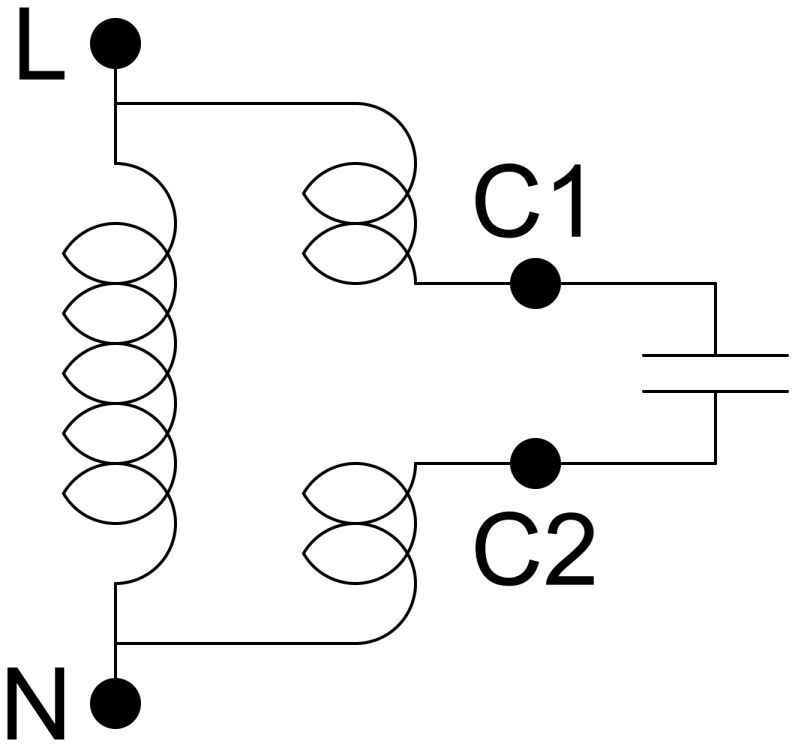

                              #658215
                              Macolm
                                @macolm
                                Just to be clear, I suggest checking the winding resistances to be quite clear about the circuit of the windings.
                                For example, this circuit is a possibility. Connecting the capacitor from C2 to N would produce symptoms similar to those reported.
                                Edited By Macolm on 27/08/2023 15:25:29
                                #658221
                                Macolm
                                  @macolm
                                  Correction – C1 to N
